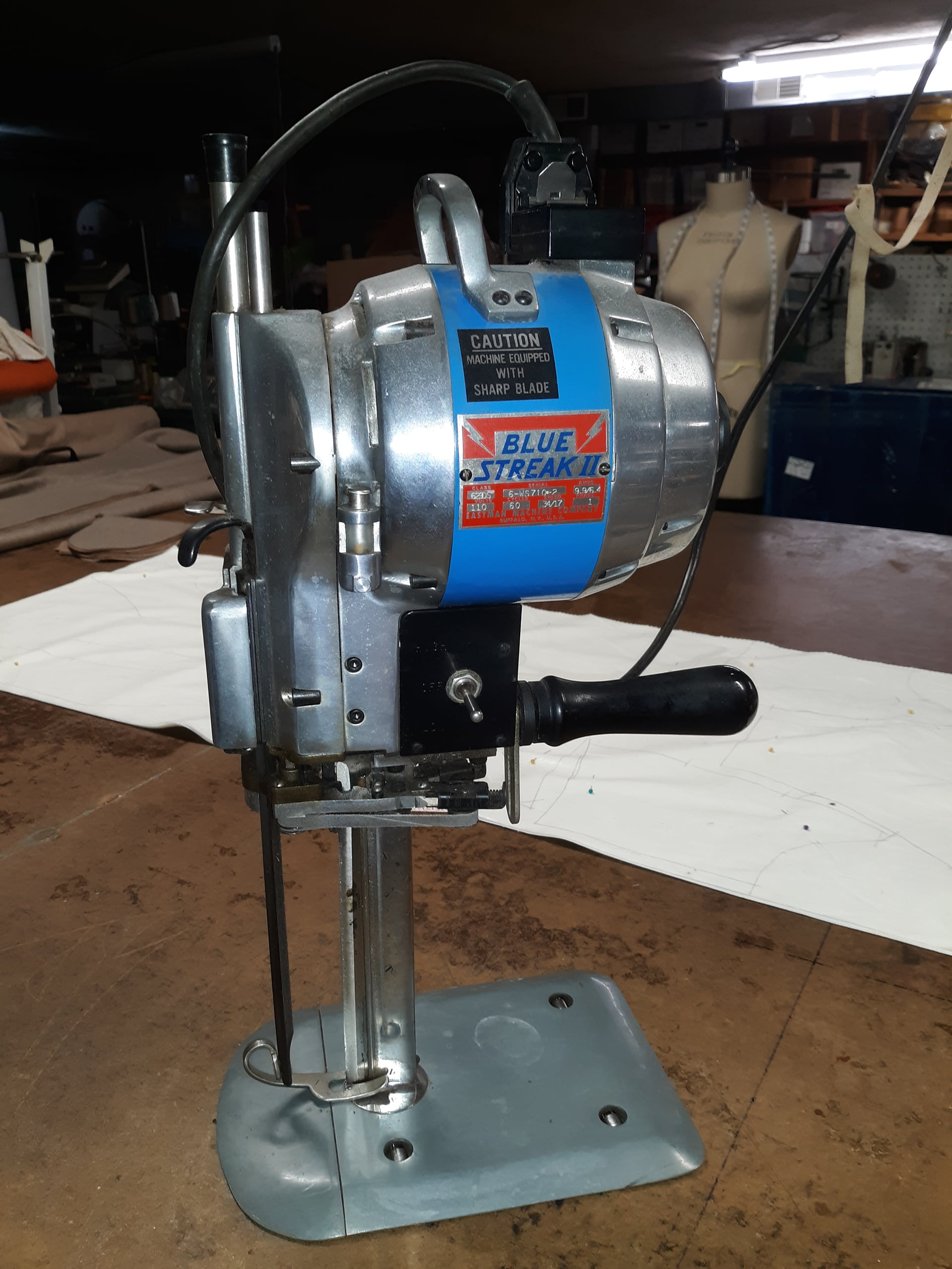

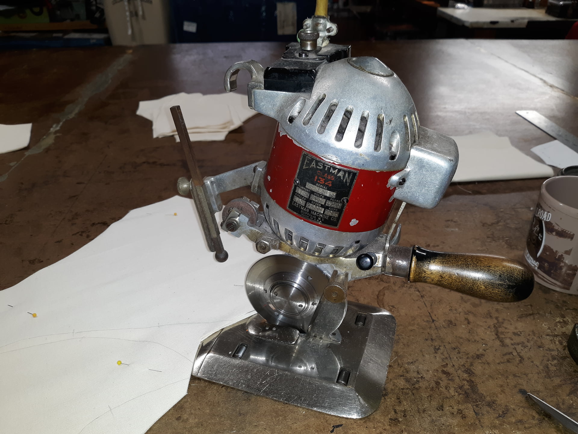

I’m probably not the best one to answer that question, because I mainly cut using Eastman industrial cutters… either a round knife or straight blade, but I used both shears (mainly Fiskars although I had a pair of Ginger) AND Olfa rotary cutters. I would use the rotary cutter mainly for accuracy cuts like pocket flaps, welts, etc. I also used either the rotary cutter or a utility knife to cut paper patterns. Again the rotary is more accurate than scissors / shears. Cutting with a straight edge is better than trying to cut a straight line with scissors / shears. And yes… I had all those various clear plastic “quilters” cutting guides as well as every size of cutting mats. :slight_smile:

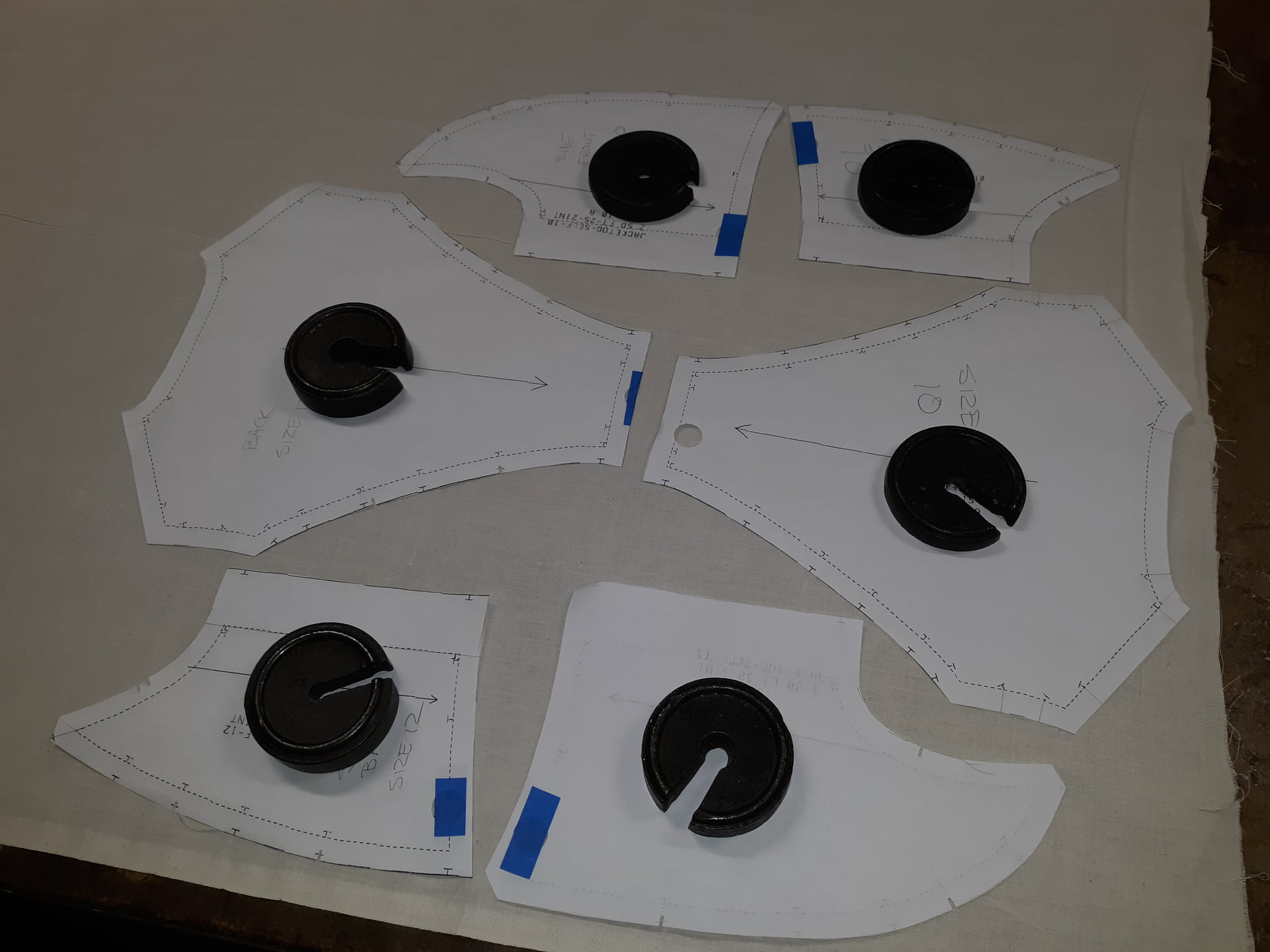

Well… for 40+ years I mainly used “wax” tailors chalk and tailors pencils - usually yellow and white. I really only used orange tailors “chalk” when I needed the visibility. I prefered wax chalk as it doesn’t just brush off or disappear from vibration from the Eastman cutters. For the most part I would layout the pattern pieces, and use weights (I aquired some weights from an old knitting machine) to hold the pieces down, and I’d mark around them, as well as any notches or location dots.

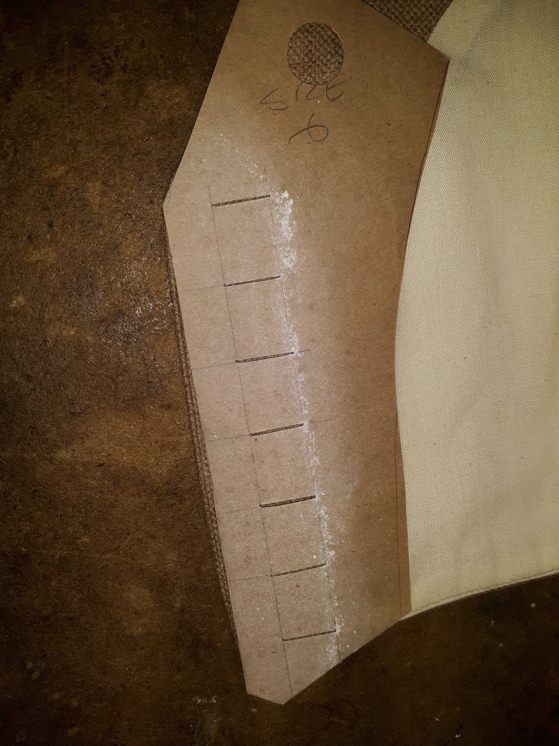

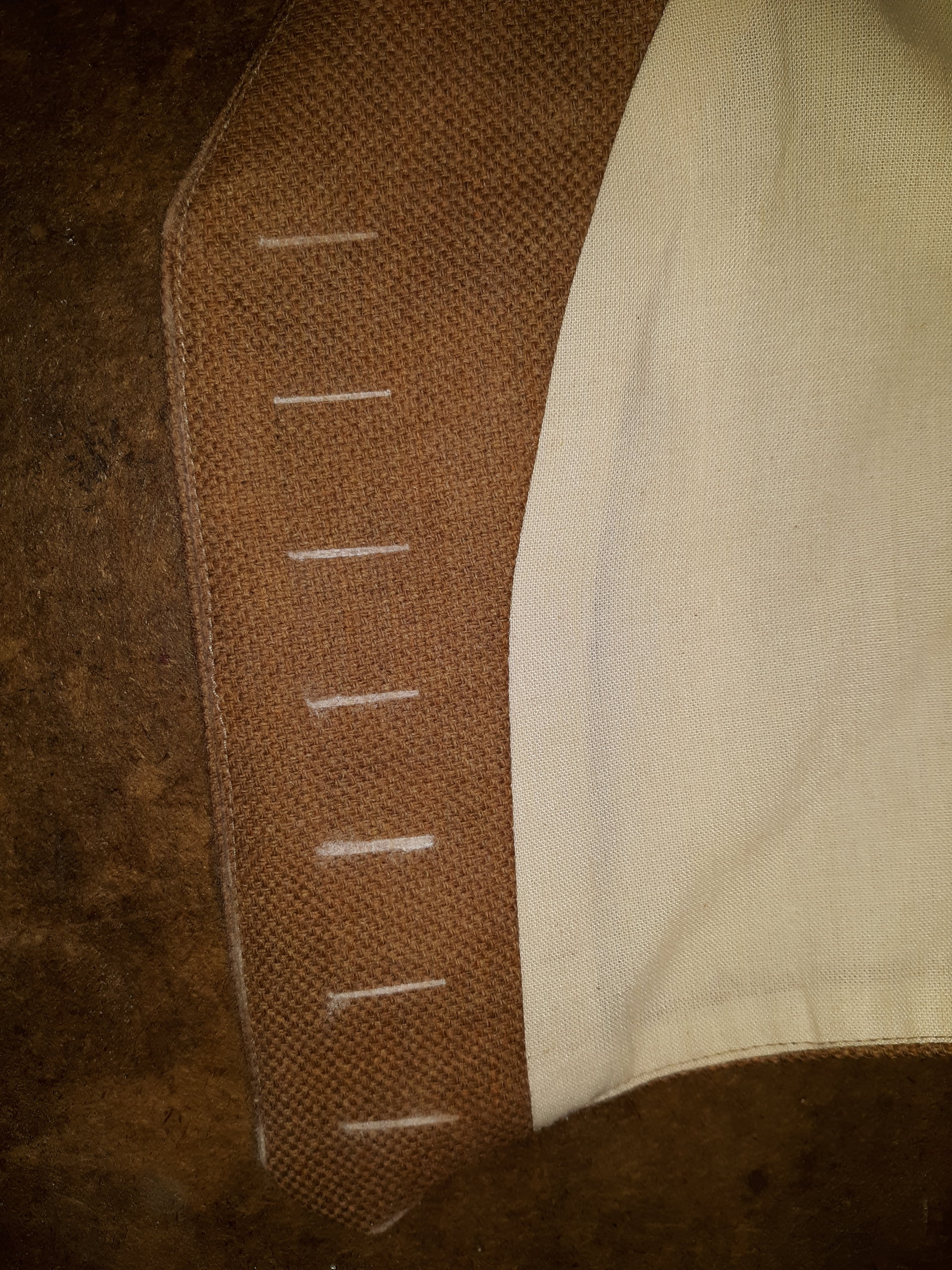

And just to throw it out there, because I would do a lot of marking on pattern pieces using a pounce pattern and pouncing powder (either blue or white UV glow). For ex: When we did the costumes for Cabrini, to mark all the button hole placement on the jackets I used a pounce pattern. Pouncing buttonholes is 1) Quicker than marking each buttonhole. 2) Doesn’t mess up the buttonhole thread with wax as with the powder just disappears. 3) Quicker than tracing with wax paper.

An Eastman 4 1/2 rotary cuttter: `
Eastman straight blade cutter:

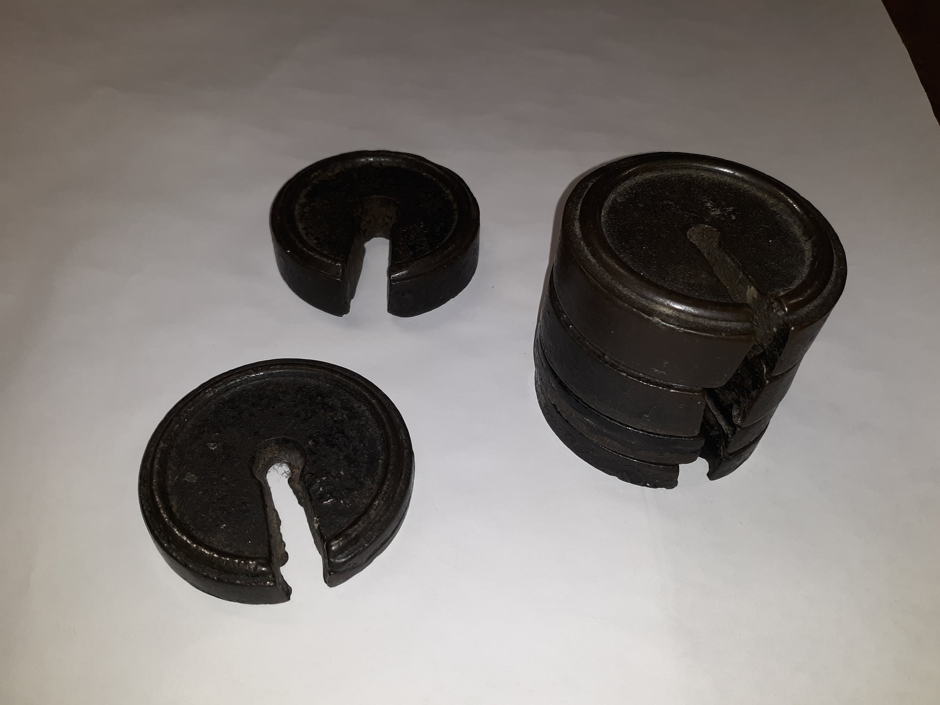

Knitting weights: The weight are pretty heavy… I only dropped one once on my toes.
Pouncing button holes: I would just use a makeup powder puff to wipe the powder over the pattern.

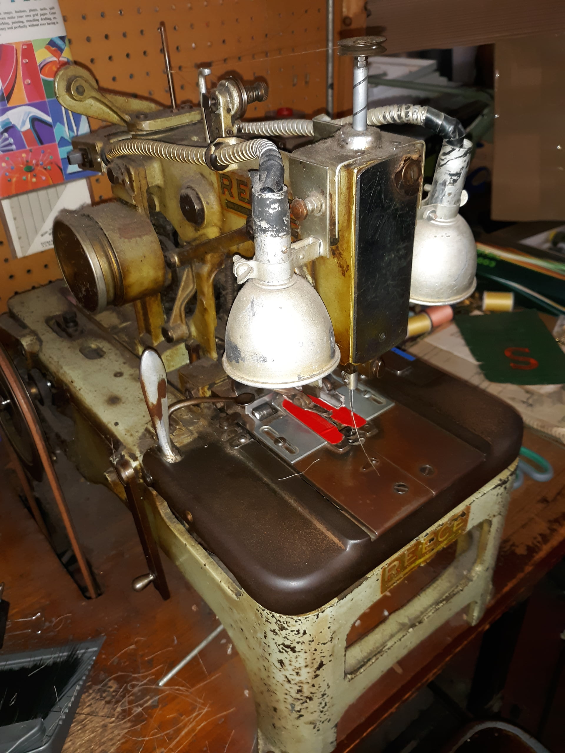

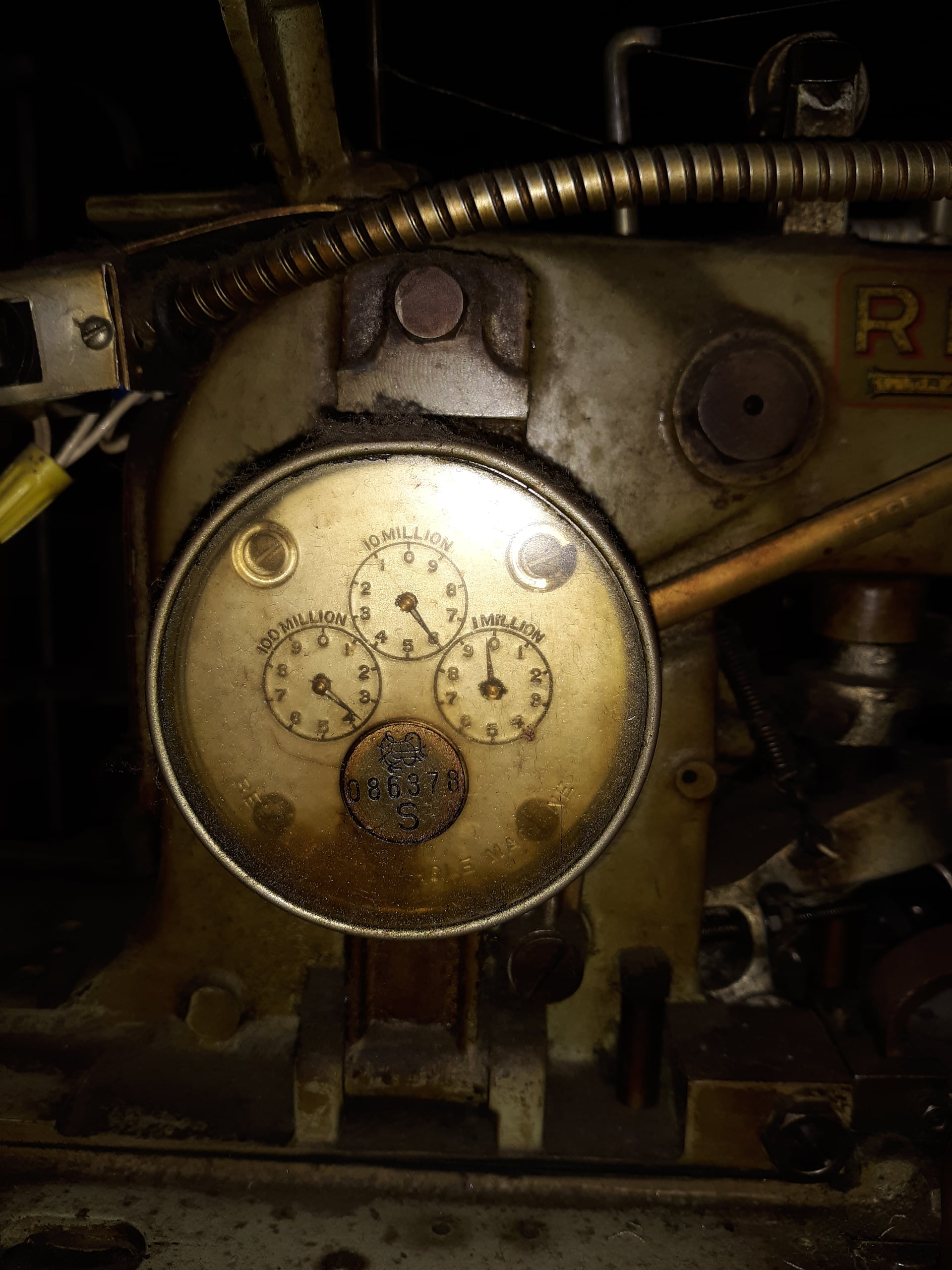

Our old Resse buttonhole machine: They were originally only available to lease, that why they had a counter on the side, and Reece would charge by how many buttonholes were made.

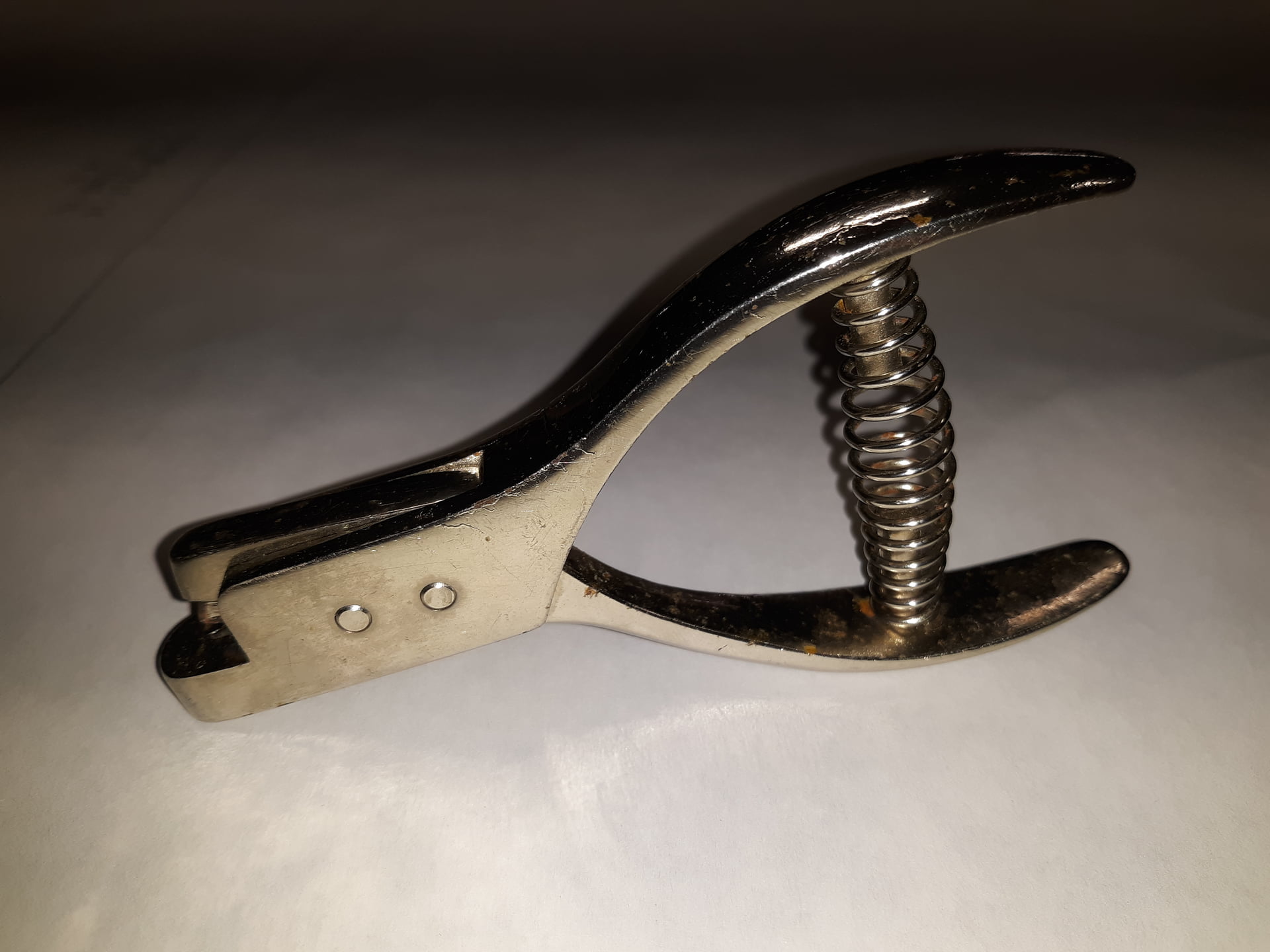

Paper notch punch:

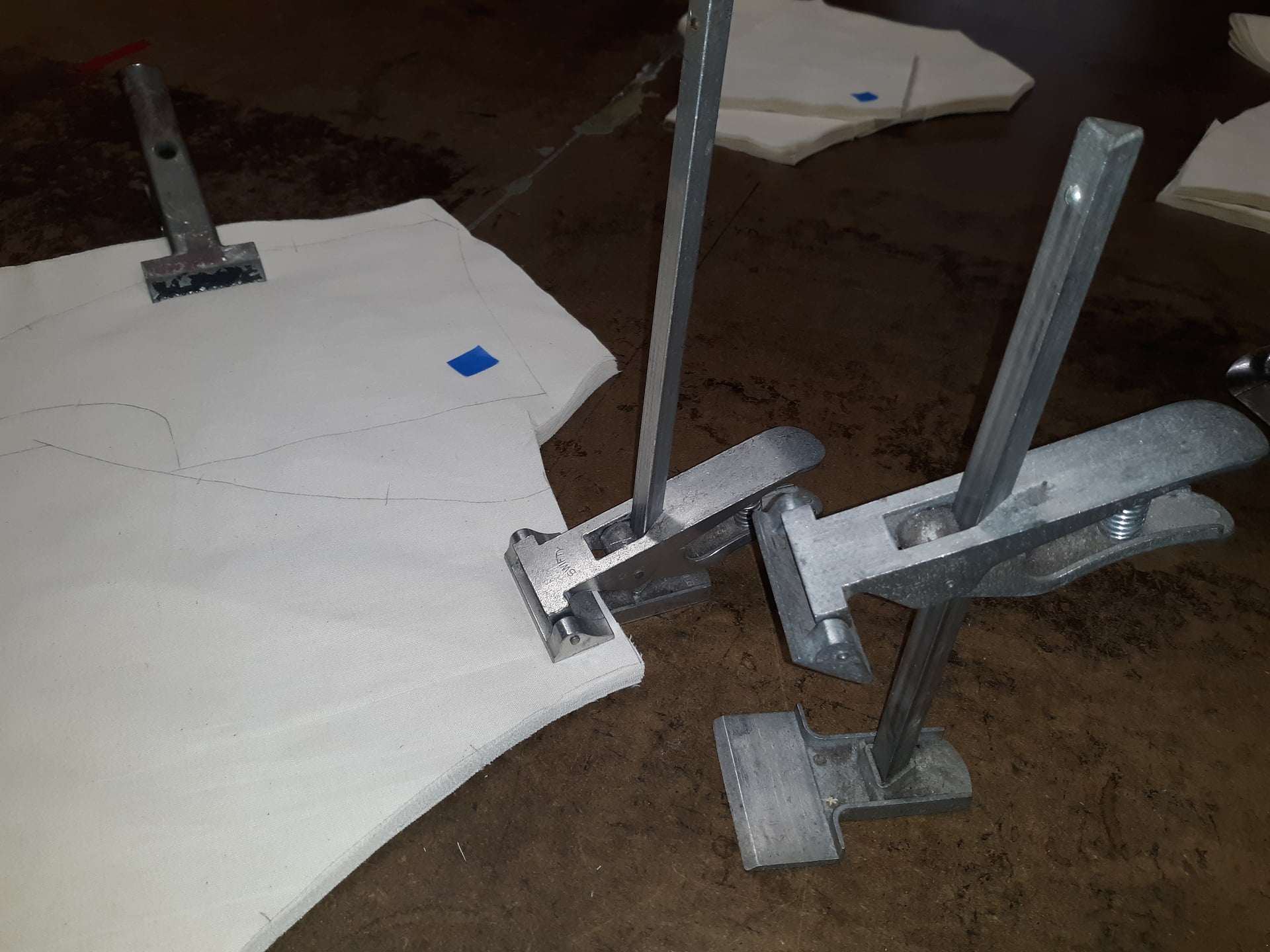

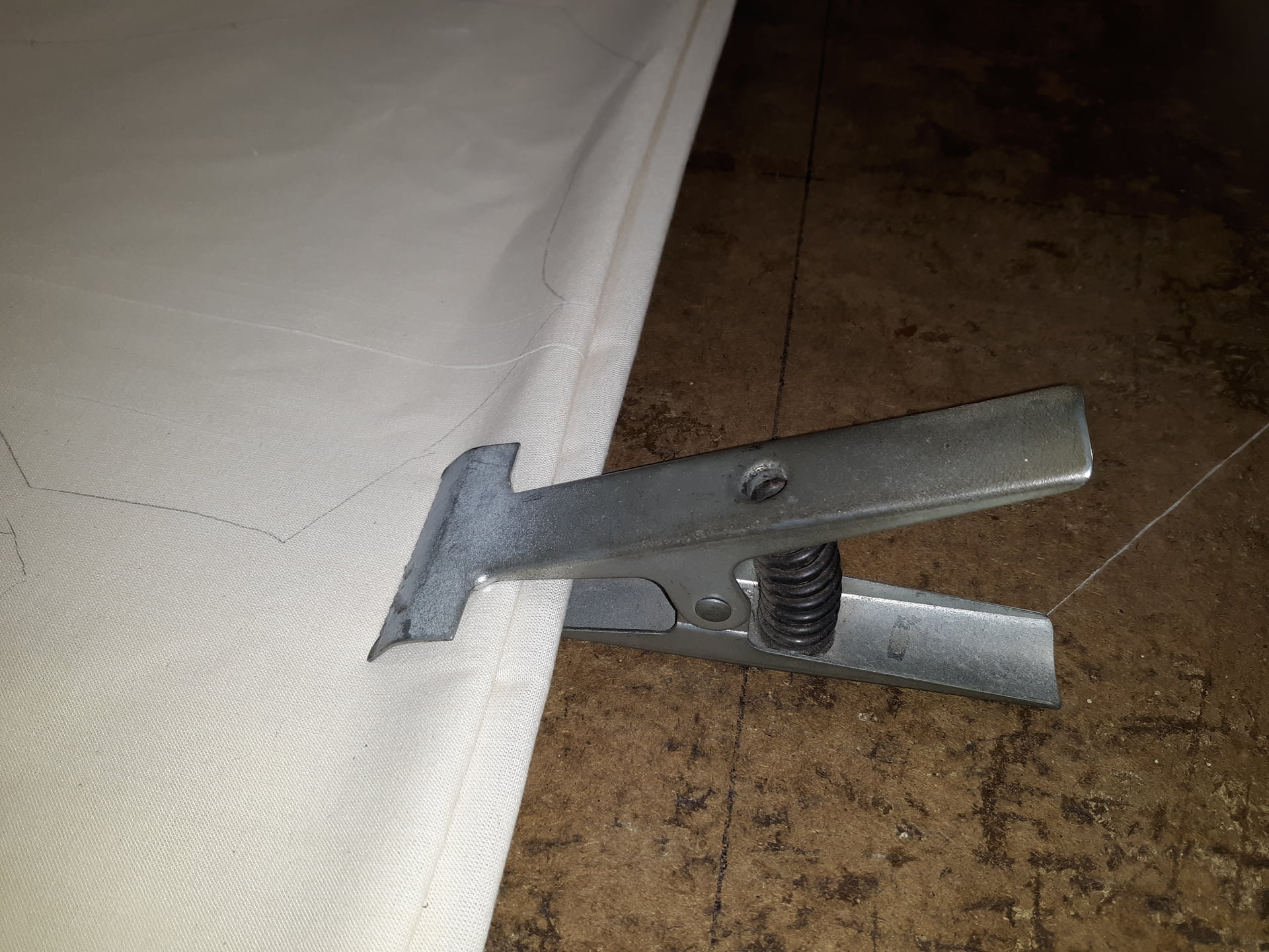

Fabric clamps… instead of pinning I often used clamps to hold fabric cuts together:
4 Me gusta

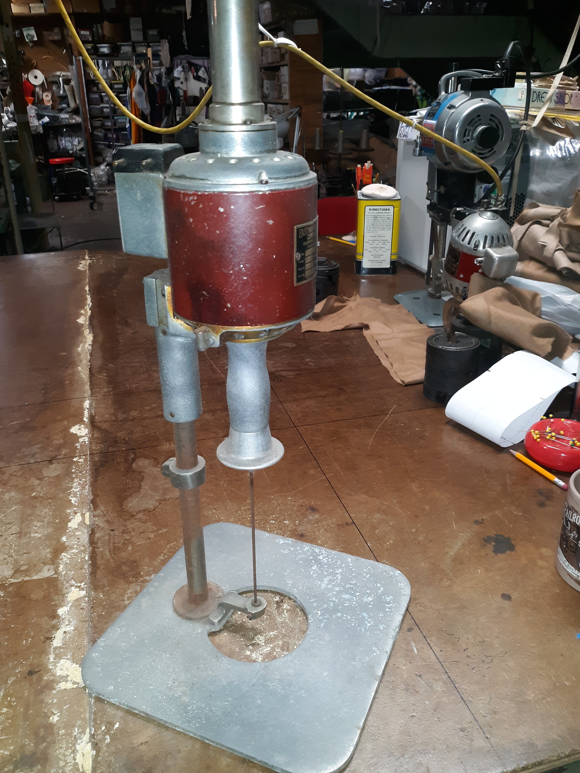

A fabric drill… if you have a spread of say 50 layers… how do mark things like pocket location? You’re not going to mark each piece seperately… that what a drill is used for. BTW… this is what drill point in an AAMA file refers to.

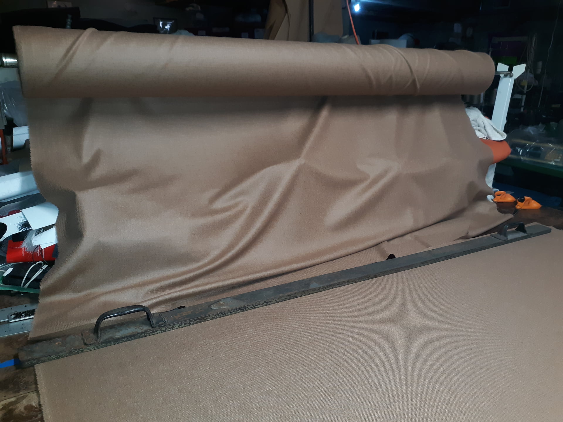

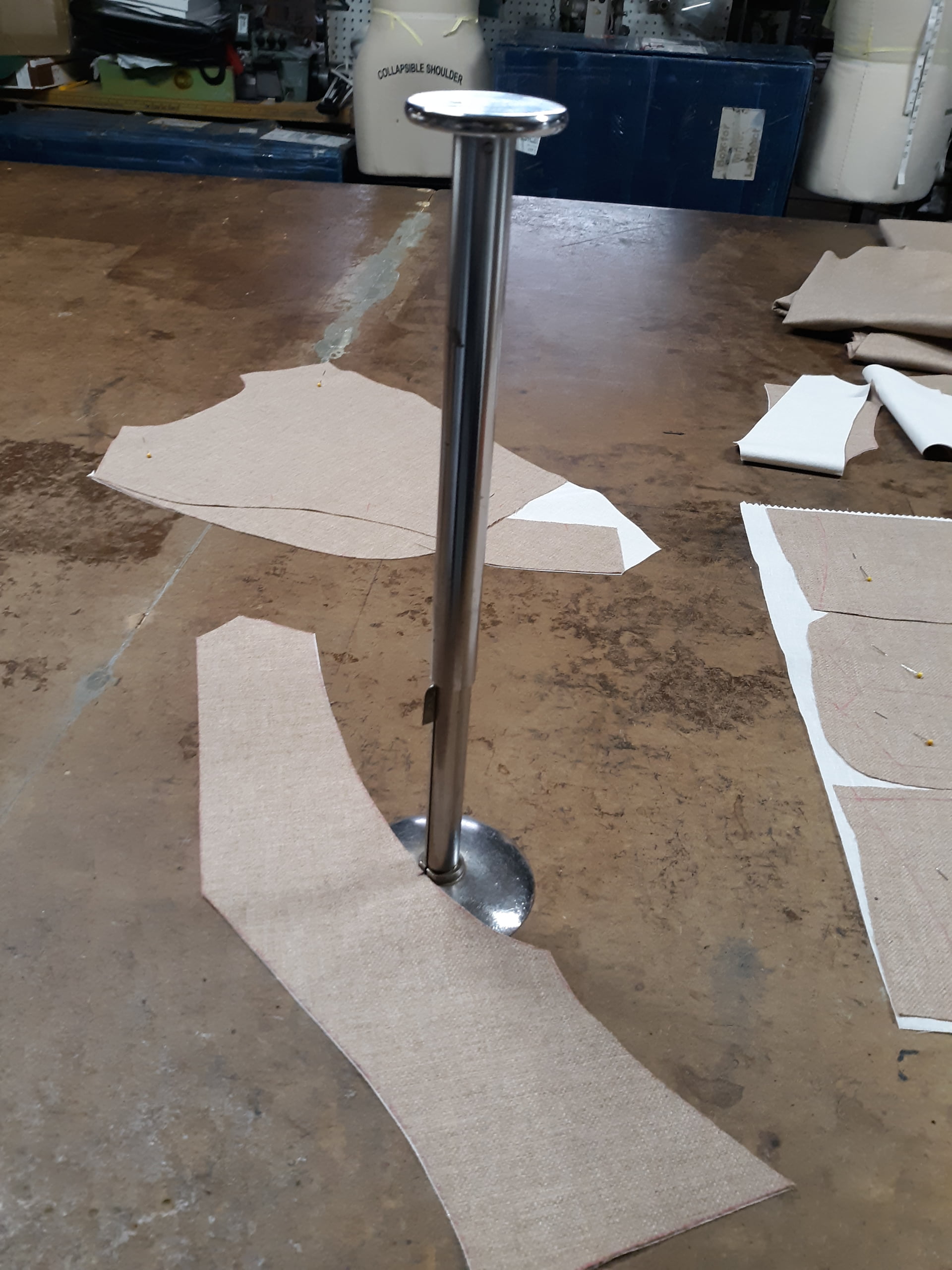

Yes, I had a 40 foot by 72" wide cutting table. Simple but effective… we had heavy chunks of steel with handles to hold the fabric at each end when spreading out mutiple layers. Also you may notice theres a pair of orange Fiskars with the black tape on the handle… those were mine. If the scissors / shears had black tape on the handle it meant Do Not Use - find another pair. :grinning:

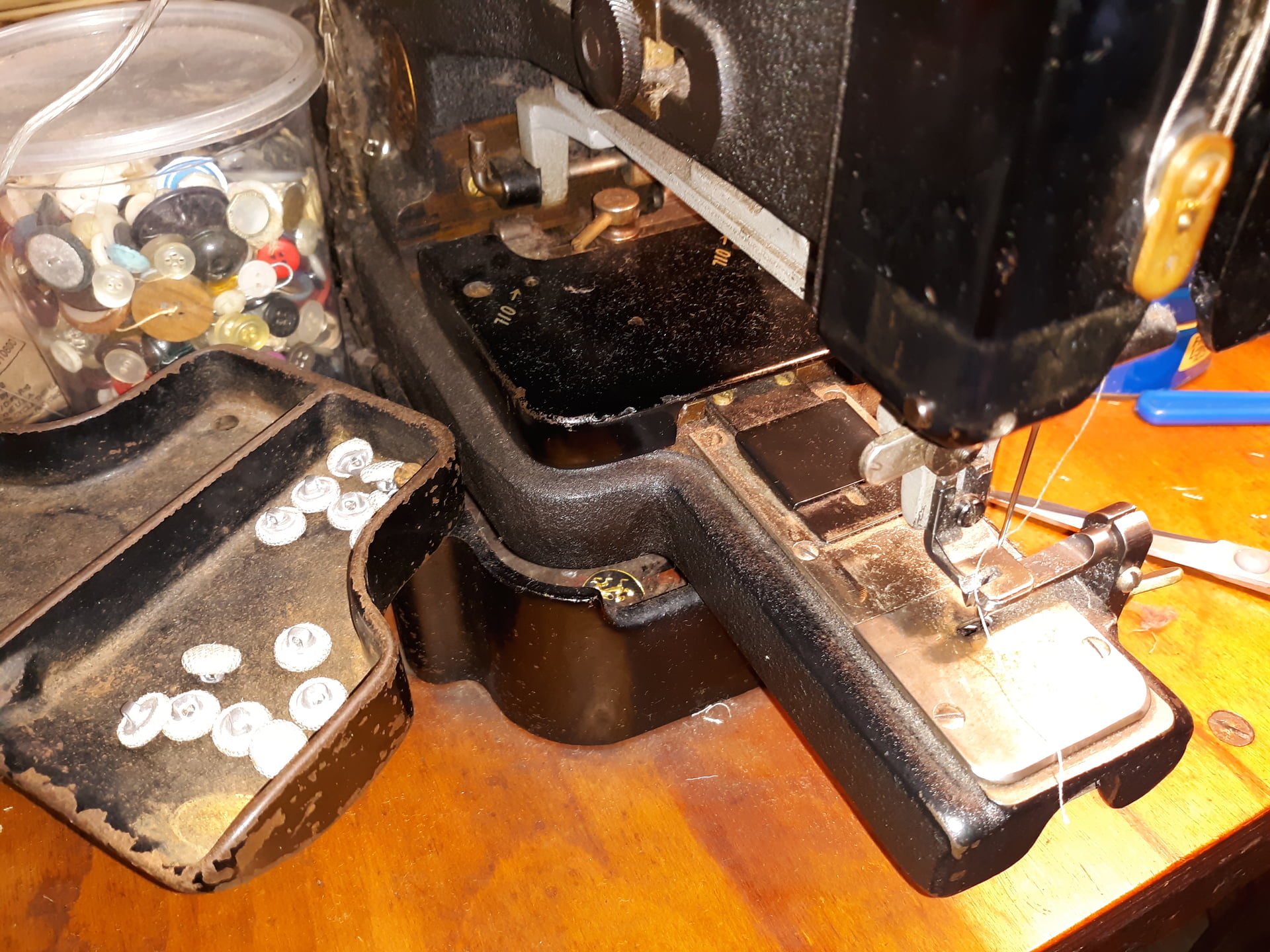

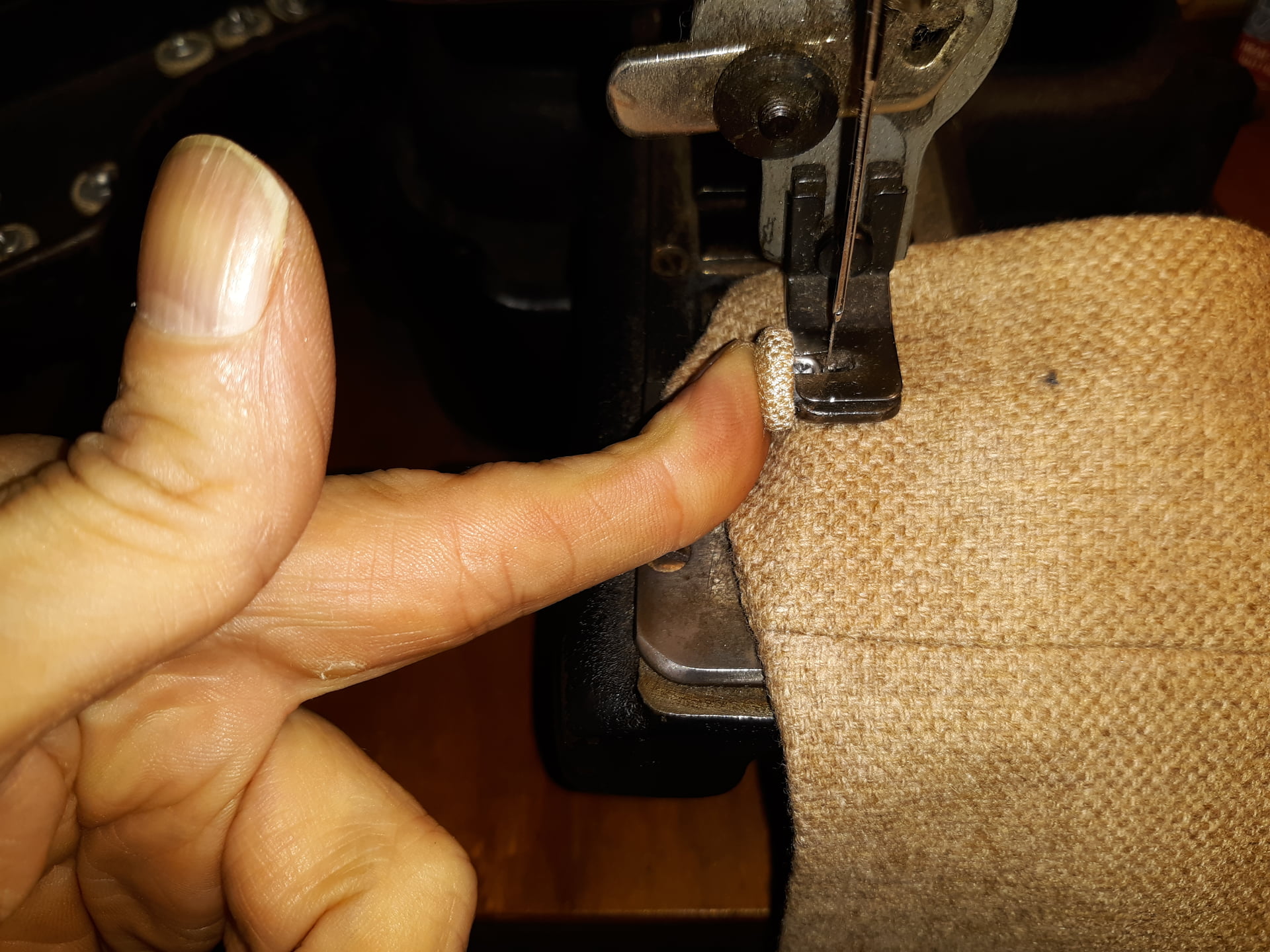

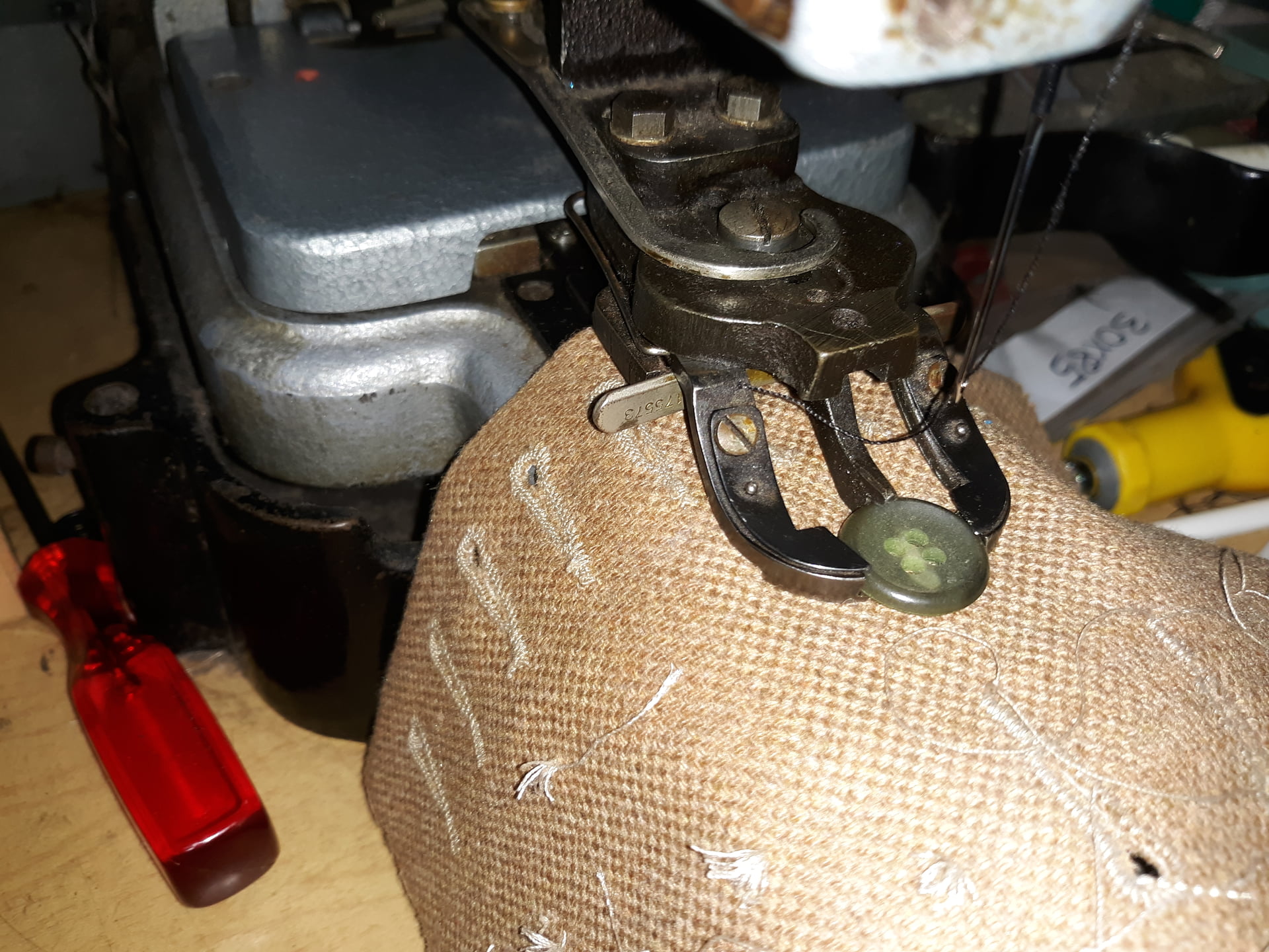

If you’ve ever wondered how machines stich shank button on… they use a button machine with a shank attachement.
Same Singer machine - albeit a newer “blue paint era” model set up to stitch 4 hole buttons. This type of machine had 2 cams. one that makes the machine go side to side, the other to make it go front and back. When stictching shanks you would disable the front to back… or more specifically set the front to back travel distance to 0. This pick is with the plastic guard out of the way, as it was common to break buttons or worse the needle if the button wasn’t aligned correctly OR if you were doing 2 hole buttons and forget to disable f to b.
6 Me gusta

Did you happen to catch the number on the buttonhole machine counter? Almost 370 million buttonholes! Not all were made by us… my partner found the machine used at some place that went out of business. :slight_smile:
5 Me gusta
Wow ! :star_struck:
