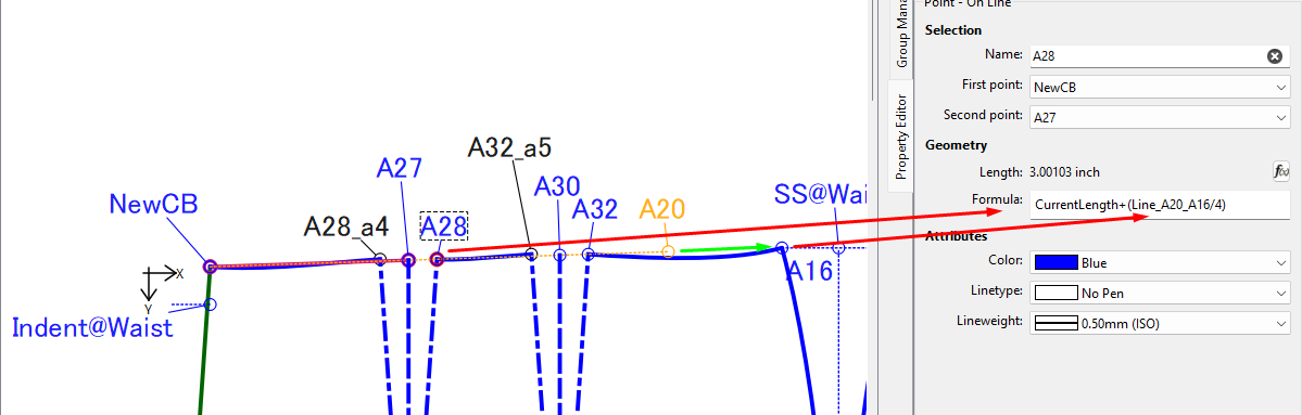

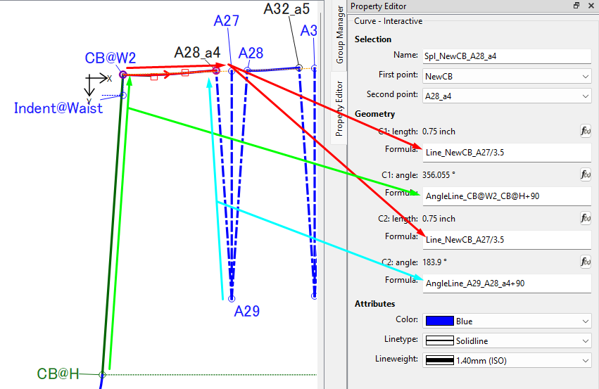

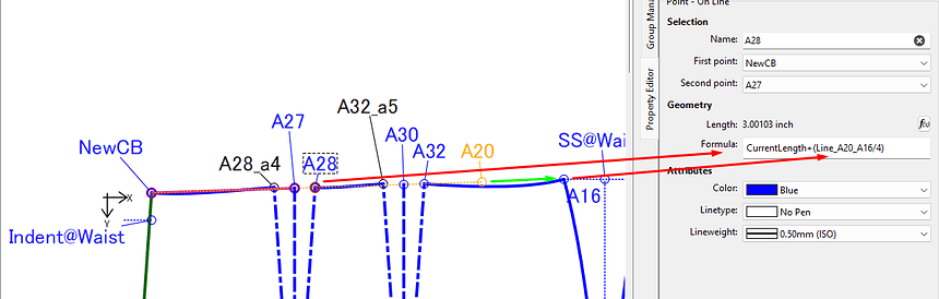

First I establish the centre of the dart on the slanted waist line, then I place a point at half the width of the dart at 0° from this centre dart point, which I mirror to the other side. I repeat this for the 2nd dart (if there is one). I place a point at the depth of the dart (downwards) and draw 2 lines from this point to the 2 new dart width points (this gives the angle for the curve connecting to the dart leg).
Then I draw the curve between the edge and the dart leg, the curve between the 2 darts & the curve from the dart leg to the other edge.
(Line 16 to 20 is the amount that the waist needs to be taken in with darts. There are 2 darts and in the formula, I’m only using half of the dart. This is why I’m dividing it by 4.)
You will read in other topics that I always use formulas in my curves so that my curves remain true to the size of the pattern when changing sizes or measurement files.
Once you have the dart legs drawn, you may choose to add curves, if you wish. This is only a test pattern for me that I created to test a theory.
