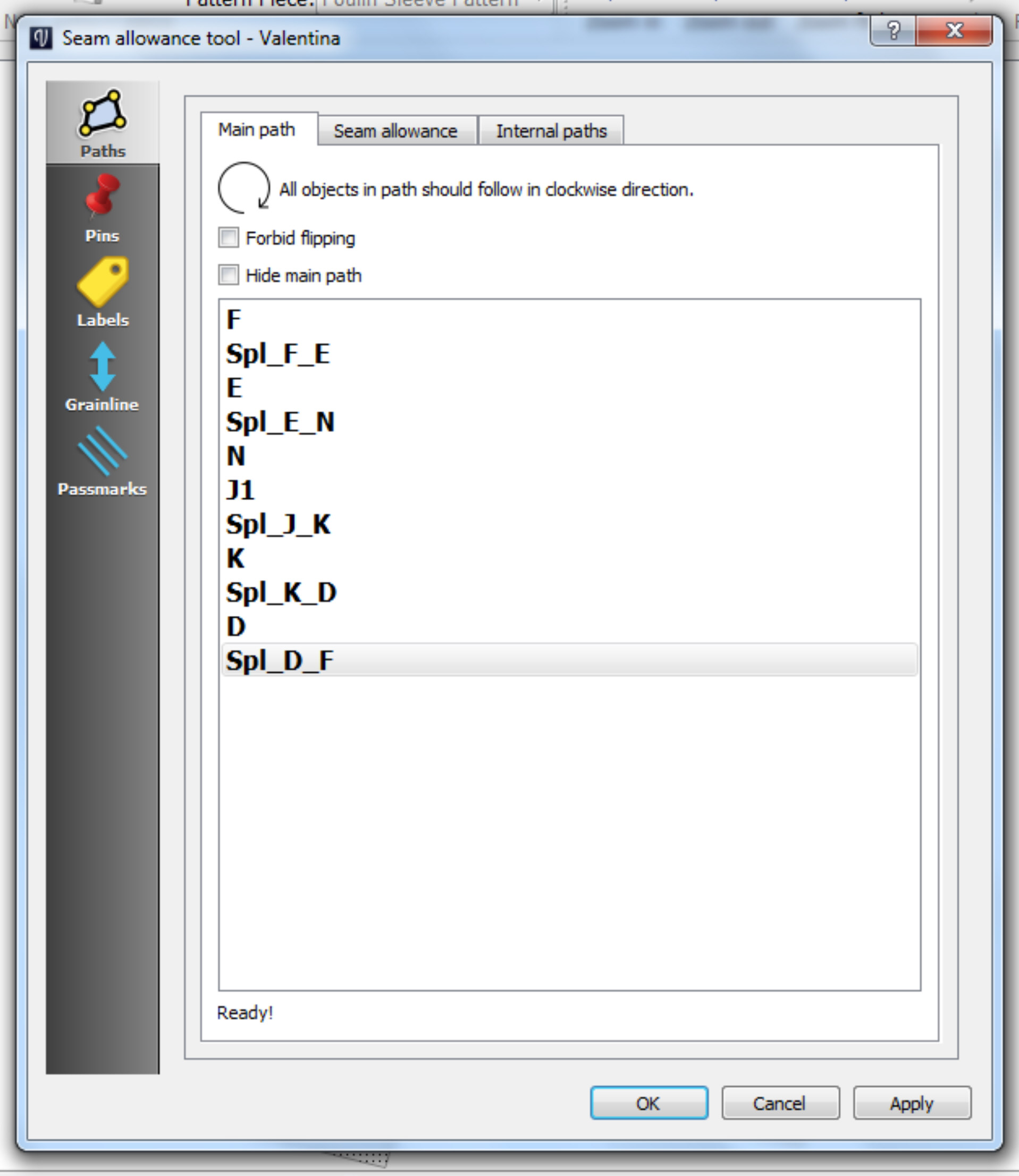

With that said… follow what Grace said, keeping in mind to create a “pattern piece” you have to select objects (points, lines, curves) in a clockwise direction and you want to close the piece - that is make sure to end with the last object before the 1st point you selected. Also eventually you need all curves to go in the clockwise direction. If you find you missed an object or added something extra, don;t worry - you can edit the detail list in Detail mode by selecting the piece and using the right mouse button → options. You will see something like this.
You can delete, reverse a curve’s direction, rearrange the order of objects, or make a point a notch (passmark). If you missed an object (or 2) you have to return to Draw mode and select a missing object with the insert node tool;
