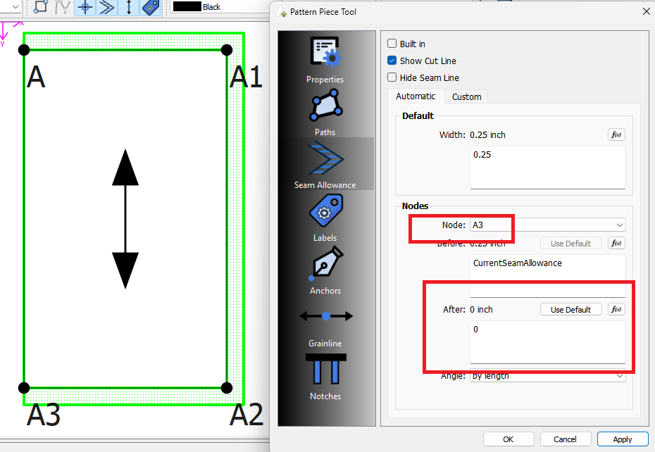

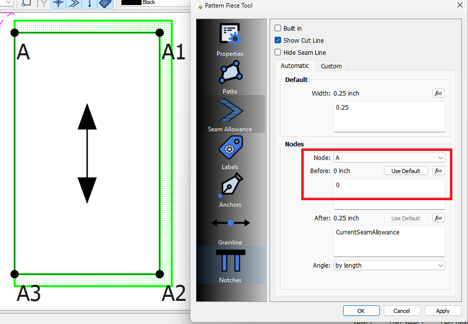

The only way I use the custom seam allowance tool is in creating a fold line (which has no seam allowance) with seam allowance present on the remaining surfaces. I am sure it is possible to have a much simpler way of indicating that a specific line is to be cut on fold.
You can create a foldline by simply setting the After SA to 0 and the Before SA to 0 between 2 node points.
Way easier than dealing with a CSA.

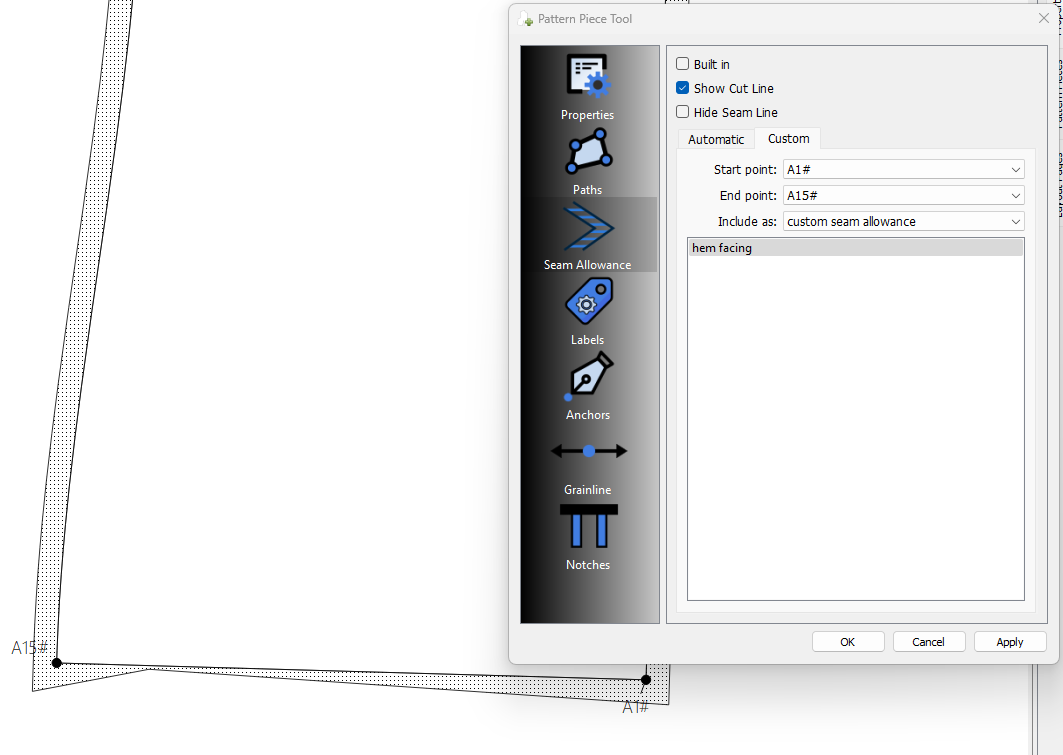

Using the Custom Seam Allowance Tool is totally different and is very complicated (my pea-brain just can’t get a handle on it nicely). It’s found here:
And you need to create the Internal Path and set it as Custom Seam Allowance first:
And then you can try your best to get it to do something nice in this area… Very complicated :rofl:
Ok, so I used it completely wrong, but I think you get the idea. It’s a tool all on its own.

Hem facing, part of the cut piece. Def. CSA is A1#, A15#, Spl_A15x_A8, A23, facing_h
result
It should be like this. Yellow marked part will be the CSA.

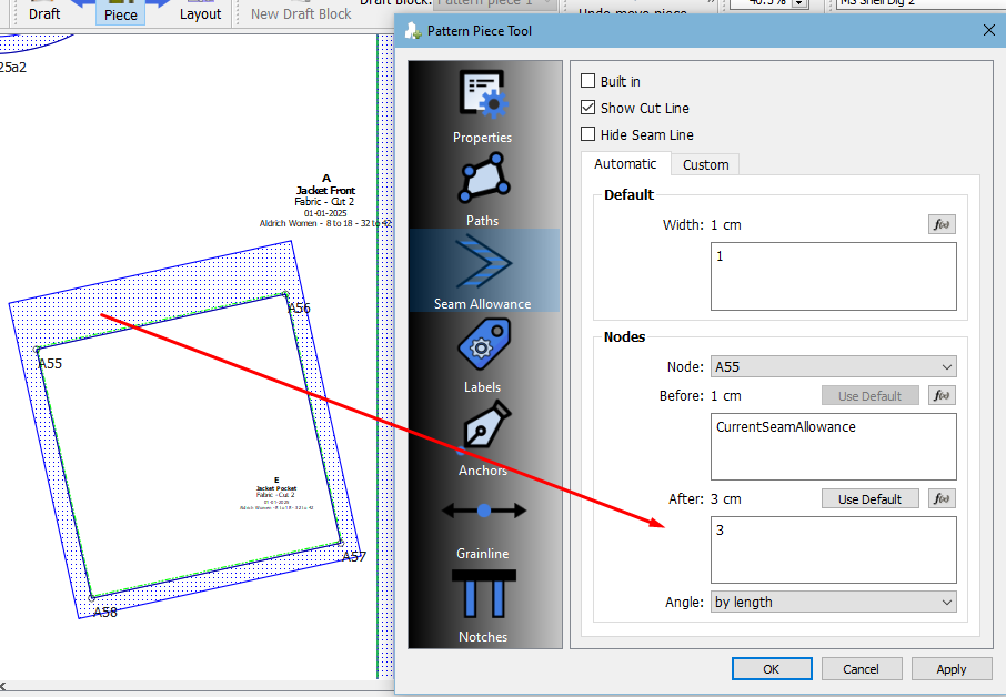

For a little insight into how the Seam Allowance works… depending on the corner “angle” selected for a node - the angle type determines how the app calculates the “projected” corner(s) of the SA (cut) path. With the typical By length it calculates the points in red as such:
Screenshot 2025-01-02 180511
Where my idea of simply adding 2 new corner options we can calculate the corners as such:
Screenshot 2025-01-02 180521
It’s all just simple geometry instead of the convoluted Internal path->CSA tool.
