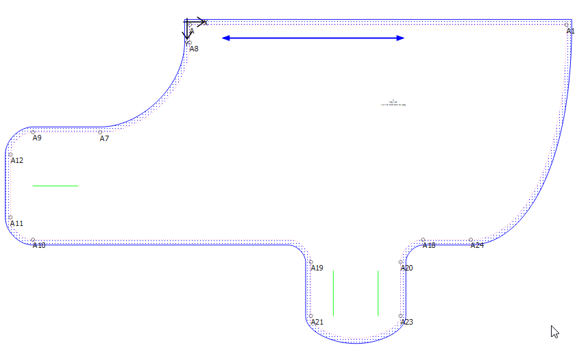

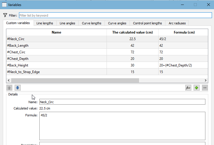

I put the measurements into the Variables Table because my 3 are very different sizes and I can just edit them in the pattern if I want to make them new ones:
Here’s the pattern if you’d like to have a closer look:
Dog Coat - Deni.sm2d (19.0 KB)
