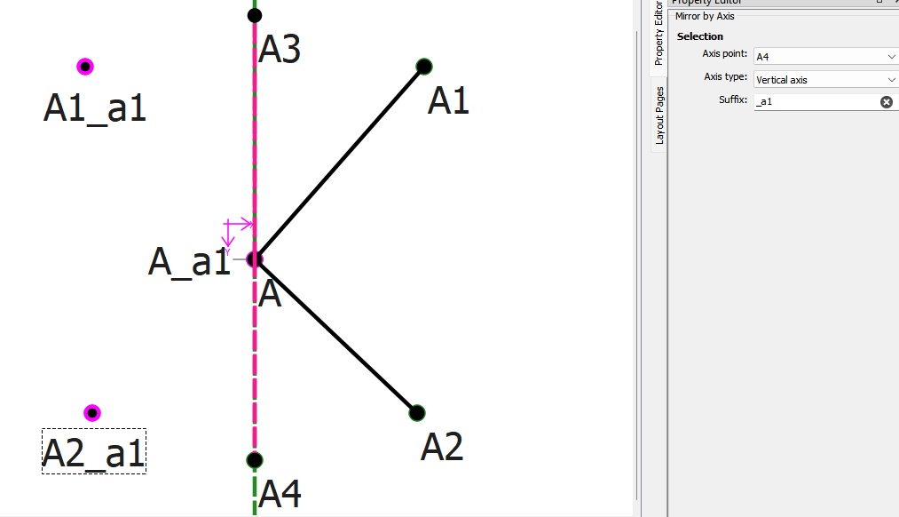

Here’s a simple Mirror example. Lets say we want to mirror points A, A1, and A2… using the Mirror by Axis , selcting points A, A1, and A2 (while holding the Ctrl key), then selecting point A4 as the point for a Vertical Axis we get:
Those 3 points now are mirrored with a suffix of “_a1”. You are free to chage the suffix. One caveat with the Operations tools… be careful when selecting your group of points and curves as we currenly have no way to edit the group once the tool is created. If you miss something, you’ll have to delete the tool and try again. Check and make sure all the objects you want show the bounding box around them… like:
Once your objects are mirrored, you can now select the Add Piece tool image as usual, and select the mirrored points to create a mirrored pattern piece.
