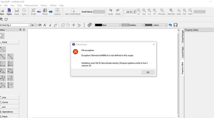

Hi, I made this pattern yesterday and it was working fine . Today I tried to open it but it shows this message and wont open . is there anyway to fix it. , please? note : I made this pattern without adding any measurement file to the pattern .

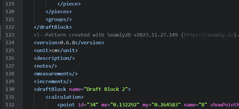

apron pattern.sm2d (15,0 KB)Hi Sara…Yes. We’ve seen this happen before. For some reason this part of the pattern file:
< !--Pattern created with Seamly2D v2023.11.27.149 (https://seamly.io).-->
< version>0.6.8</version>
< unit>cm</unit>
< description/>
< notes/>
< measurements/>
< increments/>
was written in the middle of the file and not at the top so draftBlock "Apron " was being parsed out of order:
Here’s the fixed pattern file:
apron pattern_fixed.sm2d (15.0 KB)
I also suggest you update to the latest release as the pattern was written using a a version that’s about a year and 1/2 old. There’s been a lot of bug fixes and new features added since then.
