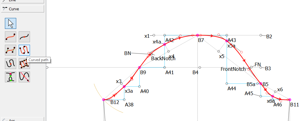

The tool that is used in the video is a bezier curve. The tool that I would suggest is under the section Curves on the left - Curved Path tool:

You can quickly check the length of the total curve or line by hovering the cursor over it. The line of the curve becomes thicker and it shows arrows on the line to indicate the direction that the line was created in. In this case, it was created in a clockwise direction (this will become useful later when you create the detail of the pattern): image
