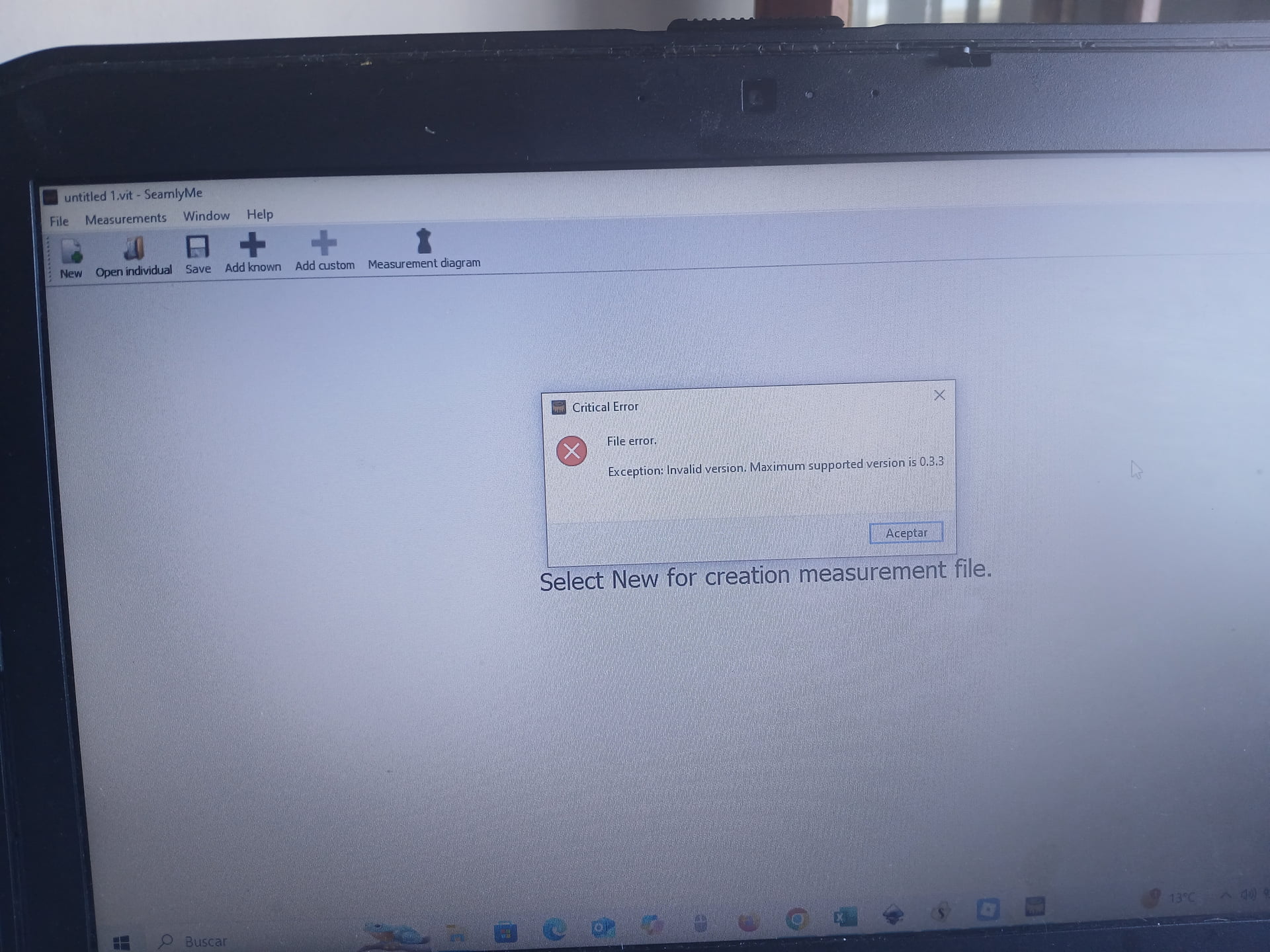

Hola, vengo con otro inconveniente. Cuando abro el SeamlyMe para modificar una medida aparece ese error critico
la version de seamly que tengo es la que dieron en el forum
Agradezco su ayuda

No⦠the error indicates trring to open a newer ME file in an older version of SeamlyMe.
It was an old .vit file on a newer version of Seamly.
Or trying to open a vit / vst file that was made in Tape after the fork.
You can open older vit files in SeamlyMe⦠it will convert⦠you canāt open newer files in an older app. That what the Error message indicates. The version of SeamlyMe being used could only open a max schema of 0.3.3. Our current schema is 0.3.4. User needs to udate the apps.

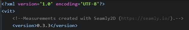

This will open in SeamlyMe:

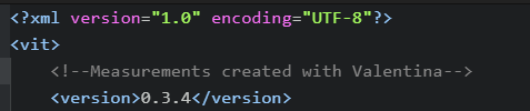

This would not:

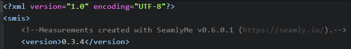

As the SeamlyMe now checks for the < smis > tag for files newer than < version >0.3.3< /version >
In other words⦠the file format diverges with version 0.3.4.

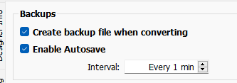

That being said ⦠if you donāt want the backups - thereās the Prefs option I already added about a year ago:
Plus I also made it so the apps will only make 1 conversion backup if it doesnāt already exist so you donāt end up with mymeasurments_v033.smis, mymeasurments(1)_v033.smis, mymeasurments(2)_v033.smis, mymeasurments(3)_v033.smis⦠like it use to.
