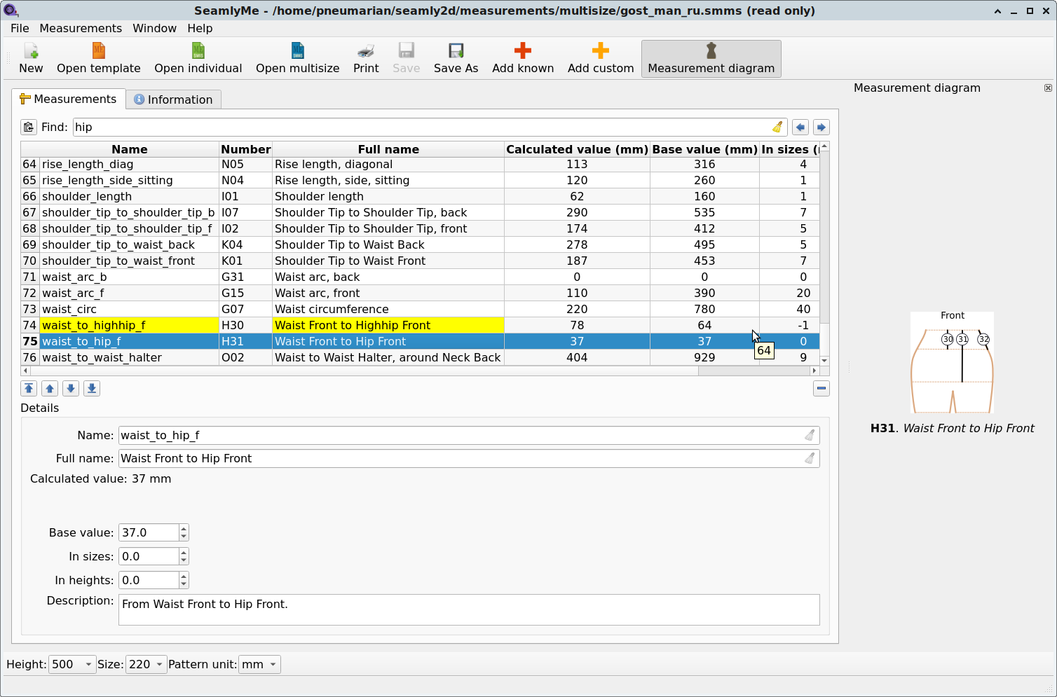

Backstory: This morning, in part due to recent troubles people have had with the darts in the store pattern, I decided to bite the bullet & experiment with a notion I’ve been mulling over for several years: creating variable darts.
After briefly considering just forcing it with manual measurement adjustments whether in the variables table or the pattern itself, I decided that it would be best to follow @Grace’s example & start with a multisize measurements file. I considered starting with a brand new file, & that might be a next step, but the GOST file is all ready, desperate to find use.
After looking around at the available measurements, & reflecting that the recent trouble was with trouser darts, I decided to go with waist/hip relations.

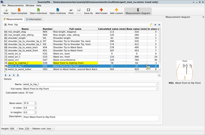

Problem: Imagine my surprise then, when I discovered that the waist to hip measurement is significantly less than the waist to high-hip measurement!
Needless to say, although I assume the GOST file will still serve for this experiment, I will not be attempting to use it for an actual garment.
(This also highlights the desirability of having the measurement diagrams visible to the Formula dialog in 2D)
Looks like the 2 values might have been switched.
