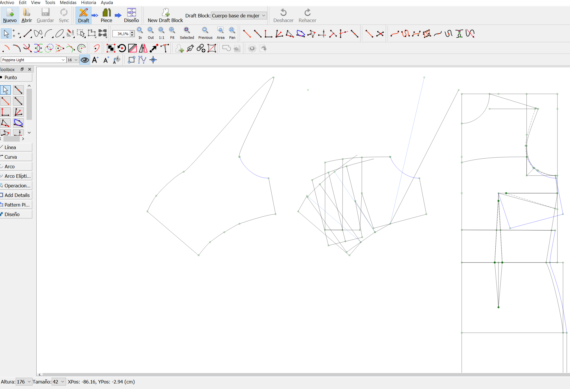

While working with the tool “Intersection Point of Curve & Axis” I have encountered an error that had never happened before.

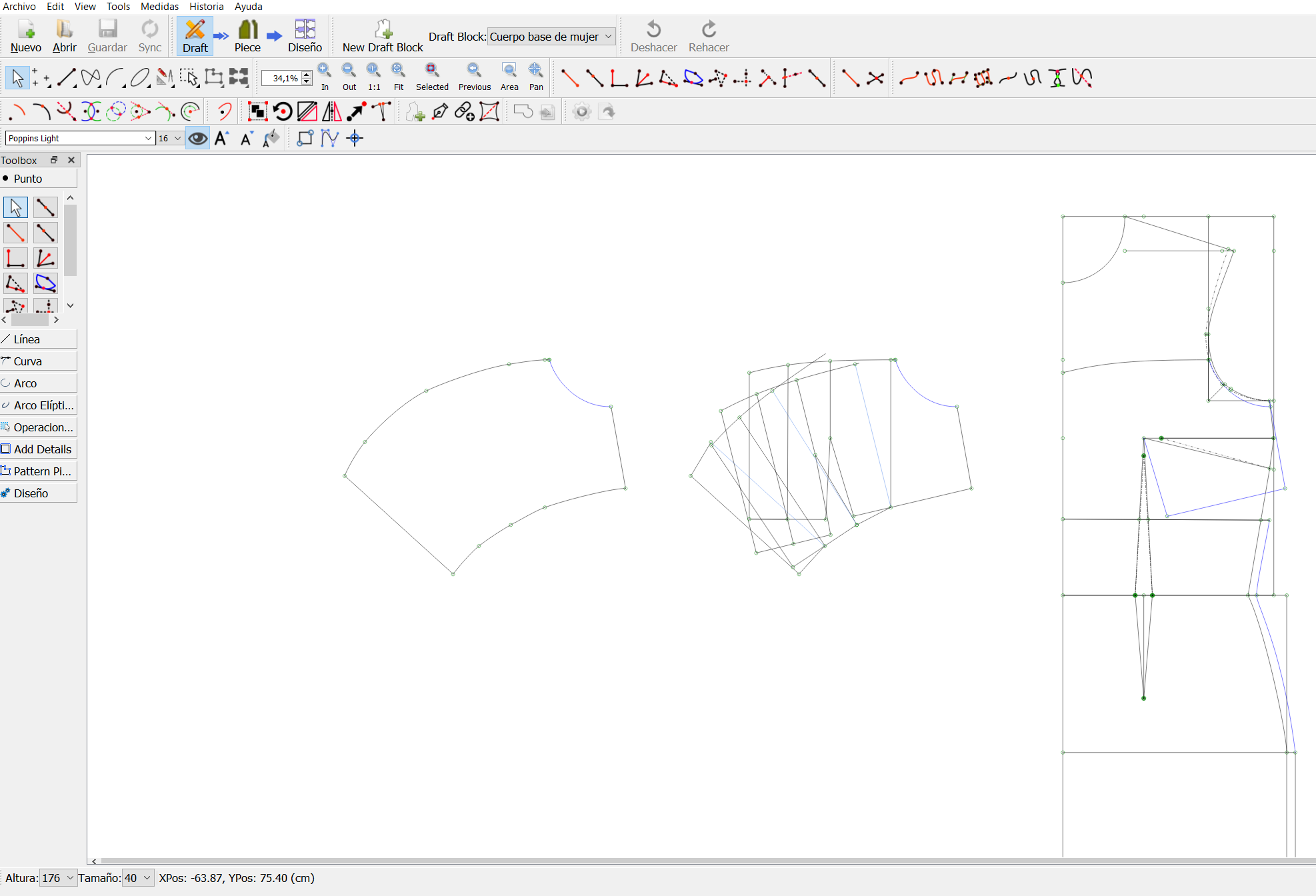

For the front pattern piece I was trying to make a gathering in the neckline part, for this I have drawn several parallels and used the “Intersection Point of Curve & Axis” tool.
As you can see in this first image it works fine up to size 40, but from size 42 onwards the problem arises with the following dialog box

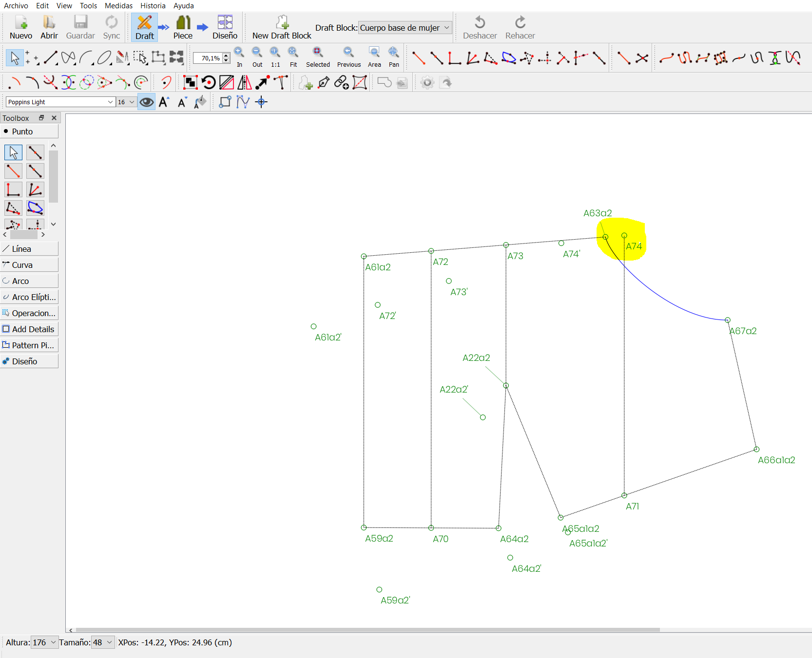

It’s not an error per se, but rather a measurement or calculation in a formula has placed the intersection point past the bounds of the arc in question… therefore the application has to use some constant known point - the origin- (0,0) as a placeholder, or the pattern will crash.

Thanks for responding so quickly, I was just about to post to close the thread. I have started from scratch and instead of doing it with a curve I have done it with a straight line.
This way I have been able to check that with the value I had given to point A71, point A74 was out of the pattern.
When I changed the number and lowered it, everything worked normally.
