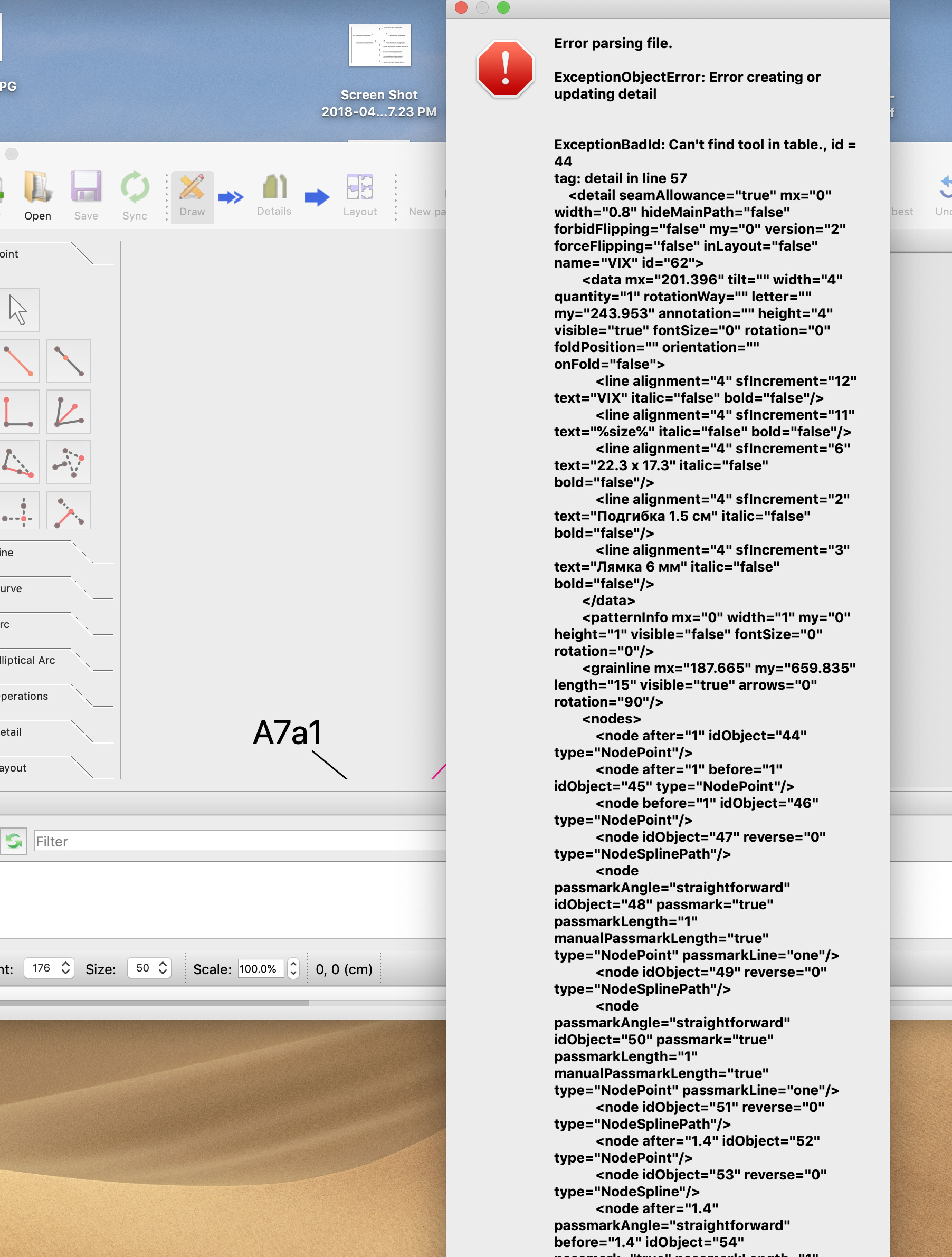

Hello During making changes (amending curves) the program stopped responding. After restarting the file is returning the “Error Parsing File” message, see screen shot attached. There was already a lot of work going into that pattern - is there a way to fix it? Thank you!

Can you please send me both the pattern (.val) and measurements (.vit/vst) files so that I can have a look at it? Perhaps I can help you.

Which version of Seamly2D are you using? or are you using Valentina, in which case, also which version?
Hi Grace, I use Valentina, last Test Builds Version Mac OS X 10.13 I have loaded it 1 week ago
I did not build pattern in this version. Only amended my file with seam allowance. Trying to amend the curve I realised that it doesn’t reflect pattern on page Details. I closed the program. Next opening faced that Error opening

Unfortunately, I couldn’t repair your file. The problem is with the Detail, so I have deleted the details and rescued your pattern drawing file so that you can recreate the details. I hope that this will help you at least a bit.
Triangle Top 2.val (22.3 KB)
Please take backups often using the Save as and adding some character while creating the Detail so that you don’t lose what you have done before. When you have your pattern complete and working, you can delete all the other backups. :slight_smile:
