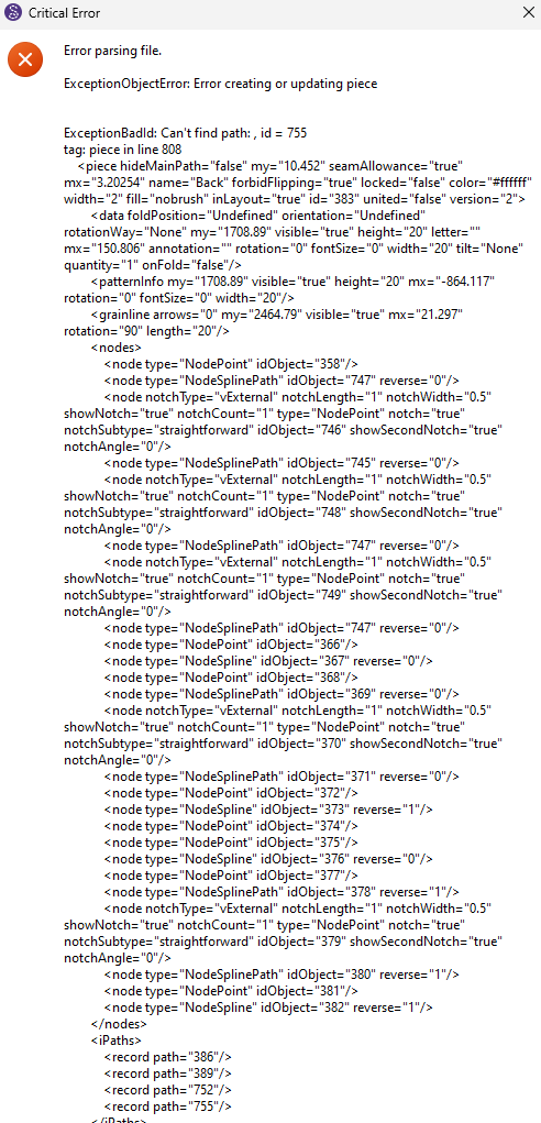

Hi, I have a pattern file with groups and quite a few personal pattern adjustments. I saved the file before exiting the software, but when I try to open it again, I get the error “exception: element groups is not defined in this scope”. Looking at the file in editor, I can’t see anything obvious, but would love if someone could help me recover it so I don’t need to go through the entire multi-step fitting process again.

Thanks for the quick reply! The measurements file is attached to my post as well. When I try to open the file you provided, I get another error (see attached screenshot)… :frowning:

Something doesn’t seem to jive with the number of <path’s and the <record references in the pieces… there’s 2 extra <paths inUse=“true” that have no reference in a piece.
@Saskia_Bucciarelli
But… I got it fixed. I deleted the 2 extra internal paths, and the one that was throwing the error (“755”) which I don’t quite understand as it’s correctly in the modeling section AND piece. Don’t specifically know what the path was… so it will probably have to be added back to the piece. I suspect it’s related to the incrementing of the internal paths and nodes… which I have fixed, but ran into a undo display issue I still need to resolve before I can upload the changes.

Yes… just be aware of the groups / image issue, as we’re bound to see that popup again. It had me stumped for a bit too, until I decided to compare the count of modeling 's to < records >'s and figured it out. As to why the modeling path for path id 775 was throwing an error I’m not sure… other than the referencing issues when deleting internal paths.
