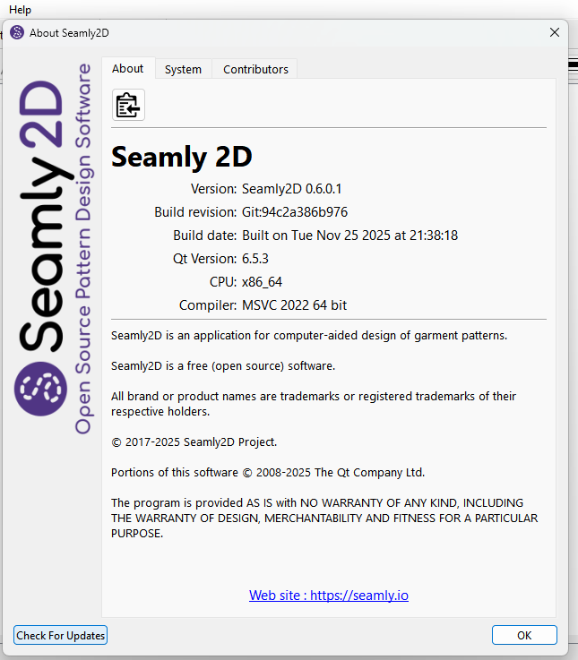

Every week on Mon @ 1:30 UTC time. Usually there’s some new changes / fixes every, but I’ve been under the weather the last few weeks so there’s nothing new the last few weeks. :frowning:
You can always “Check for Updates” throught the app via the Help->About memu:
BTW… for now I would avoid using the Union tool if the pieces have any Internal Paths. The 2 don’t play well with one another, and the Union Tool needs to be re-written.
