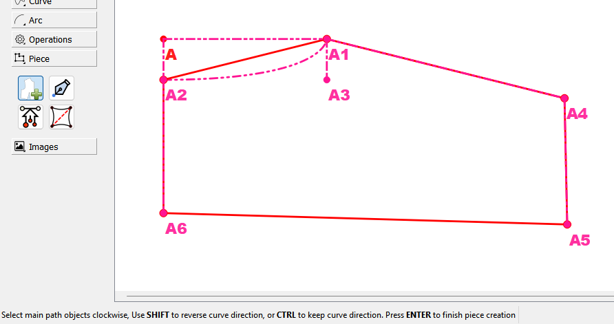

Then you start selecting nodes (points and curves)… you need to select at least 3 points to make piece (as 2 points only make a line). A red path will be be created as you add each node. You can follow the instructions in the status bar at the bottom…

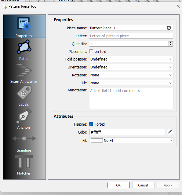

…then press Return: You will get an initial Pattern Piece Tool dialog where you can set some piece properties… press OK.

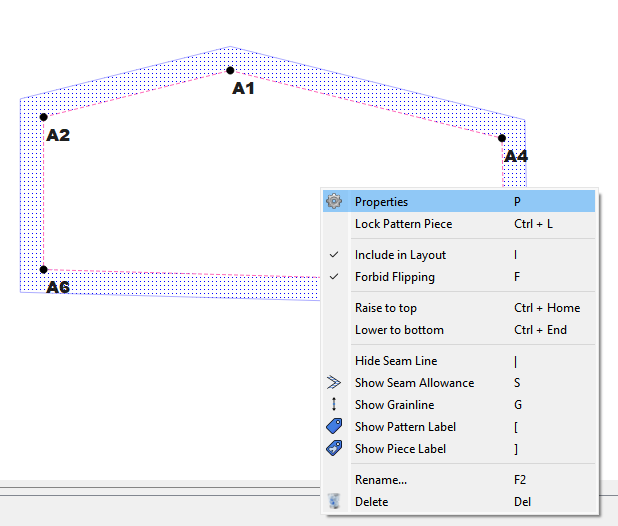

and finish adding details to the piece:

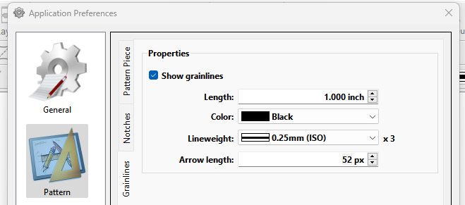

If you have the version from 9.15.2025 you can go into the app preferences->pattern->grainlines and you need to set the grainline length or reduce the arrow length so the GL length is at least twice the size of the arrow length . As a reference 48 px = .5 inch or 1.27cm

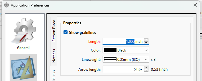

If you have the version from 9.30.2025 - where the prefs will look like this:

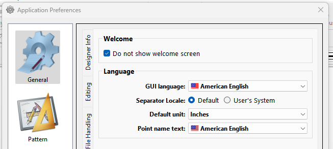

Which will automatically override and set tthe grainline length to twice the arrow length - and it’s still has the issue, then it’s locale related and you have to change the preferences->General separator locale to “Default”… at least temporaily until I upload a new fix. Changing this setting likely may mean instead of using the comma as the decimal separator, the period will be used imstead.. it depends on what your locale (region) usues.
