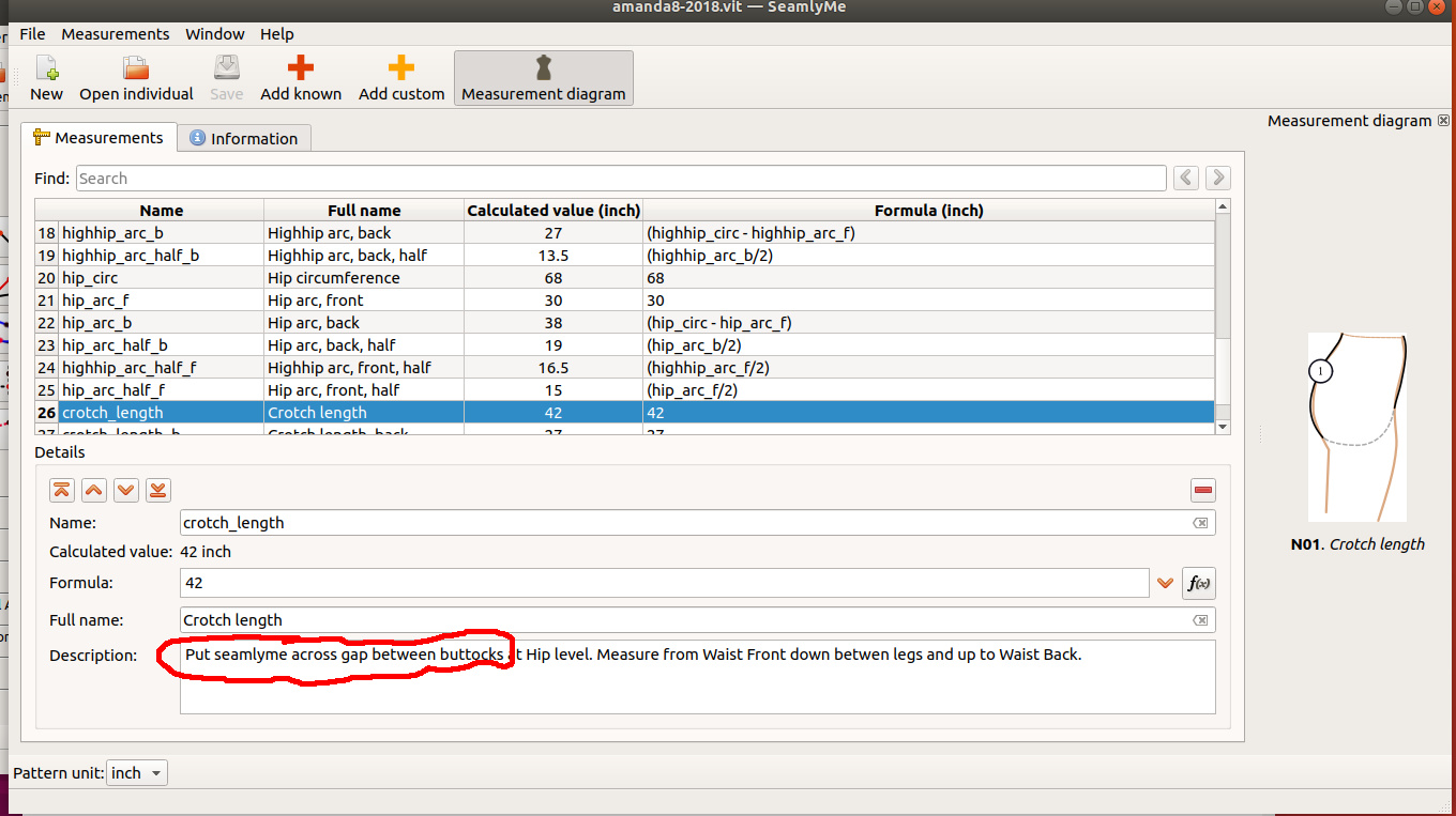

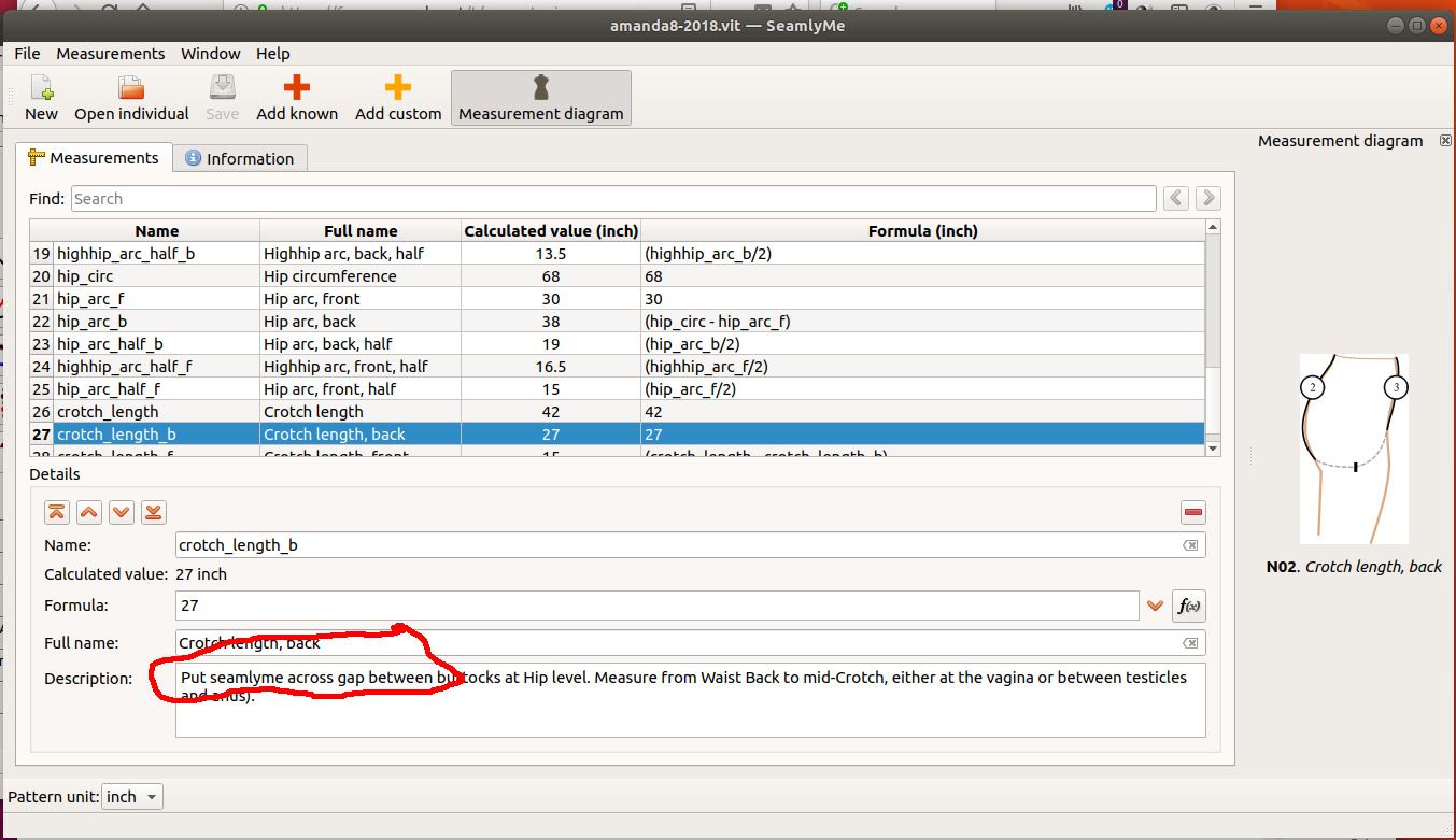

In the process of creating a new pant pattern, I have discovered several instances of text like the following in the Description field for known measurements in SeamlyMe. I am sure that the text was meant to read “Put tape across…” instead of “Put seamlyme across gap between buttocks at Hip Level. Measure from Waist Front down between legs and up to Waist Back.” This can be fixed in the source file vtranslatemeasurements.cpp. Currently the error applies to all languages, as it is in the English text that is sent through the translation process.

  • Line 1848 “Put seamlyme across gap between buttocks at Hip level. Measure from Waist.”
  • Line 1849 “Put seamlyme across gap between buttocks at Hip level. Measure from Waist.”
I created issue 166 on github to document this
