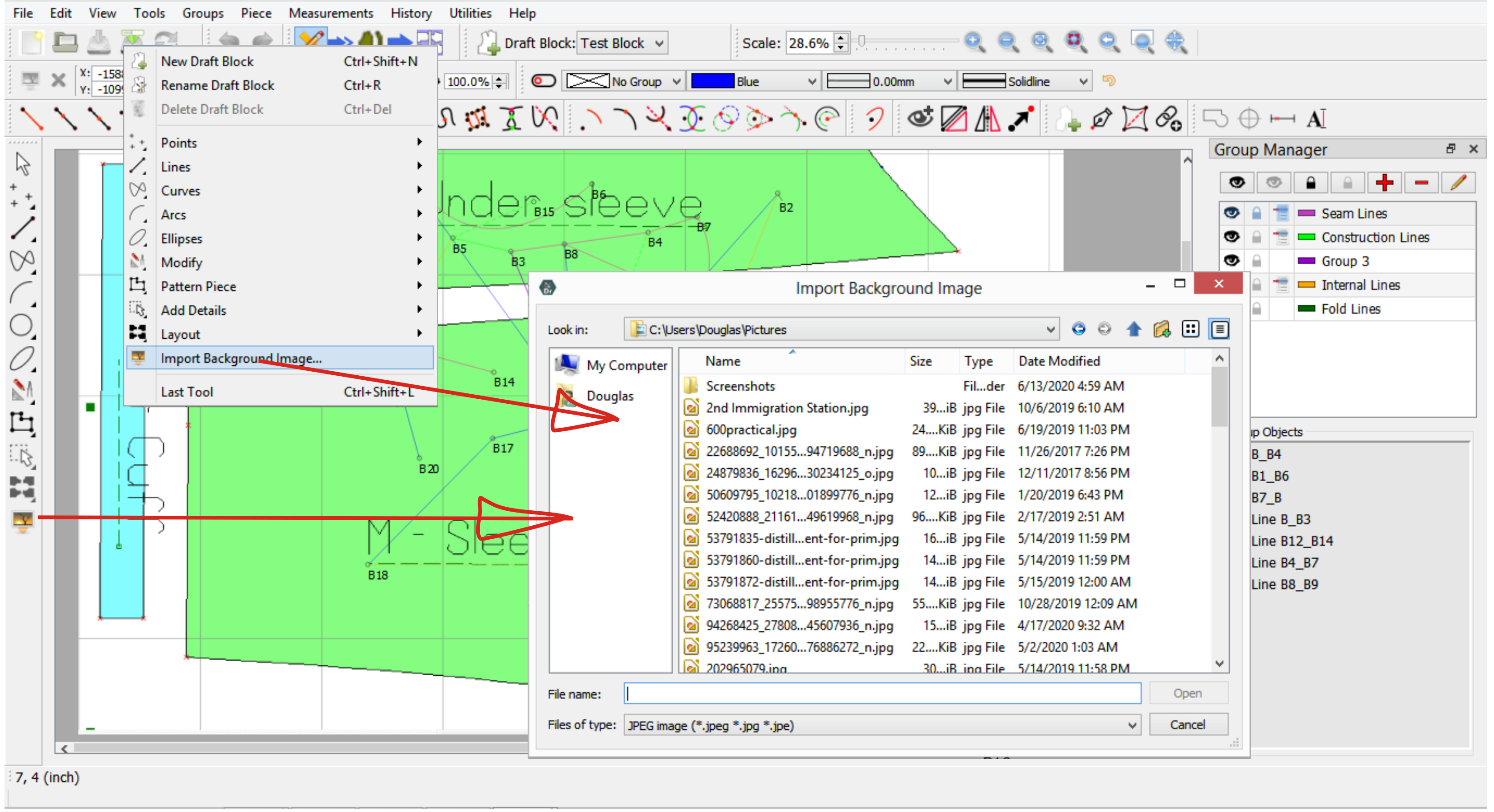

Just a note on this… I have worked out a method to import an image file for each draft block created in a pattern. It will just be a matter of time to get the changes made. Have to take incremental steps to as one part depends on another part.
Anyhow here’s a look at the image import with an actual pattern piece from another CAD program and the tool menu item and toolbar item
The toolbar in the red box is the image toolbar… you can load / remove an image, place it x/y, scale it by %, or x/y size, set to lock the aspect ration, rotate it, hide / show it, and set the opacity level. A file path for each image is saved in the pattern and the images will load in when you open a pattern.

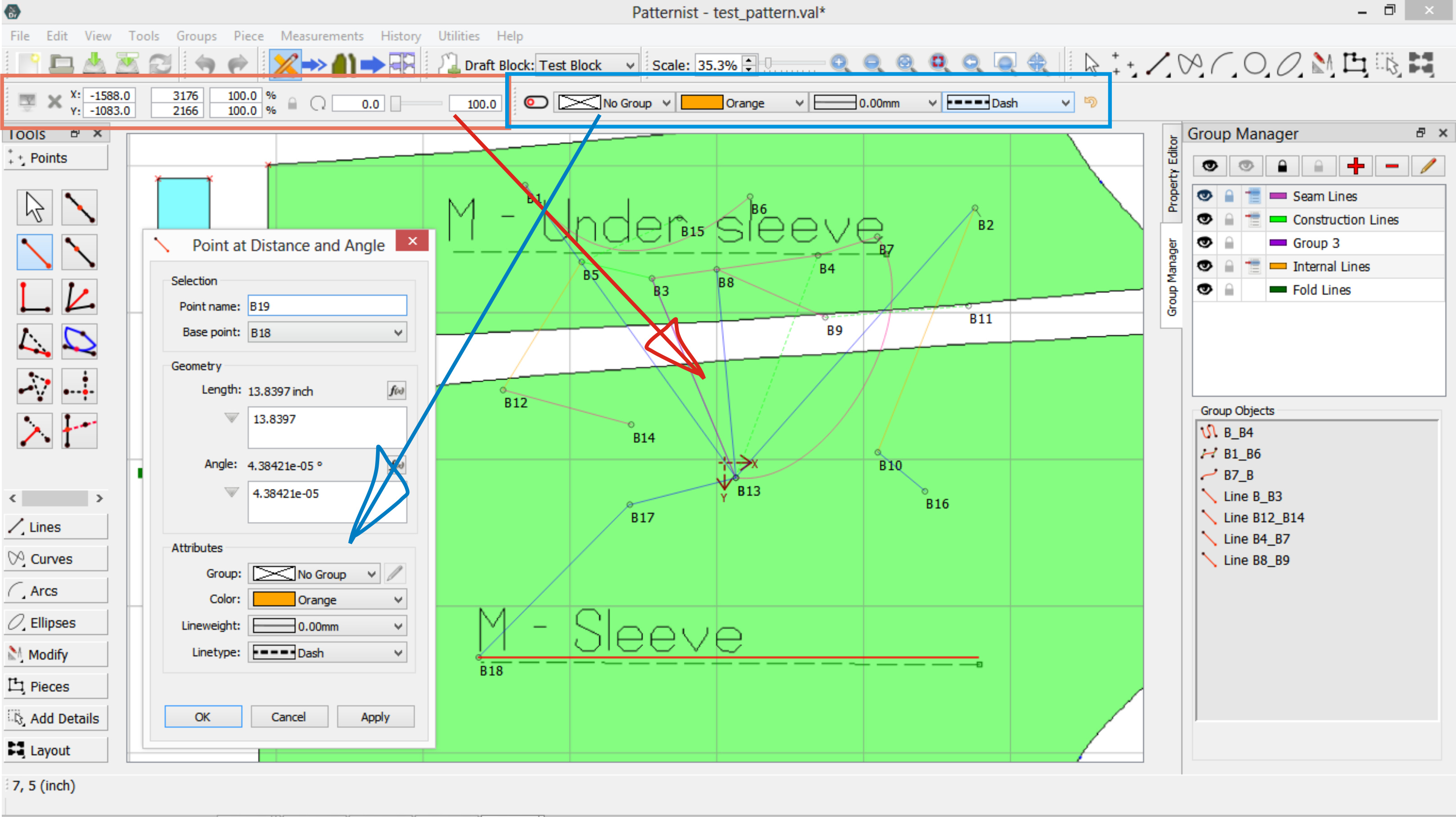

The toolbar in the blue box is the current style… you can set a default pen in the preferences and / or you can set the current pen in the toolbar and when a new tool is added it is set to the current pen. Not only that you will be able to set the group (which can have it’s own default pen) AS you create the tool. It’s a whole new paradigm and will save a lot of time creating patterns.
