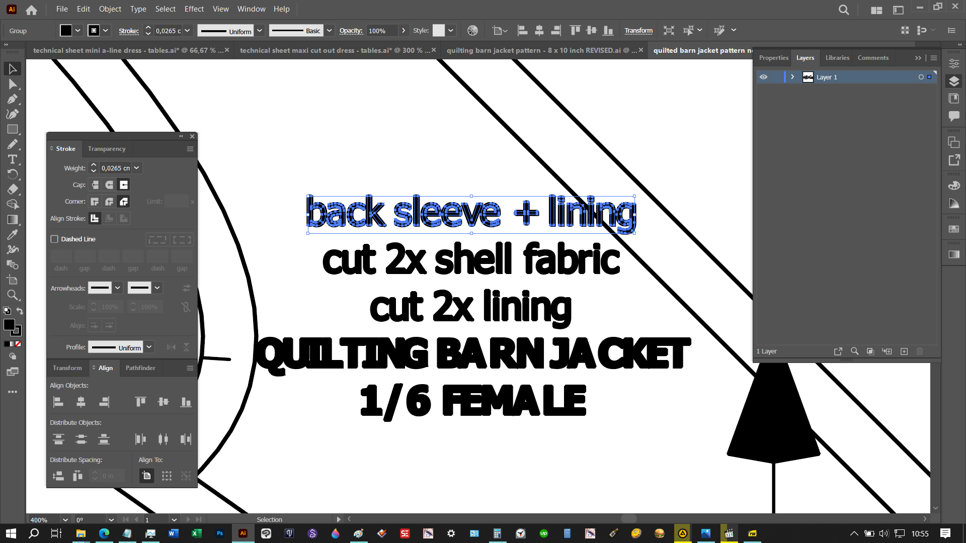

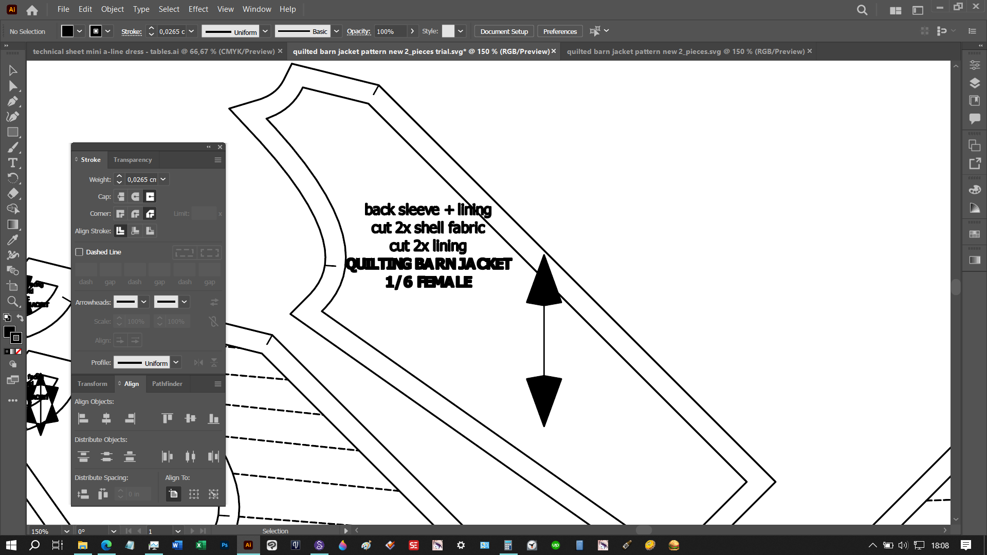

So, I usually export my file as .svg and edit it again on Adobe Illustrator. I like to add text labels and make the lines into different color if needed. Usually I also changed the text so it’s convenient if the text is exported as text, but I just realized that the new Seamly export the text into path, so I need to re-label all my pattern pieces.
This is what I usually do:

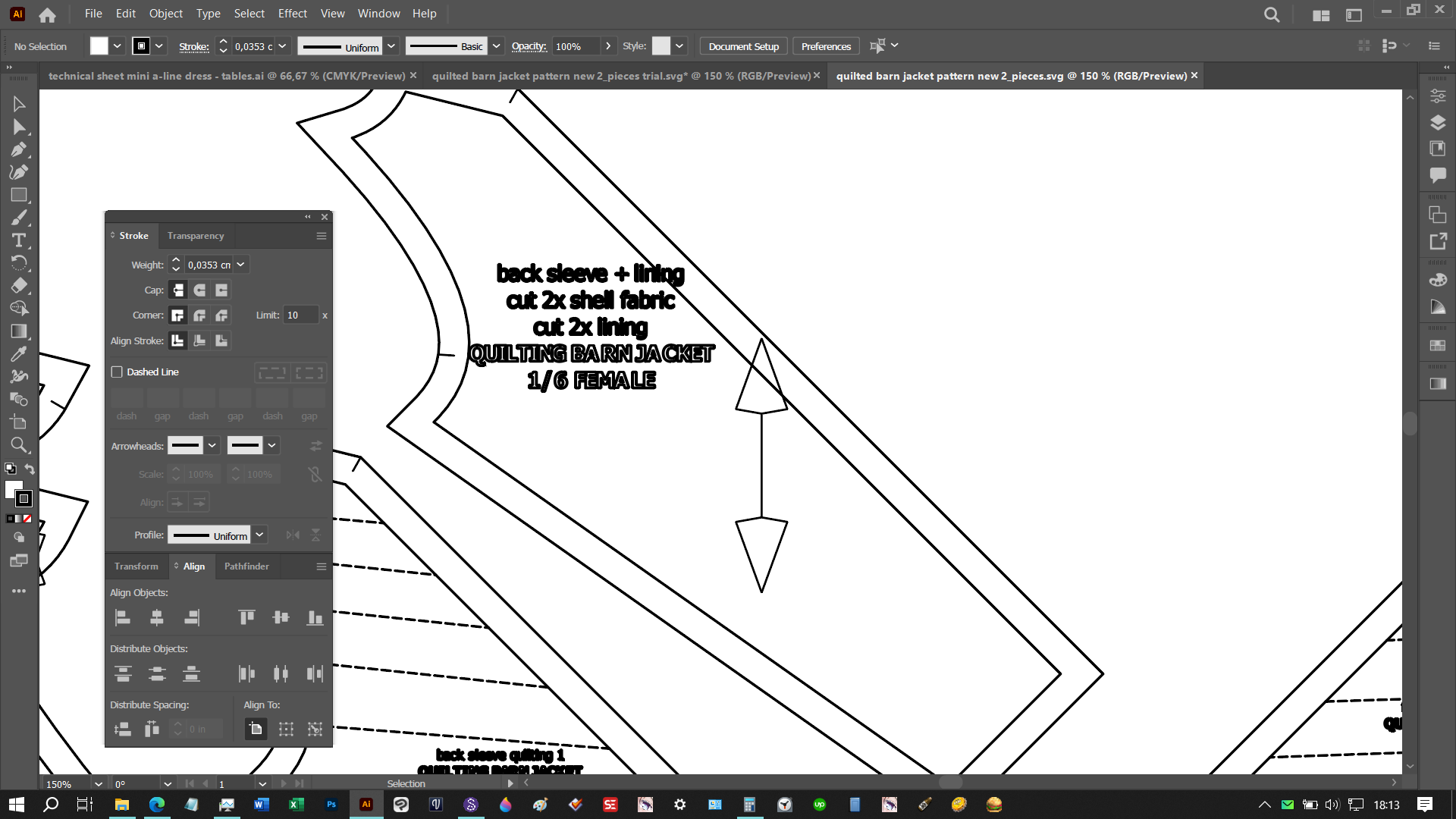

This is the current export:

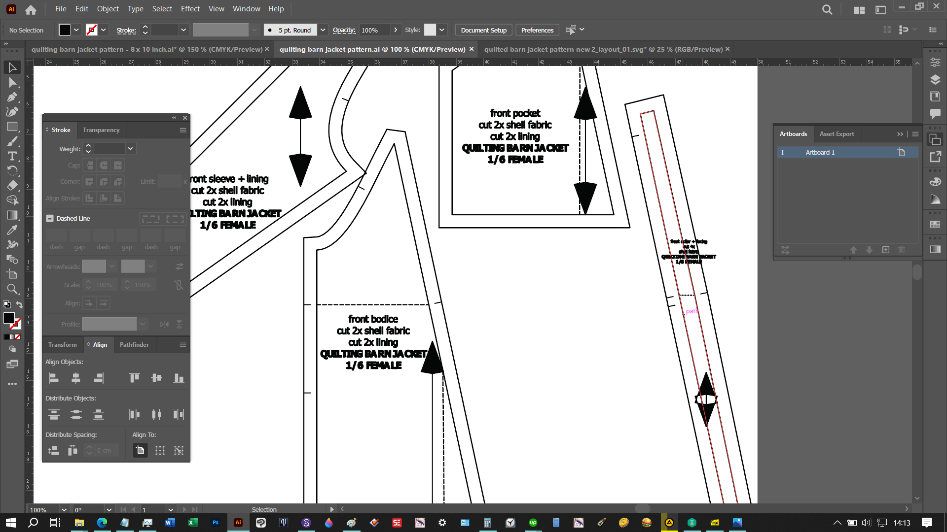

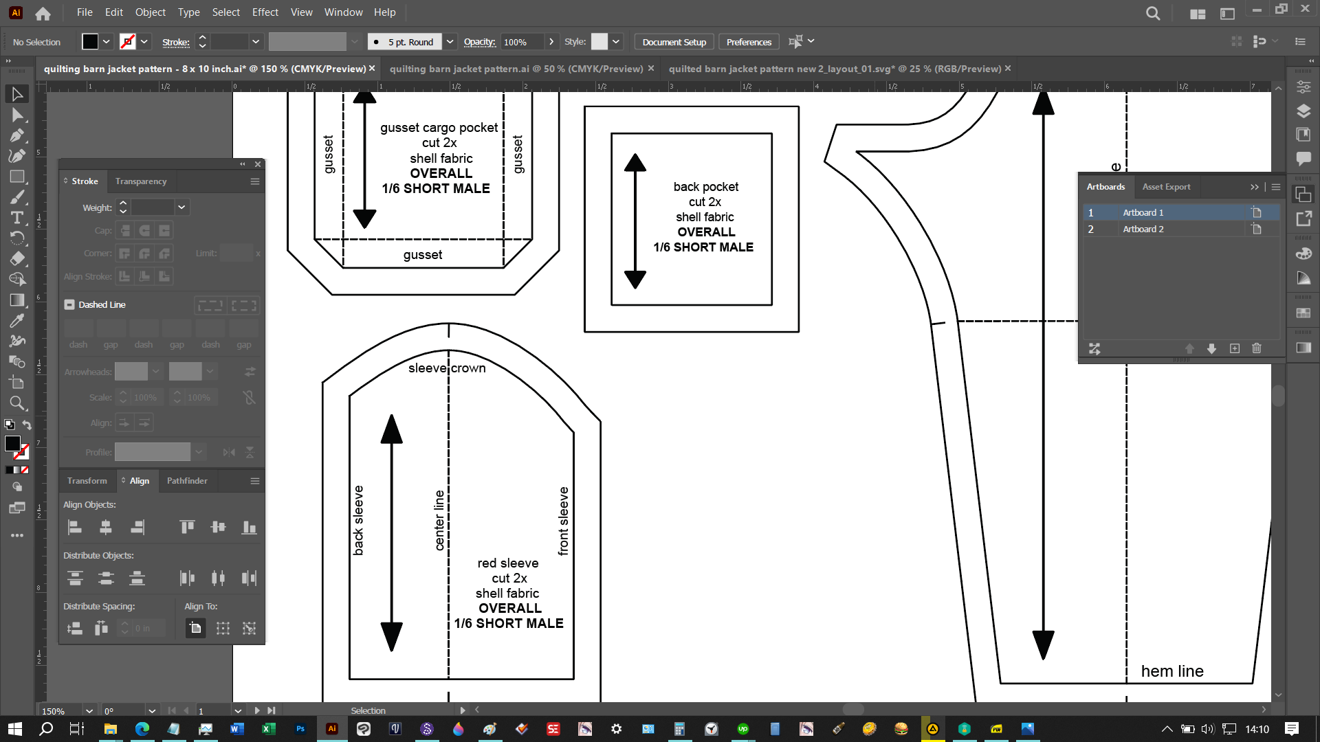

I also do quite a bit in Illustrator, and like to recreate my own arrows, especially for the on-fold arrows:
I normally just use arrow 1, and the size is normally based on the line thickness, but mostly 100 works.

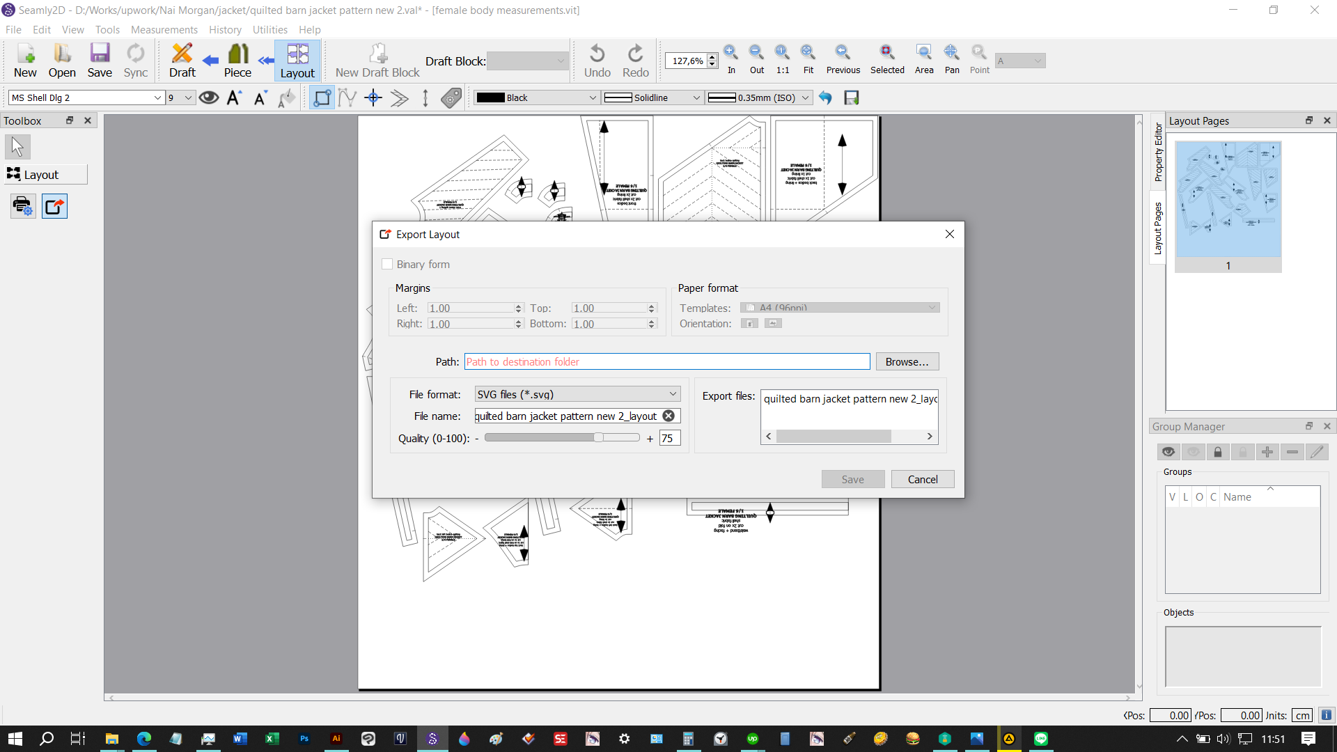

I have left the Text as paths on the layout print setting unchecked, but my Export Pattern Pieces layout is a bit different than yours. Mine doesn’t have that Text as paths option
So maybe this is why the text is automatically exported as paths?

I took a quick look… the export dialog is the same regardless of which mode you’re in, which is why I wondered what was up. For some reason RT has the “Text as path” removed in Layout mode? The else clause makes no sense, as there’s no reason to hide the checkbox in any mode.
if (m_mode != Draw::Layout)
    removeFormatFromList(LayoutExportFormat::PDFTiled);
else
    ui->textAsPaths_Checkbox->setVisible(false);
In any case if we were to remove the layout mode, I’d want to remove this layout mode relevant code from the Export Dialog class.

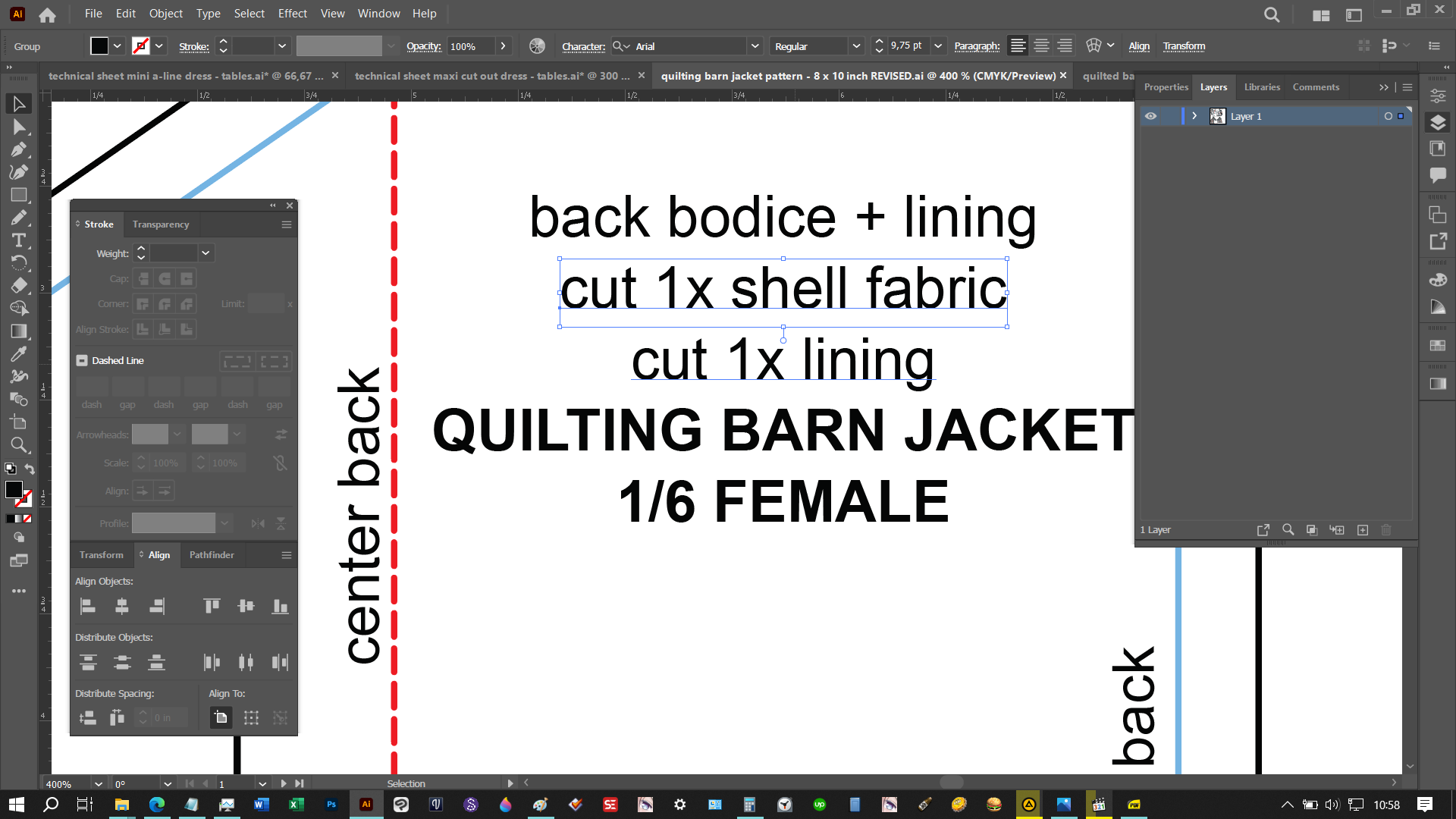

Ohh I see, then currently there’s no way to export the text as text?
Just in case we have a miscommunication, this is what I meant by export the text by text, I can directly edit the label text
This is what the export currently do, the text is converted into path
Yes, I see that it does the same on mine, even in Inkscape :sob:
