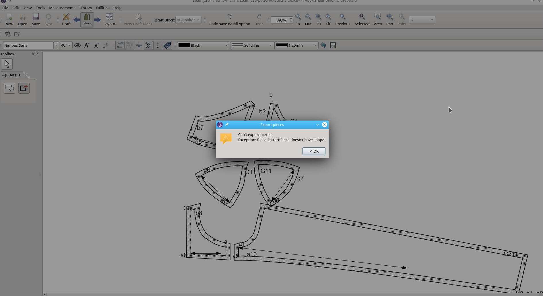

Hello, I’m having trouble exporting pieces to layout, it gives an error: “You can’t use Layout mode yet. Exception: Piece PatternPiece doesn’t have shape.” I checked forum and found it could be a problem with checking “Hide seam line”, but it is unchecked in all pieces. Version Linux AppImage, I updated it today. Can somebody help?

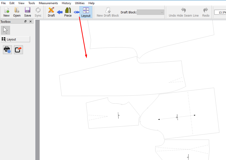

I’ve just checked the Layout Mode on my Windows 10 (also on the latest update) and it’s working:

Thank you! I checked, all pieces are included in the layout. I tried to export directly from Piece mode, the same mistake. When trying to go to layout mode, it stays in pieces mode, showing the same mistake. Linux version looks a bit different. Export pattern to layout doesn't work - #2 by Grace
