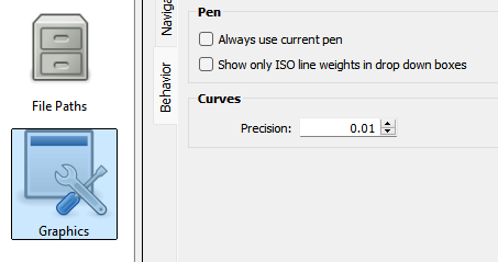

OK… here it is. I added a “Curve Precision” pref with a min value of .01 and max value of 1.00. Higher the value, the more precision.
I tied the precision value into the Wire Frame toggle.

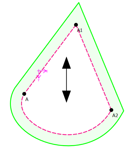

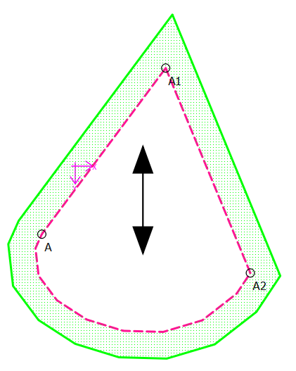

Screenshot 2025-04-11 162405

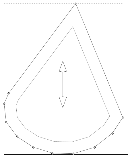

When the wireframe mode is toggled on, the precision value is used:

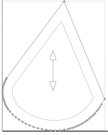

When toggled off a max value of 1.00 is used.:
Which then yields the following DXF exports respectively:
