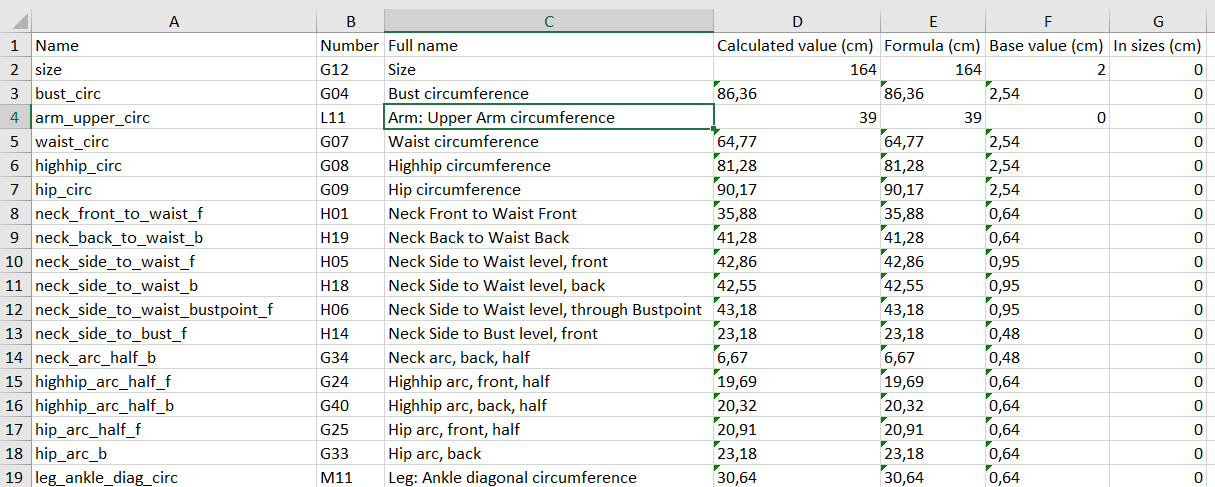

When copying and pasting I got something like this:

What’s happening is that Excell reads the comma as a column break and you have the comma set as your decimal point. So every time Excel sees the comma (especially in a comma delimited file) it will split your number into 2 columns. I think it’s best that you go with the Export to CSV option if you don’t want to change to a . decimal breaker in your operating system’s preferences.
Good day,
Even though I’m not very good, I’ve noticed that the columns are exactly aligned when I use TAB. and when I choose a COMMA, the information changes, and a column is created for every text that comes after a character like a comma or a semicolon.

thanks, Grace I only was able to change that today,… I didn’t know how to, but thanks to Ancle google.

Oh… that’s just a row number… it doesn’t belong to any given measurement. If you move a measurement it will have a different row number.
No, I wasn’t refering to that number. I was refering to the number that’s boxed in green:
Which, to me, should be like the Q01 above. I think the na should be in it’s place in the 1st column, But, hey! I could be wrong :grin:
I always use the TAB option when exporting directly to Excel. The comma can be edited in the file in Word, but it’s the long way around. So stick with the Tab option :smile:
