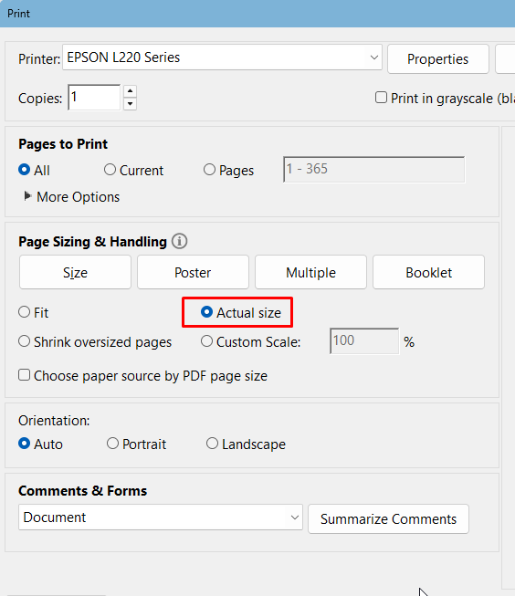

However, if you have the Seamly pattern, then you may as well generate the pattern into the size that you want directly. The most important is that when printing, make sure that the printing is set to “Actual Size”:

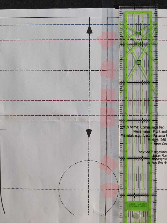

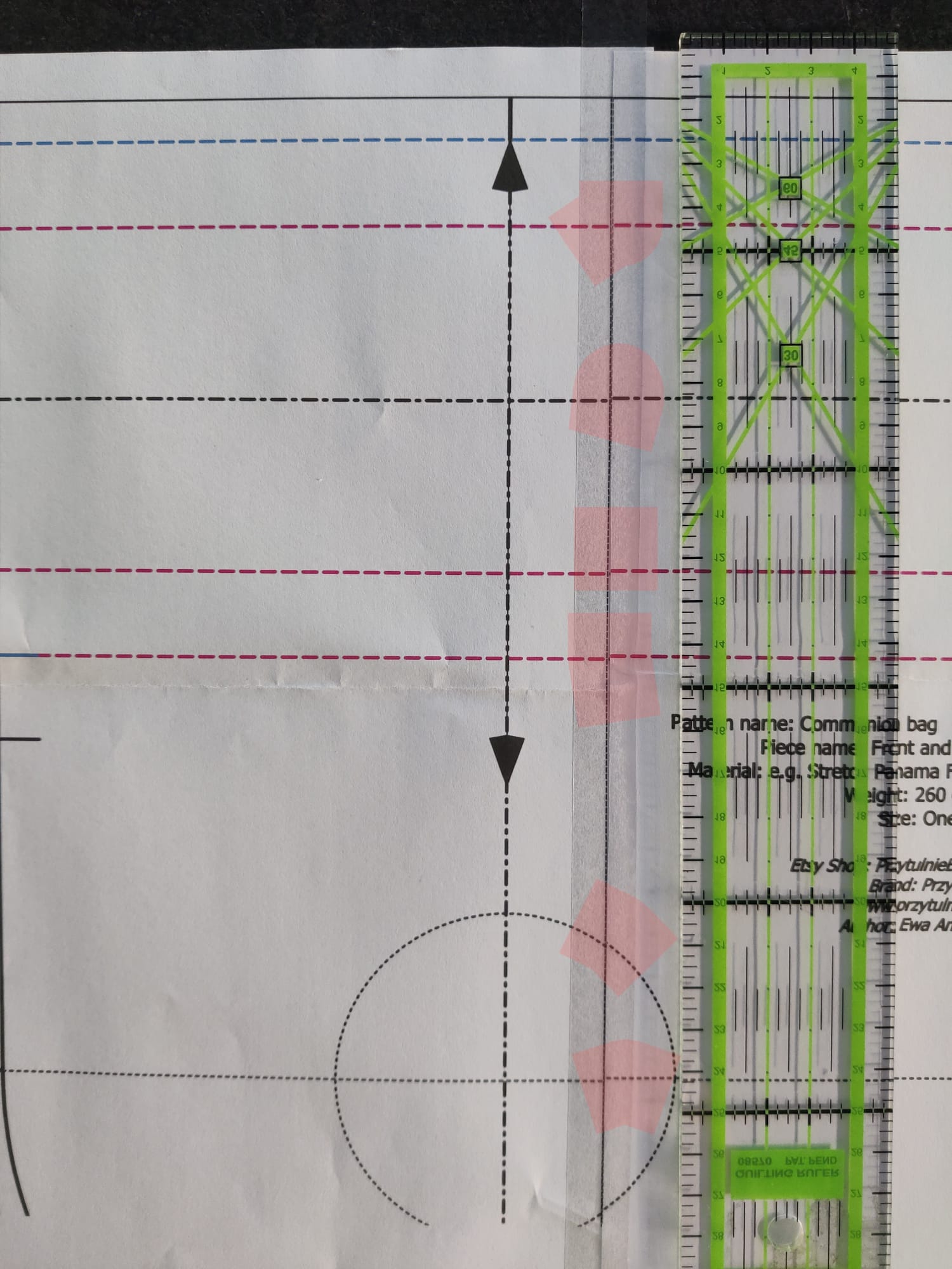

Well, I went to Docuslice hoping that it will solve my problem and here it is… I’ve generated tiled pdf from Seamly2d and when printed the dimensions are shifted relative to each other even though the control square has the correct dimensions. It’s only 1-2 mm but still pages don’t match. On the other hand when I print directly from Seamly it’s ok. I’ll add photo.

Thing is though in your picture it does not seem to be an issue with the margins (per se), but rather the 2 pages are not printing at the same scale.

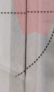

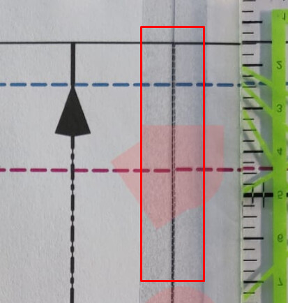

If you check the vertical line where the 2 pages meet, the pages are joined with a very slight difference between the top of the page and the bottom of the page. This will put the lines out of sync:
You can see that in the top picture, which is at the top of the page, the line looks thicker than in the bottom picture, which is at the bottom of the page.

Not an alignmnent problem… clearly the left page is larger than the right page. Each successive horizontal line is off by a little bit more.

Again… that’s not the problem in the picture. The 2 pages here are not primted vertically at the same scale. Has nothing do with the overlap.
