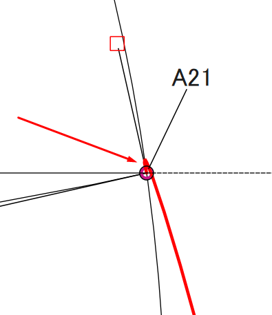

Try correcting the curve handle at A21:
tomomi pants.sm2d (8.3 KB)
Yup that can do it. Not sure why loops in a curve? Probably stuck in some recursive calculation. Will have to see if it’s in the tool or in the pattern piece.
