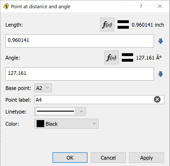

Seamly2D uses dialogs to enter formulas and numbers while drafting a pattern. When I open one of those dialogs, I almost always want to type a new number of formula into the first available text field.
Current behavior : The cursor moves to the OK button. The user has to click to focus the field.
Desired behavior : The cursor automatically moves to the first text field and selects all of the text in the field. For example, in the “Point at Distance and Angle” dialog, it would select all of the text in the Length field automatically.
DSCaskey suggested that I do this with a user preference to not break current users:
Add a group box “Dialogs” to the Graphics->Behavior, with a checkbox: Set focus to first formula field.
The default behaviour would continue to be that the focus goes to the OK button.

This won’t happen if the focus is initially set to the 1st field. OK is the initial focus as this is the normal default behavior for dialogs. That’s why I suggested to @anteater to make this a user preference option to set the behavior. Also if the text is highlighted, pressing Enter (or any other keyboard event for that matter) will delete the text - unless you put in place an event filter to grab a specific key event, handle it, and not pass the event on. That’s why the app currently places the cursor at the end - unhilighted - so that when you type you’re appending.
That’s also why the default behavior - at least in Windows- is that a double click on a field selects (hightlights) the text. Having a field initially selected is outside the expected norm. With the exception where the text is a placeholder that is expected to be replaced - like asking for a filename.

I was afraid that would be the case. Would it at least be possible for (only) the current object to be clearly highlighted? As it is, OK is highlighted unless Cancel or Apply are the focused object, & nothing else is. Seeing where the focus is would, if not my ideal, be fantastic.
Not sure what you mean? When an dialog object (widget) is the focus it is either highlighted - like buttons, or the cursor is placed in a text box. With a text box double clicking then selects and highlights the text. Having a text box automatically selected and highlighted goes against normal behavior, unless like I stated previously where the text is kust a placeholder that is expected to be replaced. Like in the New pattern dialog, where the default filename is highlighted. If the focus is set to the 1st text field in a dialog, and the text is selected, I can see a lot of users deleting what was there as soon as they type trying to add to the formula. One has to remember, while you might want to overwrite the initial length that the tool visualization created, but you dont want that behavior everytine you edit the tool. You will just have the opposite issue, where you need to remember to click in the blank space to turn off overwrite mode for the text field. It’s why I suggested to @anteater to make any change in behavior an option, with the default pref left the way it currently is.
Also I prefer to leave OK as the initial focus on tool dialogs, as many times for those new tools that pop up the dialog simply needs to be saved - OK’d. If the 1st text box is the focus, now you have to remember to double click OK, or once before hitting enter. Again the default focus of dialogs is generally to do no harm or loose data , thus OK is focused, and you have to make a conscious effort to exit without saving, either by selecting cancel, (Window) close or hitting Esc.

I mean highlighting the object, not highlighting the text of the field. On my computers, there is a special blue/cyanish border around the OK button unless I tab through the objects to the Cancel or Apply button, in which case they gain the highlighting frame. But there is no indication while tabbing through of which object is in focus, (except the little stick cursor when a text field is in focus,) & the highlight around the OK button is making it look like hitting enter should press the OK button. A bold/colorful outline (highlight) around the object in focus would make the tabbing experience more intuitive.
But as to selecting the text, though that would be my preference, having the cursor active in the first field, like is the case with the Move tool, would also be a sight better than the current state of affairs, & I hope the preference would be between Move style dialog action in all the dialogs and highlighting the text of the first field.
