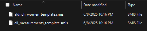

If you wanted you could create an M&S template of all the needed M&S measurements from the known list. There’s already a template in the samples folder for all the knowns and the Aldrich womens:

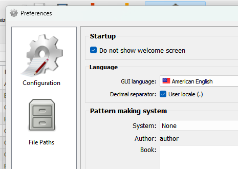

If it’s truly connected to nothing in the backend, what about removing it from the software ? I think it could confuse new users by making them think that Seamly already “knows” how to draft some patterns (maybe it will in the future?).
I wish I had been involved with the app early on and I would have suggested that there should just be an ME template for each PMS, rather setting a PMS pref. The PMS pref is just odd way to create a messurment file - even if it did function. Again IMO as it is it’s just annoying - epecially since all the systems, authors, and books have to be translated - some of which were causing issues when I was using Google to translate a whole doc.
That being said… @Grace brought up the point that the M&S system uses all those abbreviations for measurements, which would take a lot of work to add another VMeasurment class member to include another column in SeamlyMe, the Variables table, the FX Editor, bumping the schemas, and whatever else I’m not thinking of.
IMO… yes it should be removed. I was even confused by it when I first used rhe app. And like I said it’s just more to translate. I would take all the info and put it on the Wiki as reference, becasue that’s all it is. It’s just a list of PMS books.
Even if it did something, it should be a choice you select when you create a new measurement file… but then the standard way most apps work is you load an empty template.
This is what was desired. Then it turned into what it is. The patternmaking system preference was supposed to a preference in SeamlyMe (not Seamly2D) so that when we create a new client’s measurement file, it pre-selects the measurements for a particular patternmaking system (for students and followers of particular patternmaking systems) or if would select your own custom measurement template.
The point was to avoid having to select the list of the measurements we want every single time we get a new client. It was supposed to save time, and support learning.
It is now that I moved it.
Yes… and that’s why you use a template. You can take a base template, add your own customs, and save as a new template. The PMS “pref” thing would not accomplish this. We just need someone to take all those PMS systems and create a template. :slight_smile:
