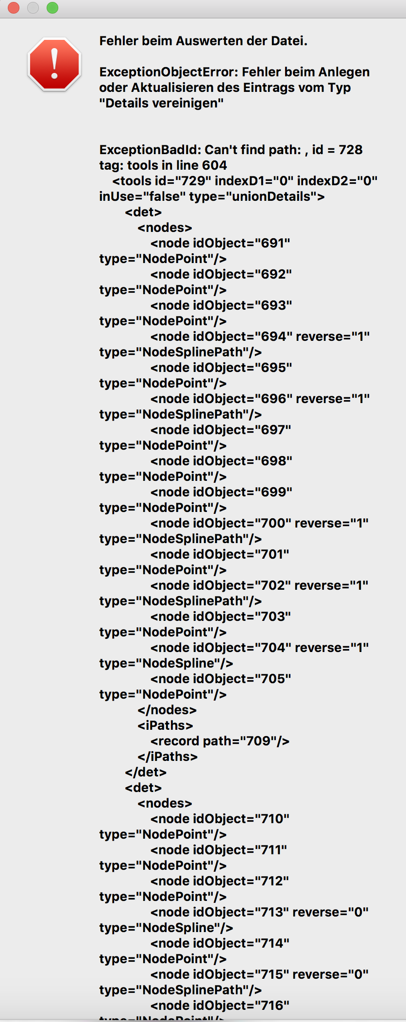

Fehler beim Auswerten der Datei - ExeptionObjectError
Hey there, I hope someone can help me with my problem. I’ve done a pattern for a shirt which I’ve worked on for hours and hours. That pattern has ben saved but as I’ve restarted seamly2d, its not opening anymore, instead it shows me a long list of errors which you can see attached.
Pls. does someone now what to do ?

Hi Philip… if you can post your pattern and any measurement file here, someone here can take a look at it. Odds are we can recover most if not all of the pattern.

Hello and welcome, @philip
I have deleted an item that you used the Union tool to create, since this is the item that caused the error. I suggest that you create this item in draft mode by using one of the Mirror tools and then redo the pattern piece:
I tend to shy away from the Union tool since it’s a bit ‘iffy’. Sometimes it works beautifully & sometimes it does this.
And while I was checking your pattern, I noticed that your seam allowance wasn’t squaring nicely at point A70. The reason for this is because your curve doesn’t connect to this point. I’ve added A75 on the curve and put it in the correct place on the pattern piece. Now the seam allowance is nice & tidy :grinning:

Of course it was the Union tool - as I suspected. ARRG. I really need to track down the issue with the Union tool. I would think it’s a reference/ dereference thing.
