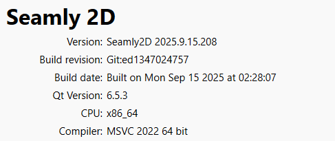

I am having this File Exception error every time I create a group. When I close Seamly and reopen it to continue work, this error pops up. It only happens when I create groups. I have updated to the latest version, and it still happens. File attached.

Somehow the file got really mangled with the < group > s at the end of the file. Do you recall what version you had before you updated? We had an issue with one release where the groups tags were written out of order with the new images tags. It has been fixed in the app, but it doesn’t fixed broken pattern files.

Thanks for fixing the file. It now opens without any error. I cant remember the last version. I regularly check updates via Help > About Seamly2D > Check For Updates. It would be the version before the current release. Once again a big thanks to you and the Seamly team for this great software at no cost.
