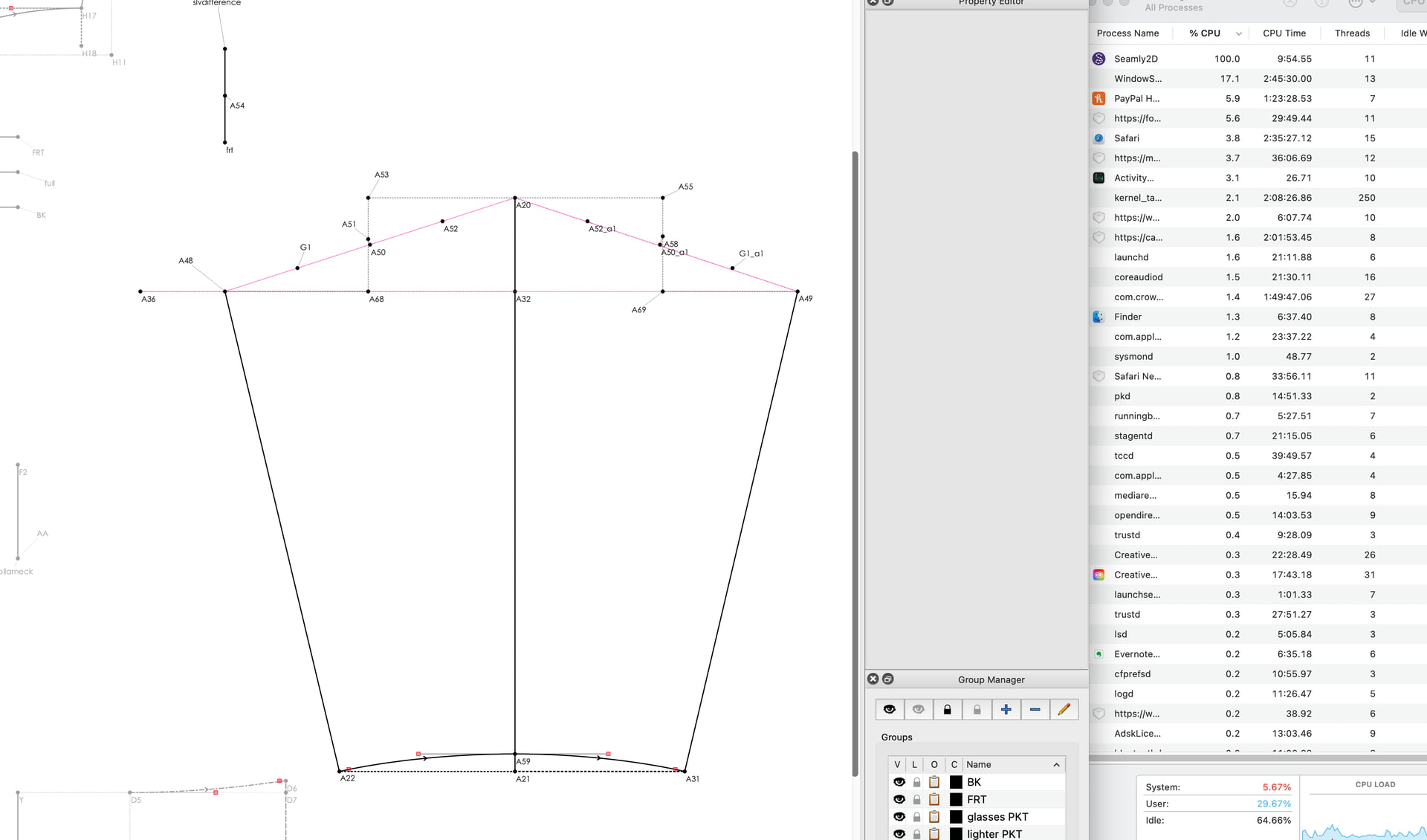

I know that there was a problem with someone else on Mac that had a problem with the CPU running at 100% which was slowing the program down but I can’t find it right now.
Did this first start happening after you created the sleeve cap curve on sleeve? I see that it’s the item that you’re currently working on and I noticed that the last handle is pointing in the wrong direction creating an S when zoomed in. I’m wondering if correcting this won’t speed up your pattern since it’s only giving problems when you work on a spline?
think so. i think that’s corrected now and i just tried to add nodes to FRT/BK piece and it crashed again. dain jacket.sm2d (81.3 KB) dain 031224.smis (2.1 KB)

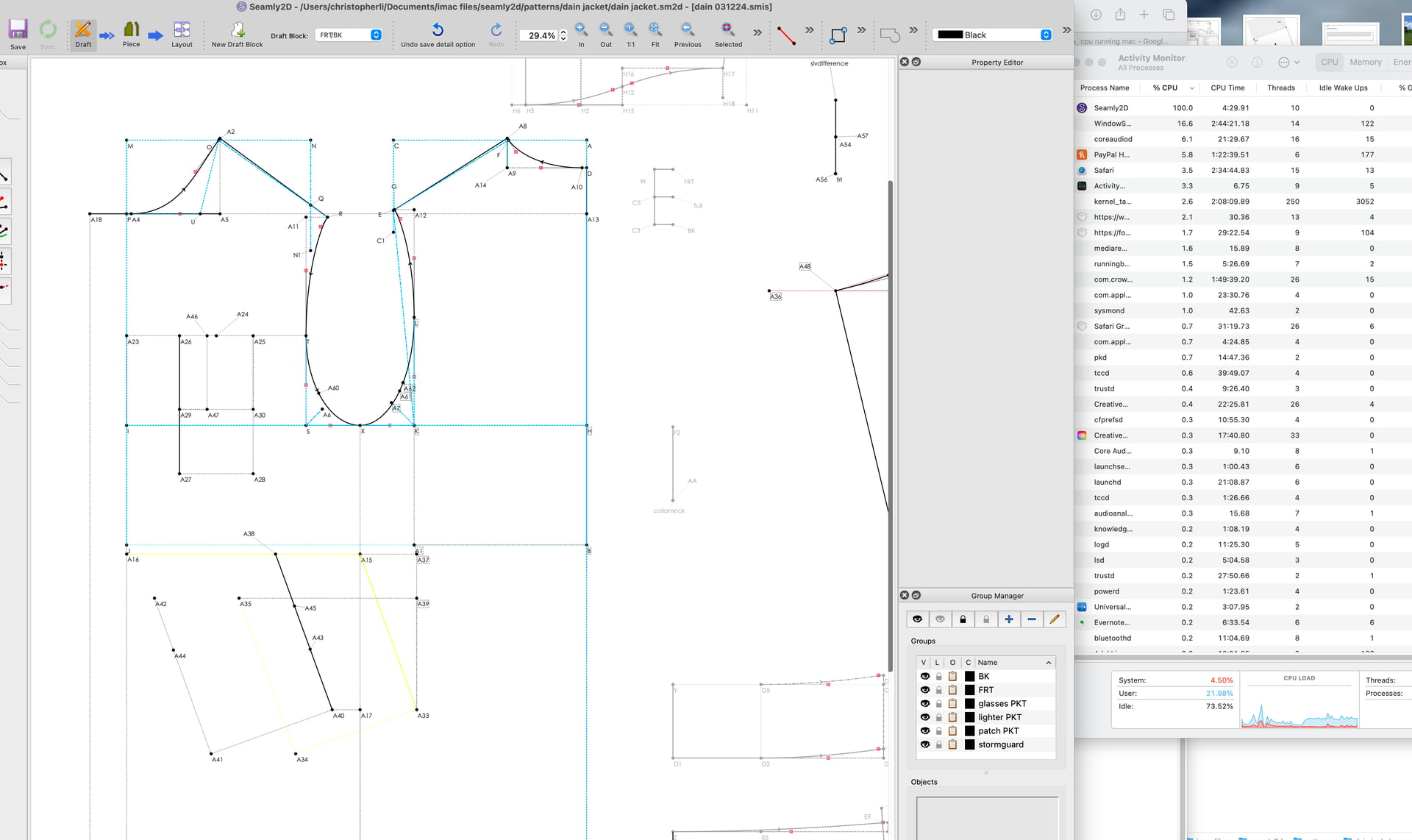

Do you know how to check the running capacity of your CPU?
yes. through activity monitor?
as soon as i switch to seamly window cpu goes to 100%
when i switch to piece window cpu usage goes way down.

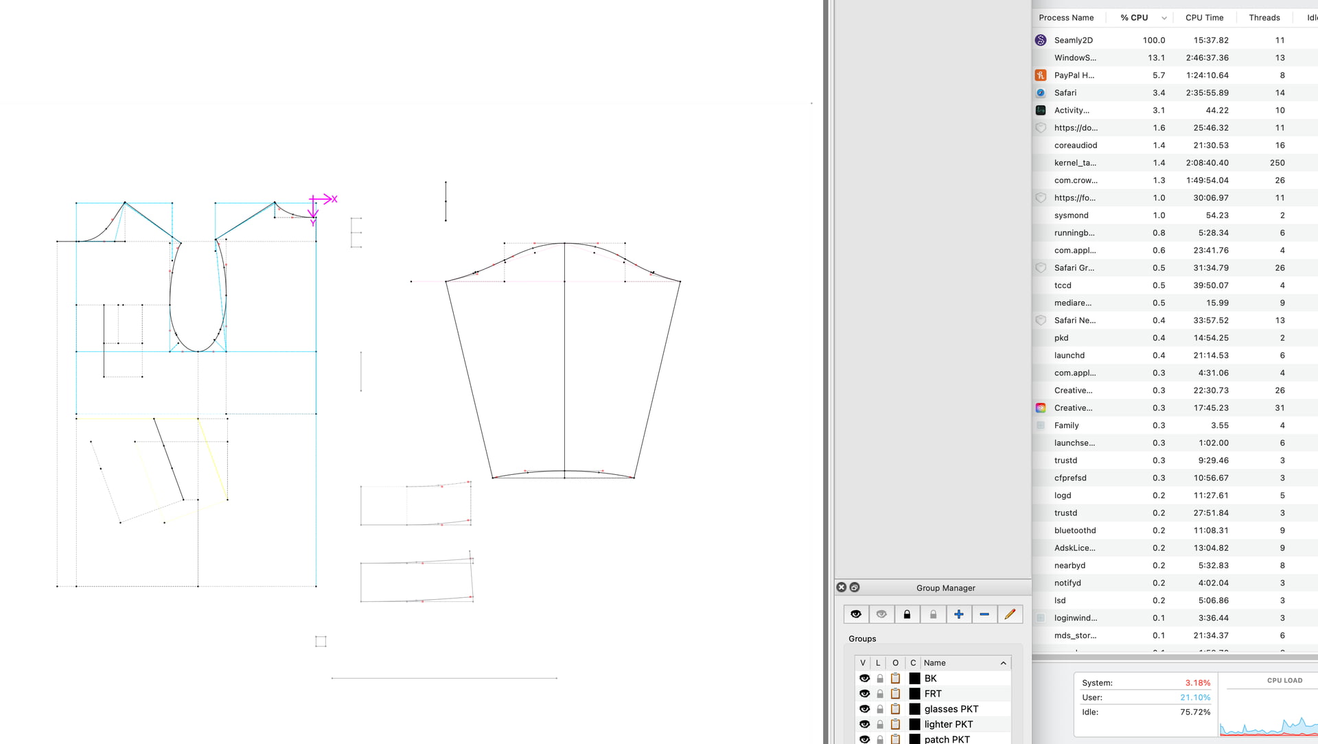

And if you delete the original sleeve cap curve line? The one in black?
deleted it’s still the same.
Ok, you can redo the sleeve cap curve & delete the Hood Side pattern piece & check, please?
same.
On your test pattern, delete all of the pattern pieces & see if it’s still running at 100%, please
all the pattern pieces or blocks in drafting?
