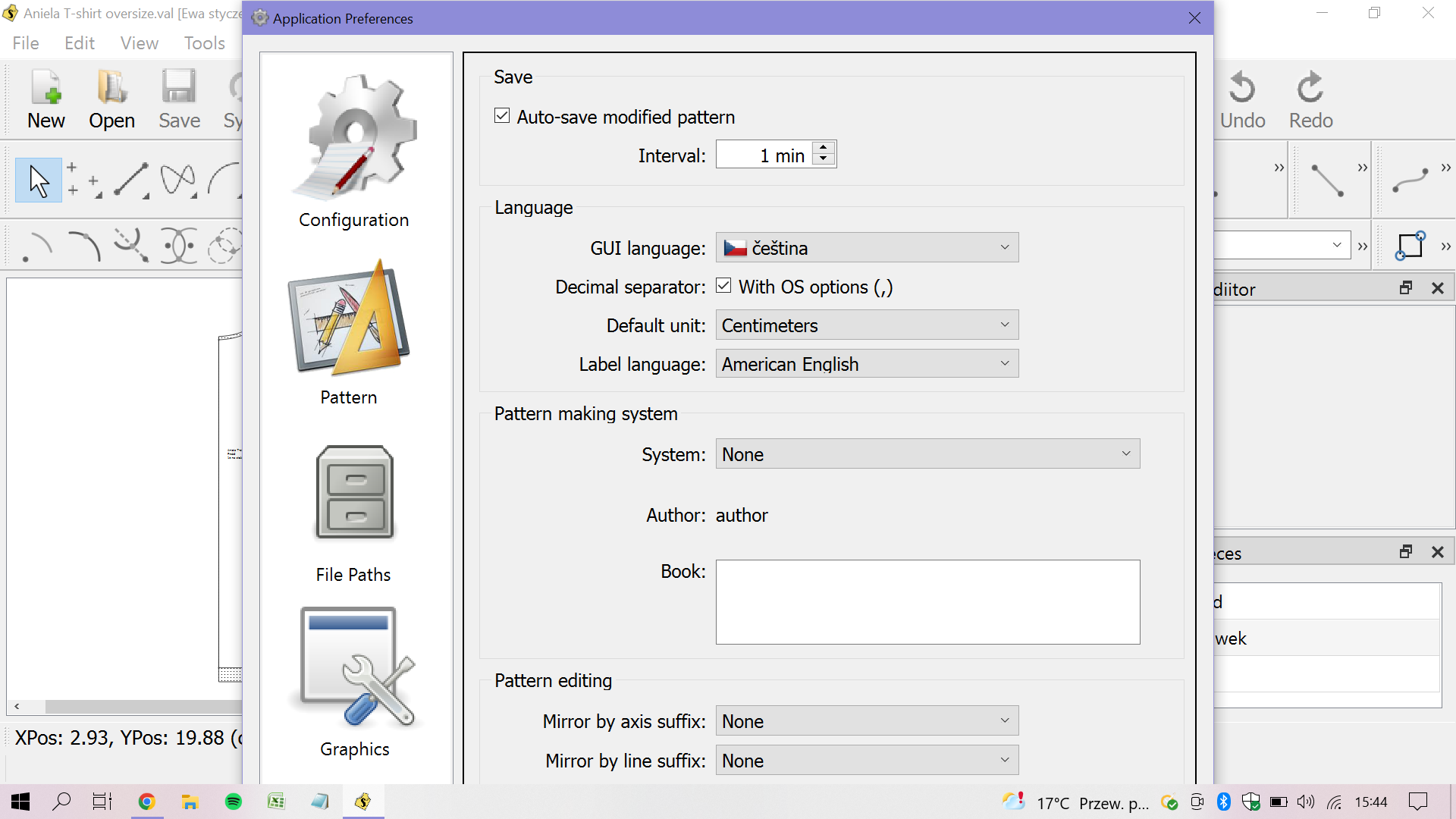

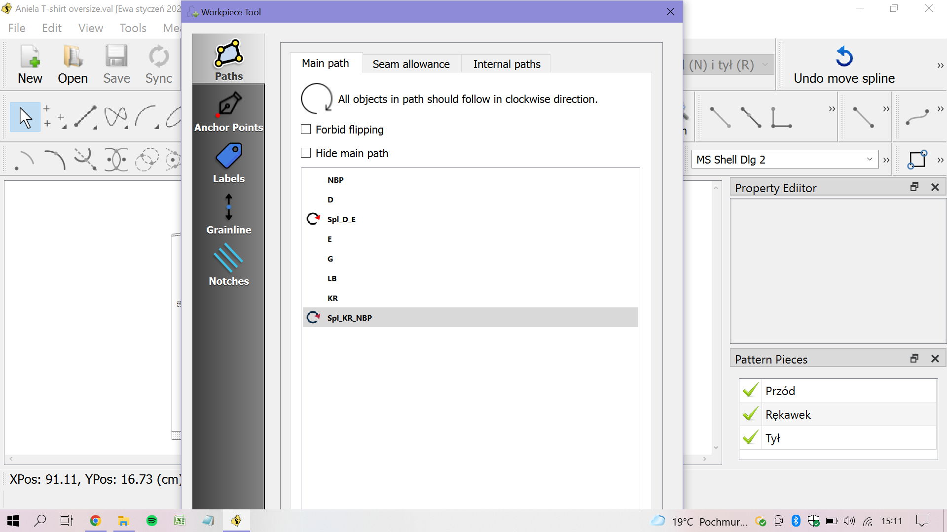

Hi! It seems like I am having the same problem as David had, but the provided solutions do not work. When I open any window (settings, piece details etc.), the buttons at the bottom are hidden (covered). I know that they are there, because if I drag the whole window up, they are visible. As soon as I let the window go, it goes back to the previous position though. I did not find any similar problem, that is why I am reviving this topic.
It seems odd that the UI in Seamly would be so much more massive than the System UI. If you would post the release date of your copy of Seamly2D, (Help menu, –> About Seamly2D,) that would help narrow down what the issue might be. Also which version of Windows you are using could have some effect.

@Grace @Pneumarian thank you for your help! Hovering the cursor over the top corner and dragging solved my “issue” :smiley: Such a simple solution, I think I had a brain fog and just needed someone to point it to me :stuck_out_tongue: I tried it on multiple different windows and it worked on all of them. It takes some skill to position the cursor well, but it is doable:) Just for the formalities, I use Windows 10 and recently installed the latest updates of Seamly2D (January 2022). The “issue” was present before installing the updates. Plus, I have a rather small screen that I work on (14’’), I do not know if that is relevant.

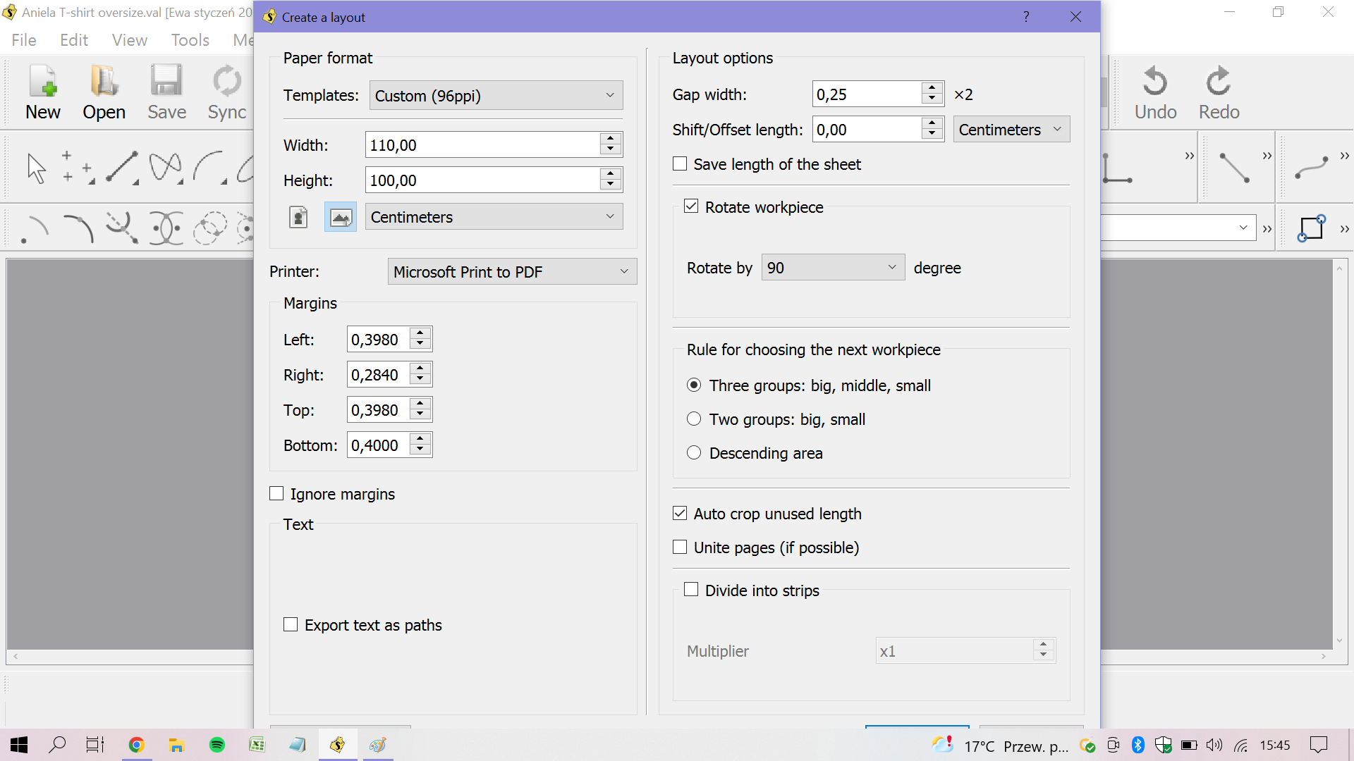

@Grace Ok, I got too happy, too quickly. I found two windows that cannot be downsized in the way that you instructed me - the application preferences and the layout window. Do you have any idea why is it like that?
Hmmmm… I see what you mean. They don’t get the little arrows for me neither. On mine, the popup window fits within the screen, so I don’t have the same problem.

In the meantime, @EwaJ, if you use your tab key to move from one section to the next, it will eventually land on the OK button where you can press Enter to accept the changes. It should be the next one after the last blue highlighted option.
Because the screen resolution is smaller than the height of the dialogs… and the application’s main window apparently is not in a scrollable area. If it was scrollable you would simply be able to scroll the main window exposing the dialog buttons.
@Grace @Douglas thank you both for looking into this matter! So I guess it leaves me with using tab key to reach the right button for now. I am glad that we solved the piece details window though, it was the most frustrating one :smiley: Many thanks!

Very good point, @Pneumarian. My screen setting are set to 1366x768:
