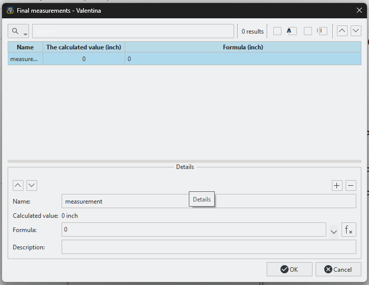

I started Valentina and then changed to Seamly2d, because I was told that Seamly2d still does updates for Mac.
My question: In Valentina you can check your pattern measurements under “Measurements>Final Measurements” I love this option because you can verify whether some measurements of your pattern still fit the body measurements. A double check, so to say. But now working in Seamly2d I cannot find this option under Measurements. Is it somewhere else or should I work differently?
I hope someone has any idea! Thanks!
Best, Margaret
I have not played with that function in Valentina, but I assume it’s to create formulas… such as the arm scye length of the bodice and sleeve cap so you can compare the 2?
Sorry… Seamly does not currently have this feature - it was added to Valentina after Valentina and Seamly forked.

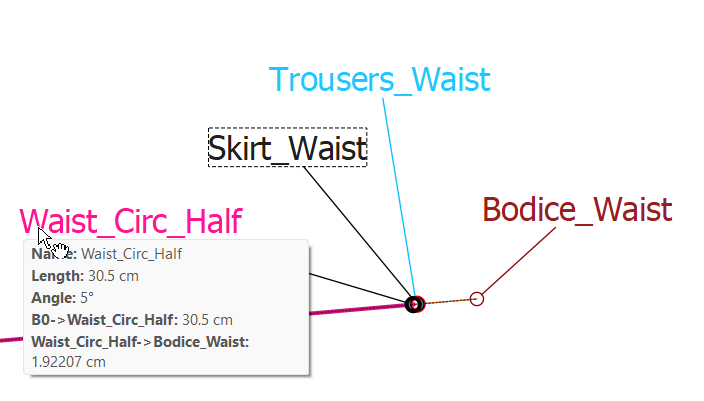

I do various checks manually inside the pattern so that I can see at a glance if the various different areas are measuring correctly for the patterns that I’m making.
Here is one where I check the bodice waist measurement to the trousers and skirt waist measurements:
As you can see, the skirt & trousers waist don’t have any ease while the bodice has almost a 2cm ease on the half waist measurement.
In this one, you can see that the sleeve cap curve is 2.5cm larger than the armhole curves.
I normally hide these in an existing line in the pattern.

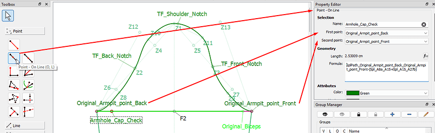

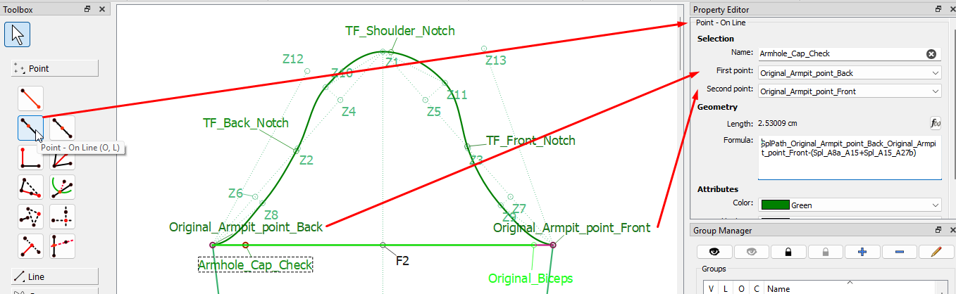

Hi it is me again! I found an old topic explaining this issue. But you mentioned this: Control measurements - #4 by Grace And I think this would be helpful. Can you explain how you did this? Thanks so much!

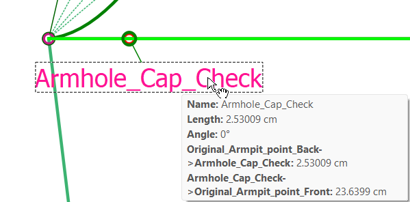

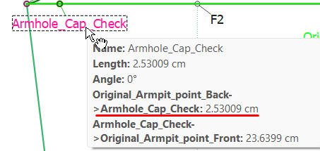

I used the Point on Line tool from anywhere to anywhere in the pattern that would suit. In this case, I used the 2 underarm points on the sleeve. In my formula, I took the sleeve cap curve minus the 2 armhole curves (added together) as the formula:
“SplPath_Original_Armpit_point_Back_Original_Armpit_point_Front-(Spl_A8a_A15+Spl_A15_A27b)”
And I gave it a name that will tell me exactly what it is - so that I don’t forget :smile: At a glance, I can see that the point is a small distance from the 1st point, and if I hover the cursor over the check point, it shows me the exact distance.

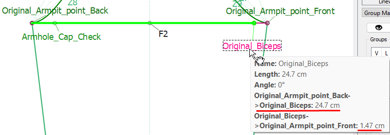

On the other side, I have a Biceps Check where I used a formula to insert the biceps circumference so that I could make sure that the sleeve will fit the upper arm when it sewn.
Once again, you can see that there is very little ease between the upper arm measurement and the sleeve cap width, but this is set to be sewn in fabric with a slight stretch, so I think it suits very well.

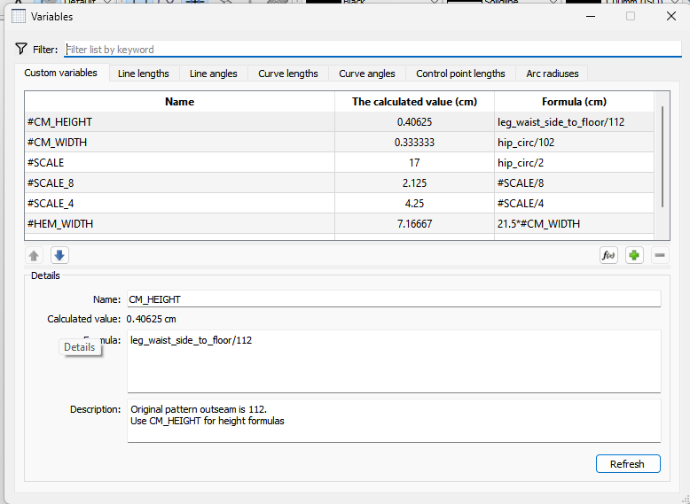

Hi Margaret,
Yes… I played with Valentina and looked the Seamly source code. I would tend to approach it a bit different. I would tend to add another tab in the Variables table for “Formulas”, as the Final Measurements is just duplicating some code of Variables Table. Also I think creating formulas could be more interactive… like having an FX insert tool where you just select the objects you want to put in the formula, and the formula is created without having to open up the fx editor.
