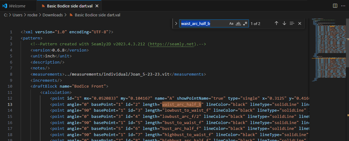

I would just use the Atom editor since I’m glued to it almost everyday editng code. I can search / replace within a file or across whole folders.
Other editors like Visual Studio are just as capable.
Code editors also have the advantage over NotePad of displaying the line and column numbers so when an error message says it found a pattern error at line 65 col 77 you can easily find the error spot.

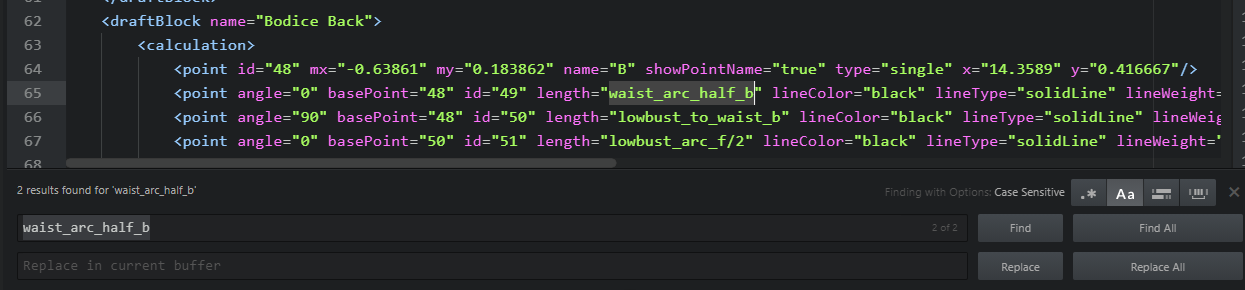

NotePad++ also works well in these respects, including multiple Find/Replace across files …
… just sayin … :wink:
