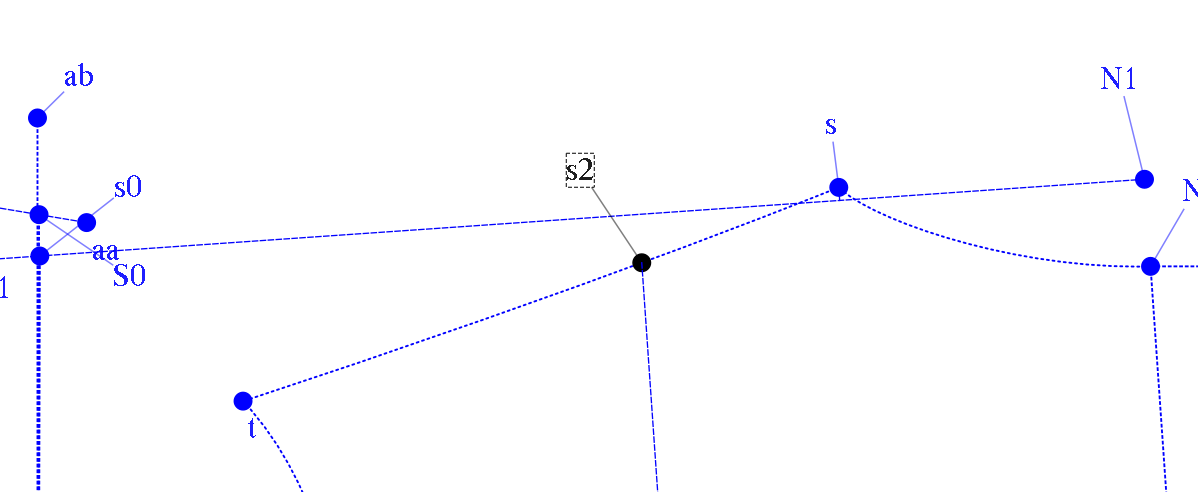

There really isn’t a category really where I could post my successes. So here goes. After much trial and tribulations and figuring out stuff I created my first pattern to an existing persons measurements. The system I have learned is in no way geared towards being able to be digitalized. But I now know how I can do it. I printed the pattern out and made the first sloper. I now how the pattern for this person needs to be adjusted. I might have made nearly one hundred items for her (in over 25 yrs). After fitting I duplicated the .smis file and made the required changes to it. Saved it as version two. Duplicated the .sm2d file and loaded the version two .smis file in to it. And voila, work was done. Now gluing it together takes as much time as drawing a complete pattern would take, so it is not much of a time saver. (I can draw a complete pattern in about 20 minutes). Only one hickup, one of the dots has turned black again, it is created by Tool ‘point on a curve’ which does not have a color property (only a name, a curve and a length). So I can’t even make it blue… But I’m not grumbling. Actually proud.
This is the code from that s2 point from my .sm2d file, no color attribute. (removed the < and the />) point id=“72” length=“Spl_s_t/3” mx=“-2.01083” my=“-2.91042” name=“s2” showPointName=“true” spline=“45” type=“cutSpline”
10 minutes later: I have now confirmed that the tool ‘point on curve’ doesn’t have a color attribute and always renders a black point. (The same seems to be true for the tool ‘point on splice’ and ‘intersect curves’) Win 10 ver 2024.1.29.147

Right. That’s expected. Unlike drawing lines, curves are 1 curve (actually curves are a string of many points & straight line segments but that’s beyond the scope here)… the tool is Point on Line, not Segment a Curve. So there there is no seperate segments, and thus no attributes to give the Point - On Curve segment.

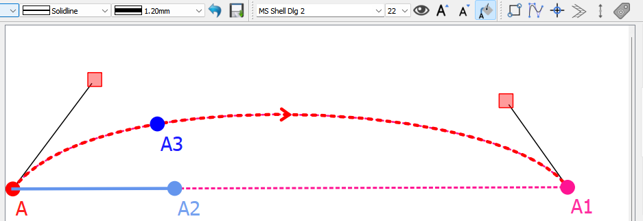

It’s black because you probably have the Point Names default color set to Black and all your tools are Blue with the Use Tool Color toggled On:
Screenshot 2024-02-05 004831

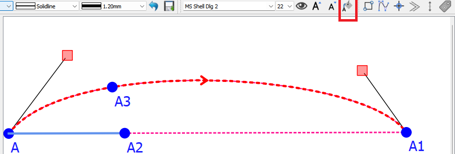

Mine is currently set to Blue so the when the point Use Tool Color is toggled off… the point names are always Blue:

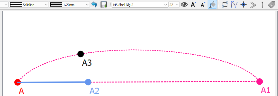

Toggle it on… and those points that have a tool color use the tool color:

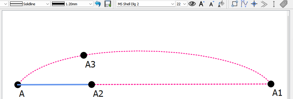

Change the default point color to Black and we get this:
Toggle the Use Tool Color off again and we get this:
