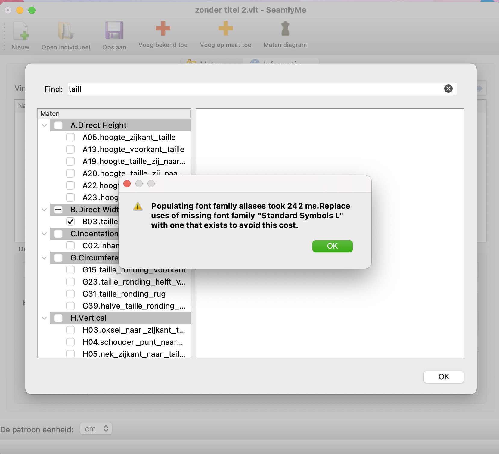

I also get an error when i make a new measurement table.
(hope i load the image correct) Last time i tried the program again and using the formula assistant, i think i saw the same error in a glimp before the program was shutting down. Normally i see nothing, just like @atay mentioned.
Ok let’s look at the error message first: “Populating font family aliases”
https://bugreports.qt.io/browse/QTBUG-87267

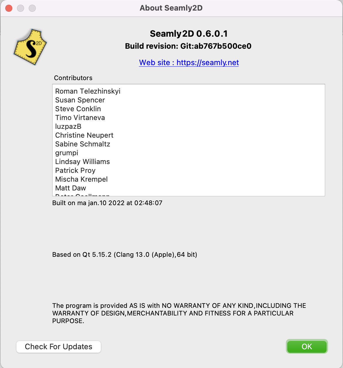

Apparently this happens when a specific font is referenced in the code. This error was supposed to be gone when we migrated to 5.15.2. @Karin - Look in your ‘Help/About’ and paste your screenshot of the About dialog: image image
Thanks for your message @Sue . Here is my screenshot.
The “missing font family” bug in MacOS was supposedly fixed in Qt 5.15.2 and also in Qt 6.0+.
However…apparently there are still problems.
This isn’t the main problem listed in this thread, but I think we can eliminate this one with judicious font replacement. I’ve seen some error reports that claim the problem can occur with fonts embedded in svgs (and we have a lot of these in SeamlyMe!)
I’ll experiment with changing embedded fonts in .svgs to ‘Sans, Arial’. This font is higher up in the font database, so it’s easier/quicker to find so that it won’t time out.
