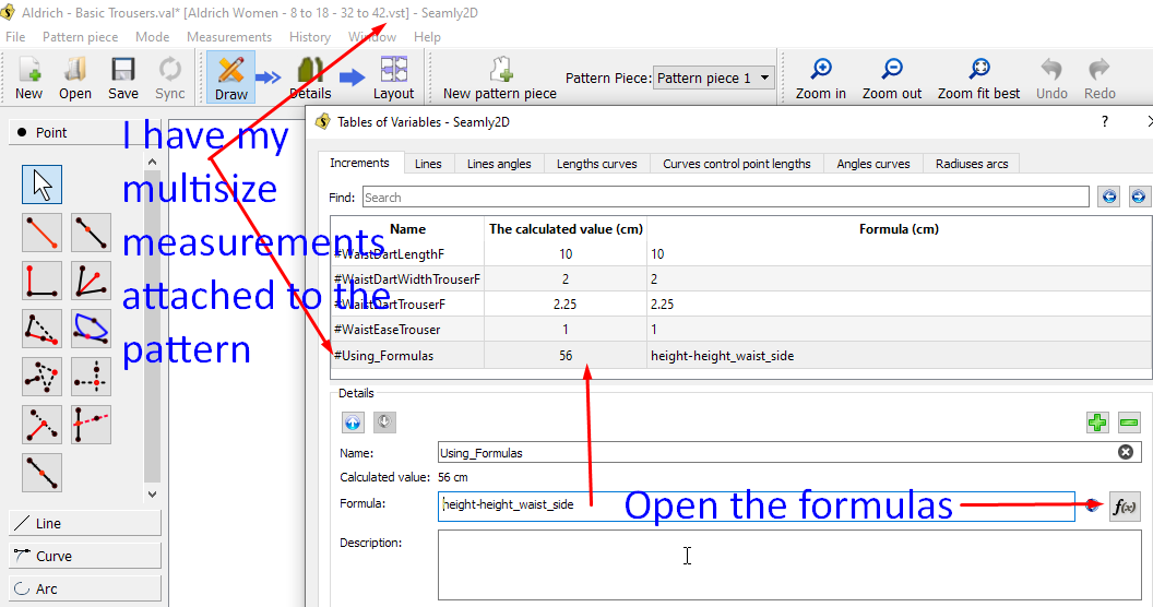

Here is how to do the formulas in Increments:
It works perfectly on my program :slight_smile:

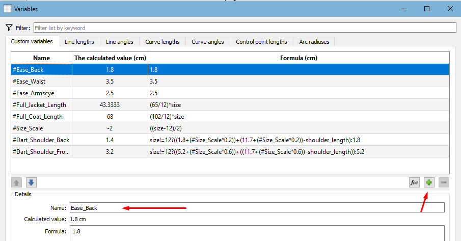

You can find the variables by going Menu>Measurements>Variables Table:
And then you can add your custom variables:
Once you have them all added (please remember that these are listed at the top of the pattern xml file, so don’t use references to lines, curves, arcs, etc.) , you can access them from the Formula menu while pattern making:
Variables are ‘extra functions’ that aren’t in your measurements file that you can add to or change from inside your pattern and are often formulas since, if you are working with a multisize measurements file, you can’t add formulas, only direct measurements and increments.
Variables are specific to an individual pattern, so no, they won’t ‘just pop up’. This is also one of the reasons that I have a master basic pattern that has all of this in it and save the master to a different name before editing and adding to it to create the design that I want, because my master basic pattern already has these variables in it, so they get saved over to the new pattern, as well.
