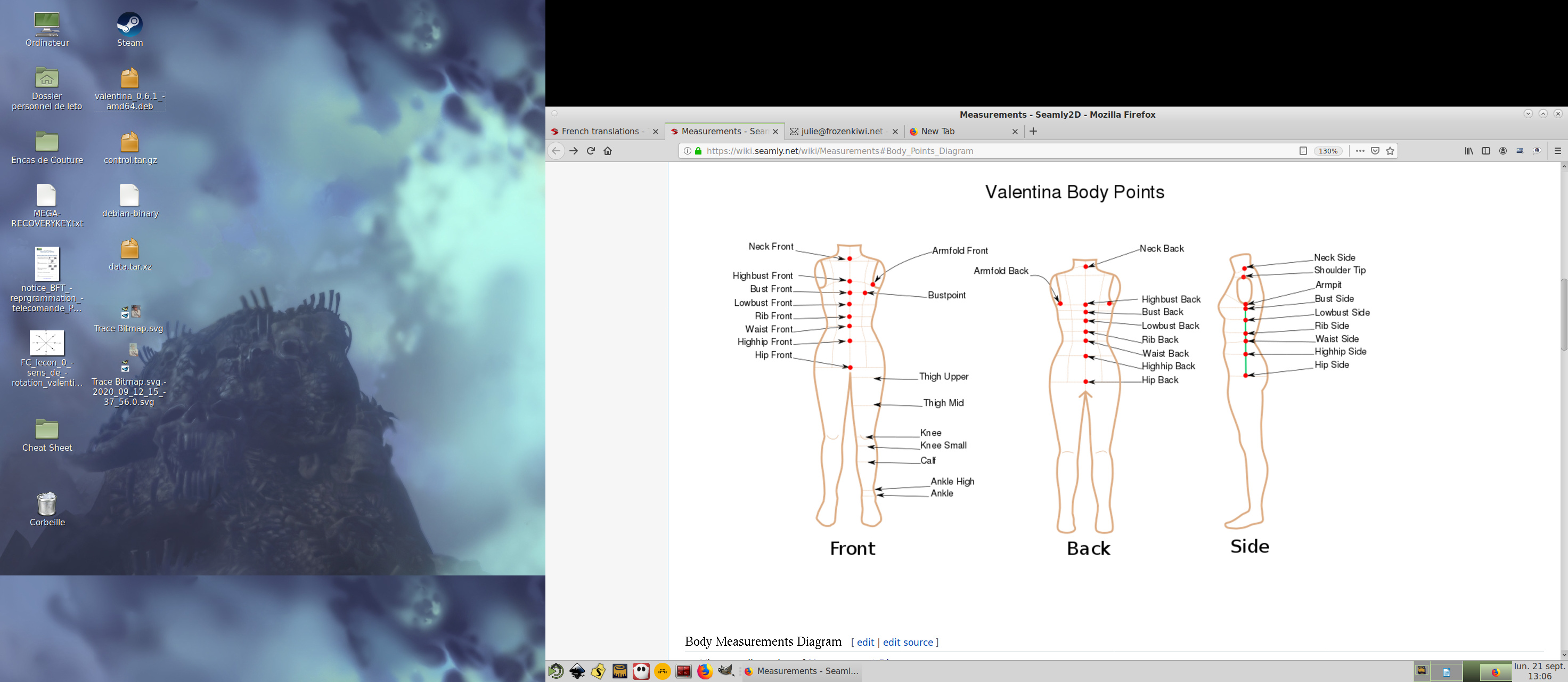

I am working on it, but I was especially looking for this diagram :
And I think I have the recent .pdf too, but I can’t find the post where I got it…
That is the one I used to make my first steps. I would have abandonned Seamly a long time ago without it :grin: I like it very much this way, but if I come with anything, you’ll be the first to know.

You can find all the diagrams and related PDF’s here: Measurements - Seamly
Just click on the image to open the SVG, right-click and save as to download it.
I’m sure any additions or removals would’ve been also made in the diagrams.
