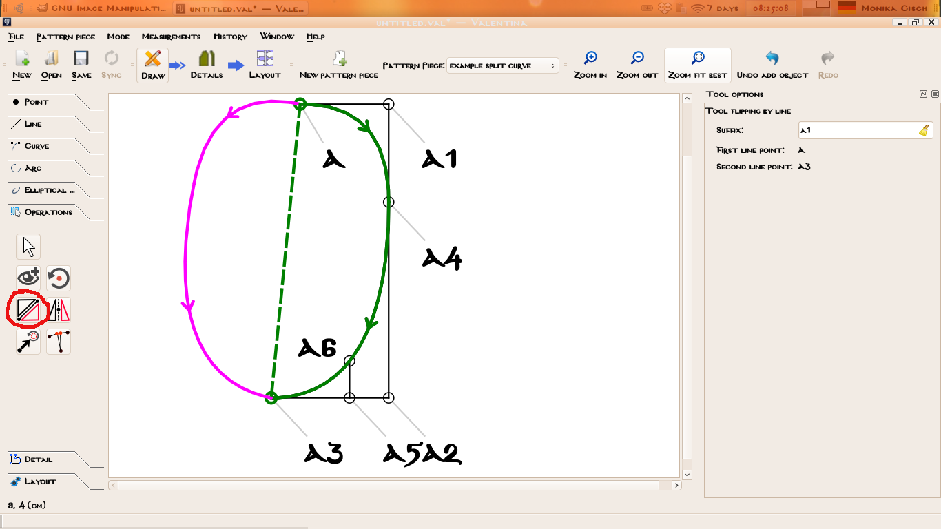

I’m working on a coat and I went to detail mode with all the separate pieces and I have a problem with the collar. With the method I use to draw pattern, I create half collar then I have to go to whack to cut it all, how can I do it?
Hi @ichogolab - Do you mean, how to use the Flip horizontal or Flip vertical tools?
Whack? :slight_smile: I guess you want to flip the collar, right?
Here I took flip objects by line
  1. click the tool
  2. select the object(s) you want to flip, here I took the curve. If you want to include more, click on every curve and point while pressing ctrl. Confirm with enter Important: do not include the points of the line that you want to take for flipping.
  3. click on the points of the line along which you want to flip the objects.
  4. confirm
