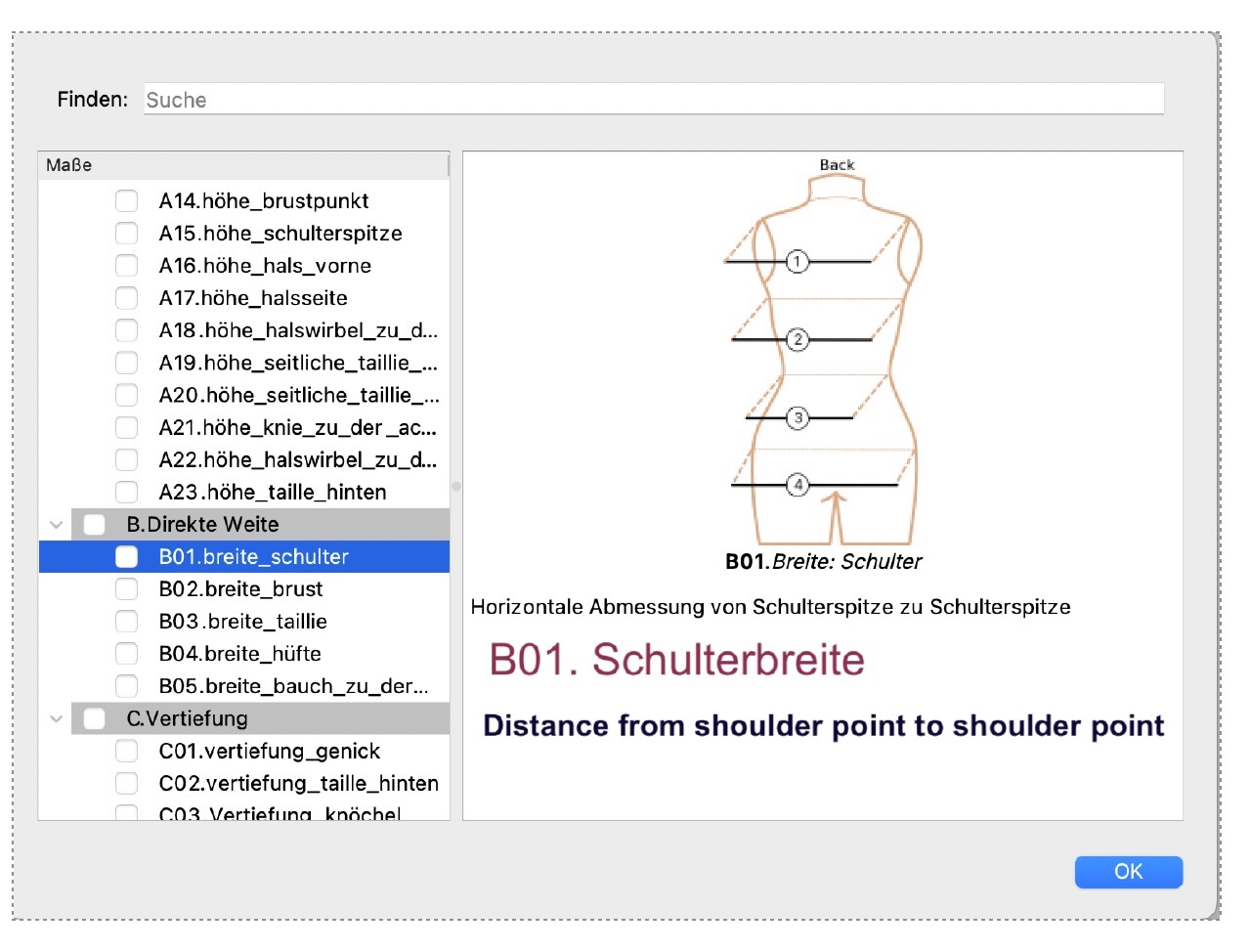

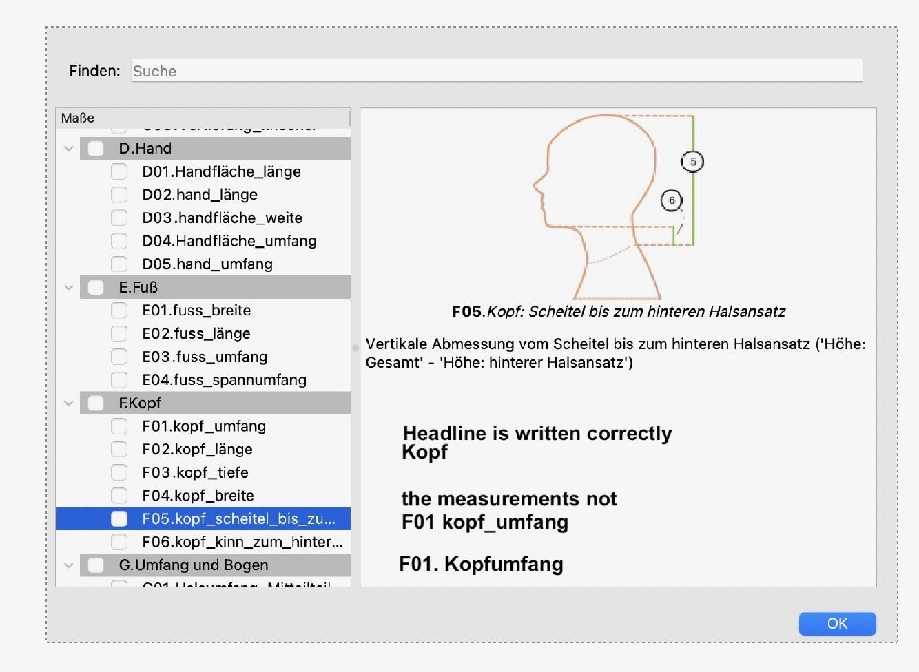

A friend of mine whom I introduced into seamly 2D begann to work with it recently. and asked me which petternsystem is the source of the known measureents in SeamlyMe.
I know that the patternsystem which I use from Müller und Söhne is not available in seamly 2D,
So I looked through it and couldn find any information.
But I came across some Translation mistakes (the never ending story of the german translation) sorry for that.
Attached find two screenshots as an example -
if necessaryit would be a pleasure for me to do the translation here.

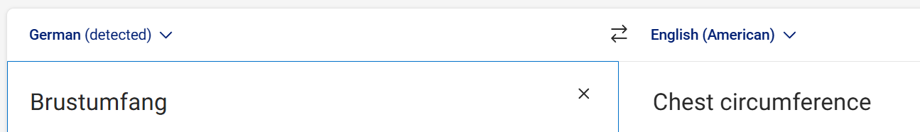

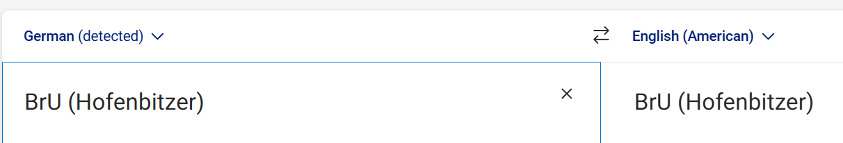

Using abbreviations is bad practice when translating as it makes it diffcult for someone else to figure out what something translates to. For ex:
VS
