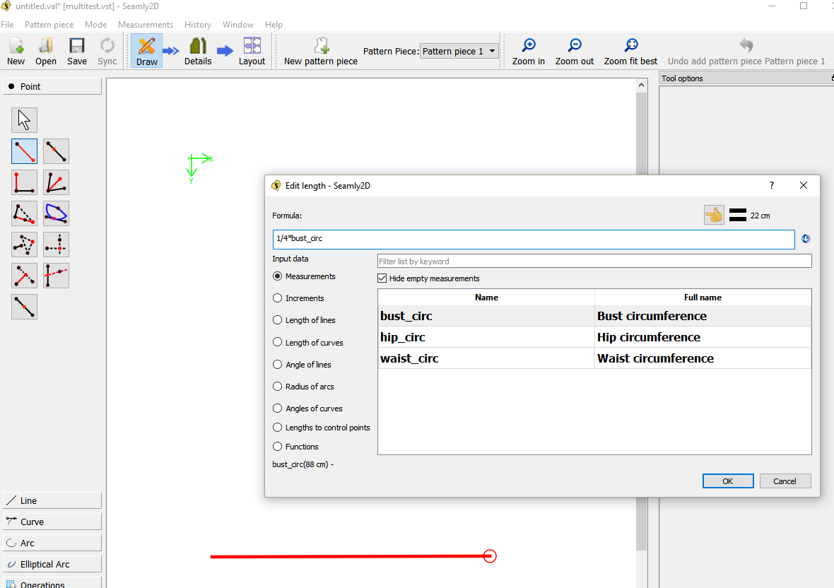

Tu dois utiliser les formules (par example 1/4*bust_circ),et pas les nombres (par example 1/4 * 88), ou ça ne va pas marcher.

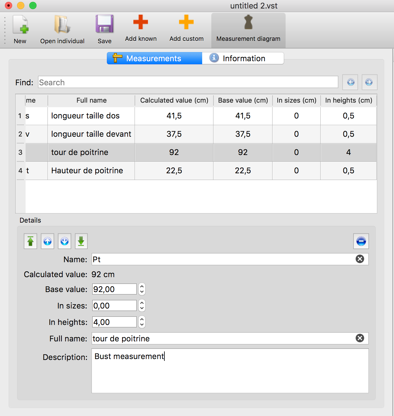

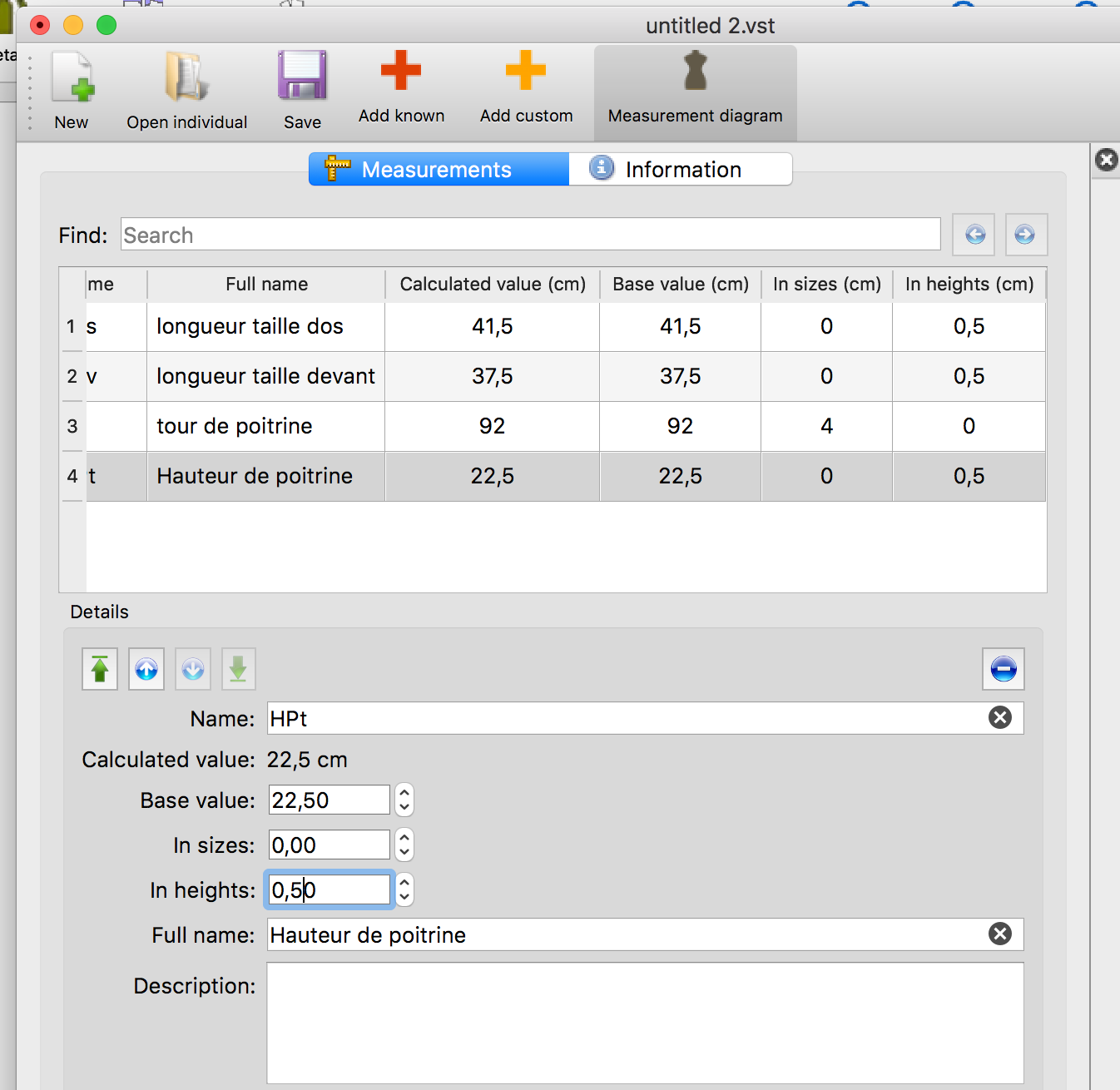

so this would mean that my gradation value or difference in value for any given measurement from 1 size to the next is to be filled in height be it for a horizontal , vertical or any other angle line or curve, and the size value will always remain 0.
that would mean that
this is wrong ( note the difference in values in line 3 of the measurements table)
and this is the right way to fill the table
did i understand you correctly?
