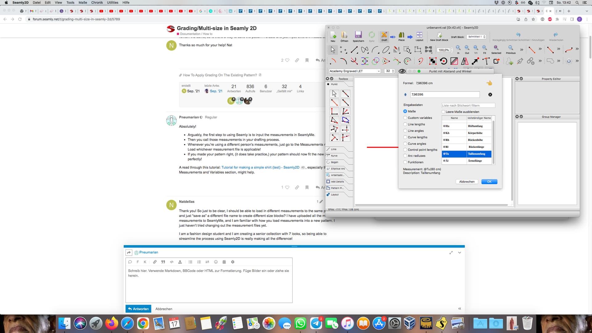

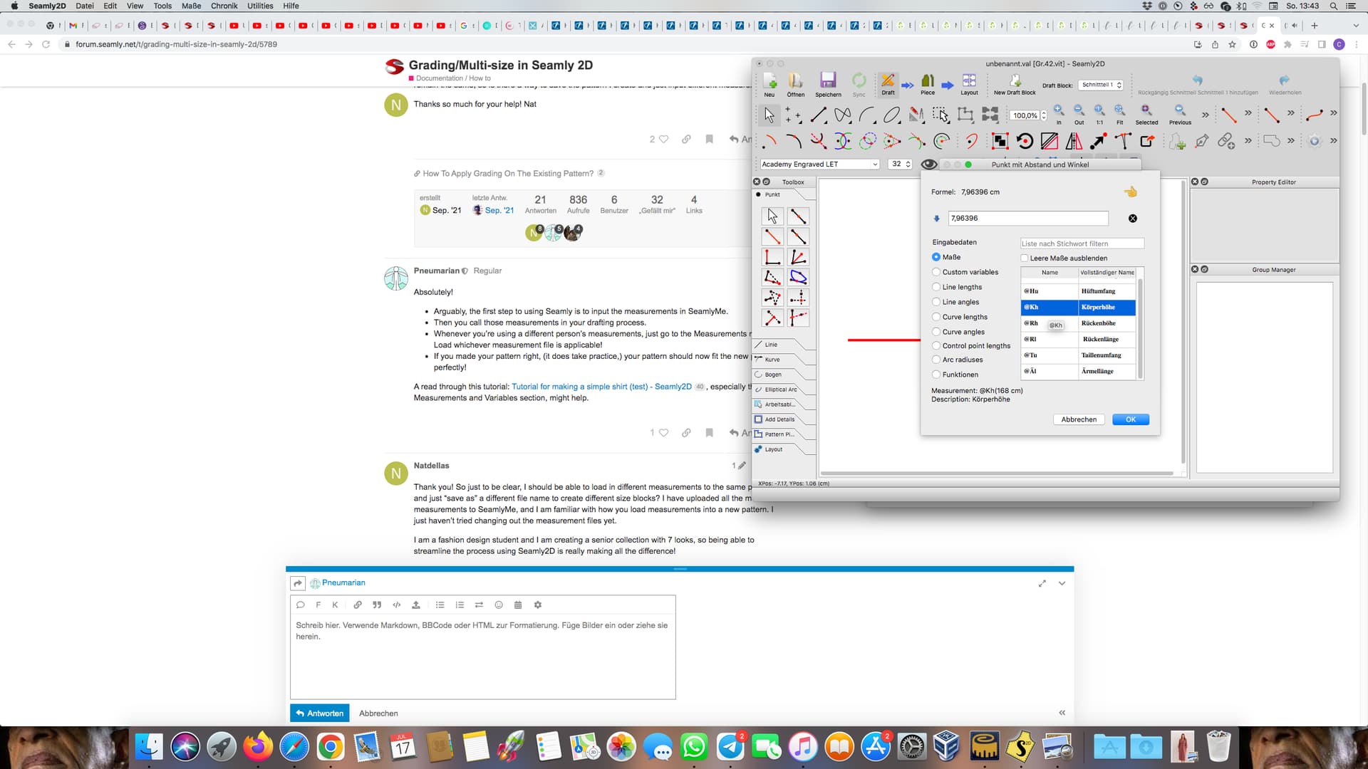

Hello, I have been trying to integrate both individual and multisize file from Seamlyme into Seamly2D, but the measurement I put in doesn’t occur in the “f(x)”- field; below the correct measurement is listed, but not in the f(x) field. Also its always the same value no matter if it is waist or breast etc… I am adding also pics so you can have an idea, what did I do wrong? Thank you

I’m afraid the images are quite a bit blurred when I zoom in to see what’s happening. However, what I can see is that they’re both .vit files, which is an individual measurement file and a multi-size measurement file is .vst.

I suspect that the problem may be in your measurement file (SeamlyME), but I can’t be sure.
You can only load one measurement file at a time, in Seamly2D and the pattern should adjust itself to that measurement file. So if you use the same measurement areas in all of your measurement files, you shouldn’t have a problem.
If you can send me the pattern & measurement files, I can have a look for you - you may send them by personal message, if you wish.
Welcome to Seamly, @Claude!
From my limited angle, it looks like you aren’t double-clicking the formula to enter it in the formula field. It doesn’t automatically enter because you might need multiple formulae. For example, you might want to use @Kh/@Tu as part of a formula for a control line on a curve joining those two areas.
I hope that helps! We’ll be happy to clarify any uncertainty.
