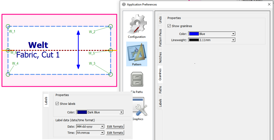

Anyhow… I added the line weight option to the grainlines. The default is set to 0.25 mm, which when scaled by a factor of 3 (which I did to get a wider range of sizes for the grain lines), approx yields the current line width of 3 pixels.
default1
default
and the max of 2.11mm yields this:
max
Also fixed the arrow heads when using “Text as paths” to not have the leader line going through the head(s).
welt2
