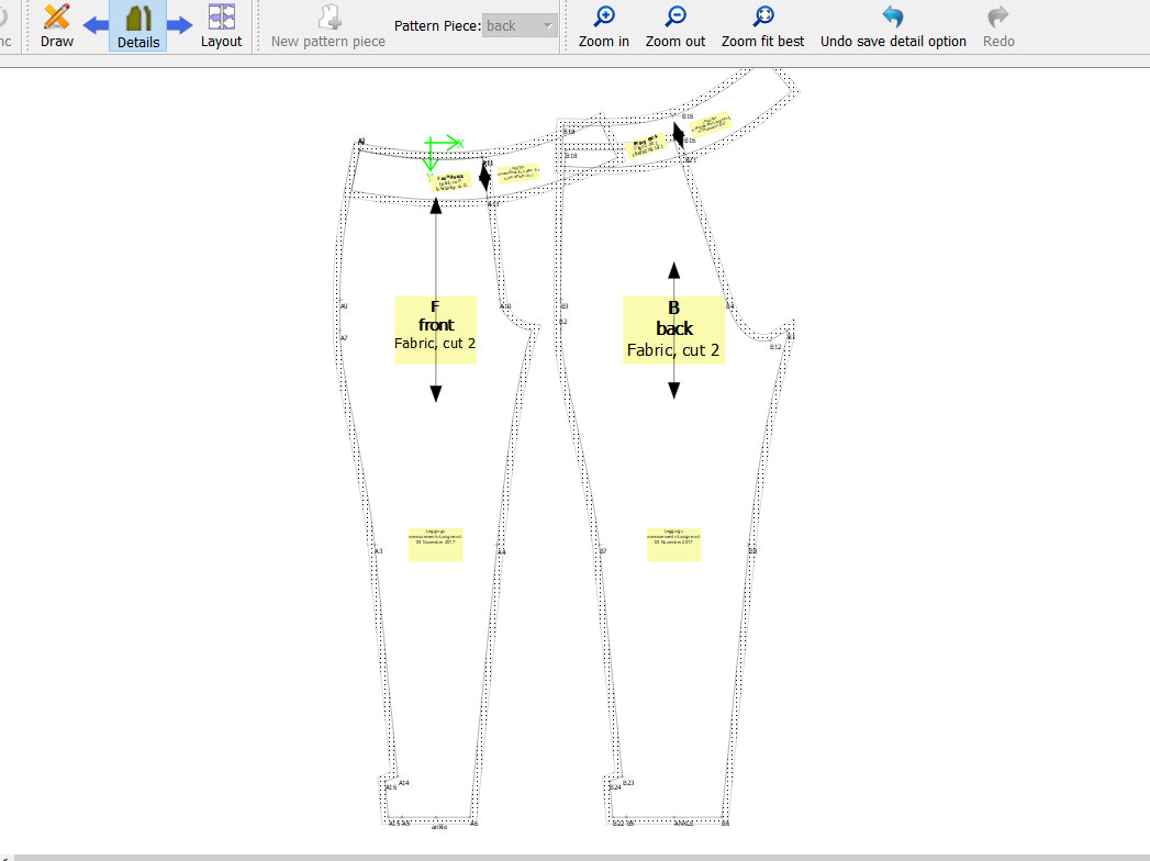

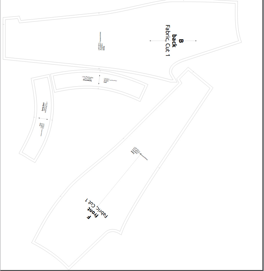

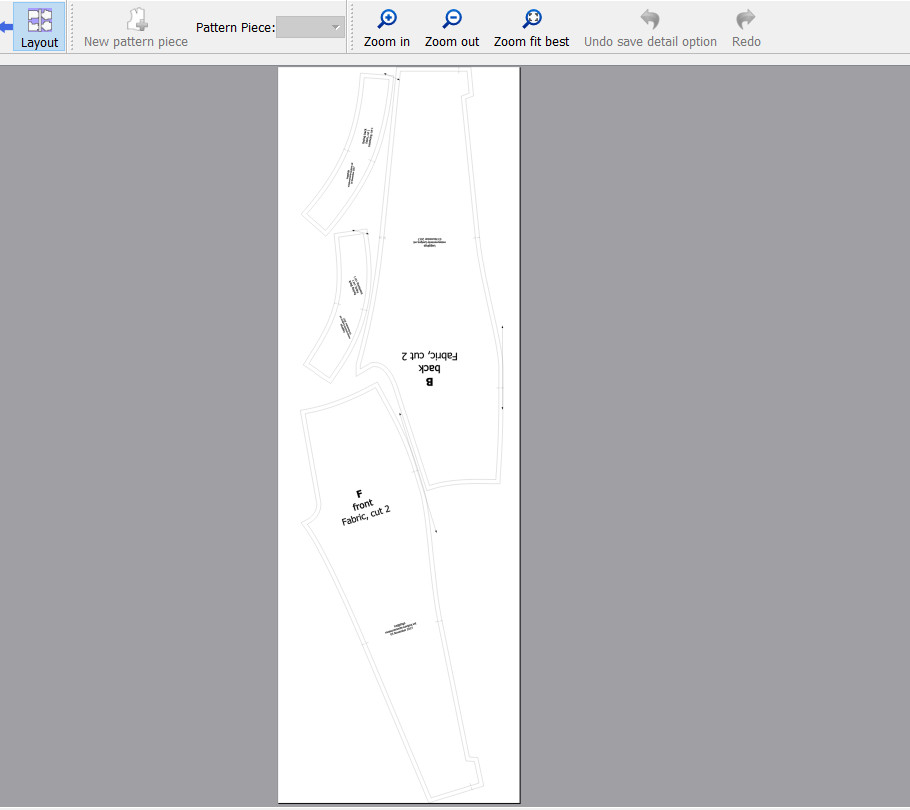

I have put the grainlines, label… in the draft mode. In the layout mode, the grainlines are outside the piece. their rotation is right but it looks like they ignored the pin. Their are at the right place on the draft screen though. I have read a post in the forum saying that it works fine. did I do anything wrong?

I do all that. but the grainlines remain outside the piece at layout.
the pins are the same as for the text.
Your pin points are associated with wrong detail pieces.

I was using 0.5.0.1 and the grainline was a problem.
I was guided to another version 0.6.0.504a and it works fine. all the grainlines are at the right place. thanx to whoever gave me the link to that version. I am a bit lost with all the versions, builts and other stuffs and where to find them.
