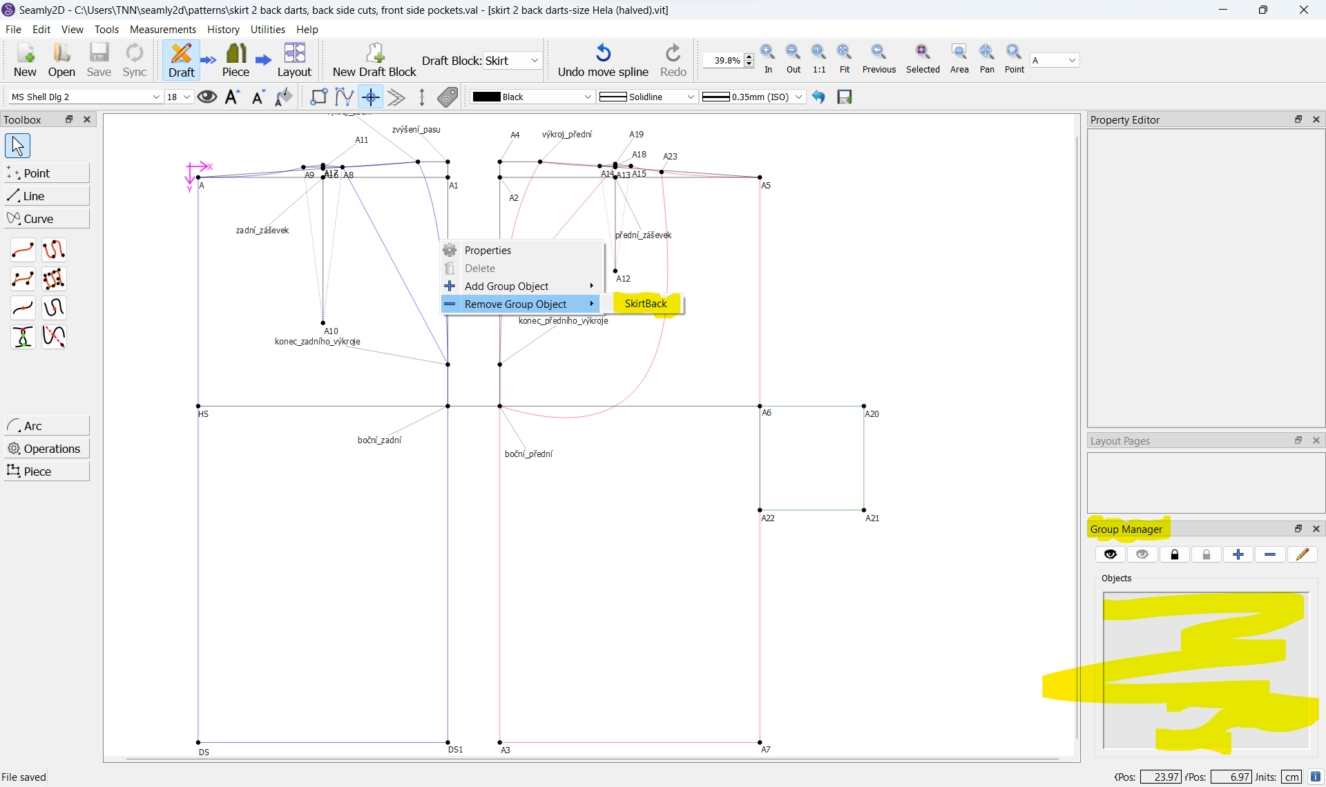

today I’ve opened my Seamly2D and noticed the Group manager being empty even though there certainly are groups in the file. I’ve tried on multiple patterns, the situation is the same everywhere (but the groups are in the file). Could you please help me with fixing that?

Try changing the height of the Group Manager dock… or rearrange the docks. The Groups window is not showing and thus the groups themselves are not showing. The objects only display when a group is selected in the Groups window of the dock.

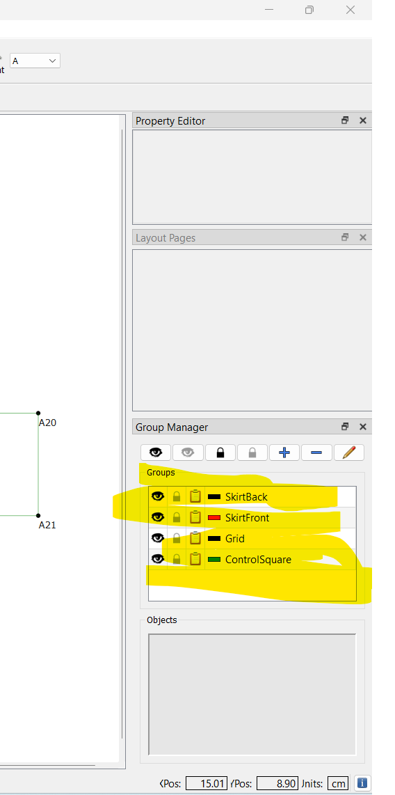

I’m assuming you’ve updated the app recently? … and due to the nature the way the app stores the settings it’s still saving the docks the old way. If you undock and redock the docks you should get something like this - with the docks now tabbed, and the Groups Manager the full height of the dock area. Of cource of you prefer to dock the old way you can still do that, but you might need to chanhe the height of Groups Manage to get the Groups window to show.
groups

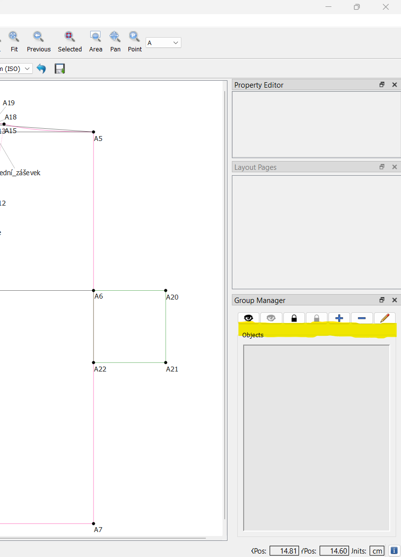

Thanks for the guidance; I’ve tried to undock and re-dock all the small windows on the right side of the app, it didn’t help though. I’ve even tried to uninstall the app altogether and install it anew, no luck either (I didn’t clean the registry though, I am afraid I would break something).

Ok, so… I’ve tried everything you’ve recommended and it didn’t help. But then I noticed a little cursor change above the Objects rectangle and tried to click it, and discovered a HUGE bummer :smiley: The Groups rectangle has just been hidden and this for some reason obviously isn’t something stored in the .ini file. Anyway, my problem is solved and the Group manager works again :slight_smile: Sorry for bothering you with me being silly!
