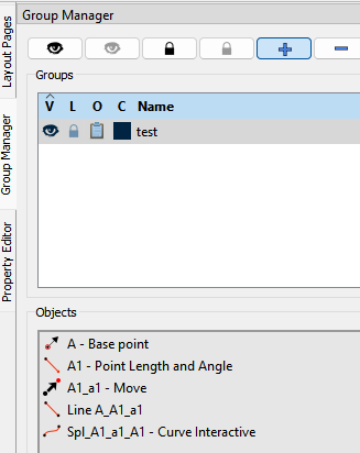

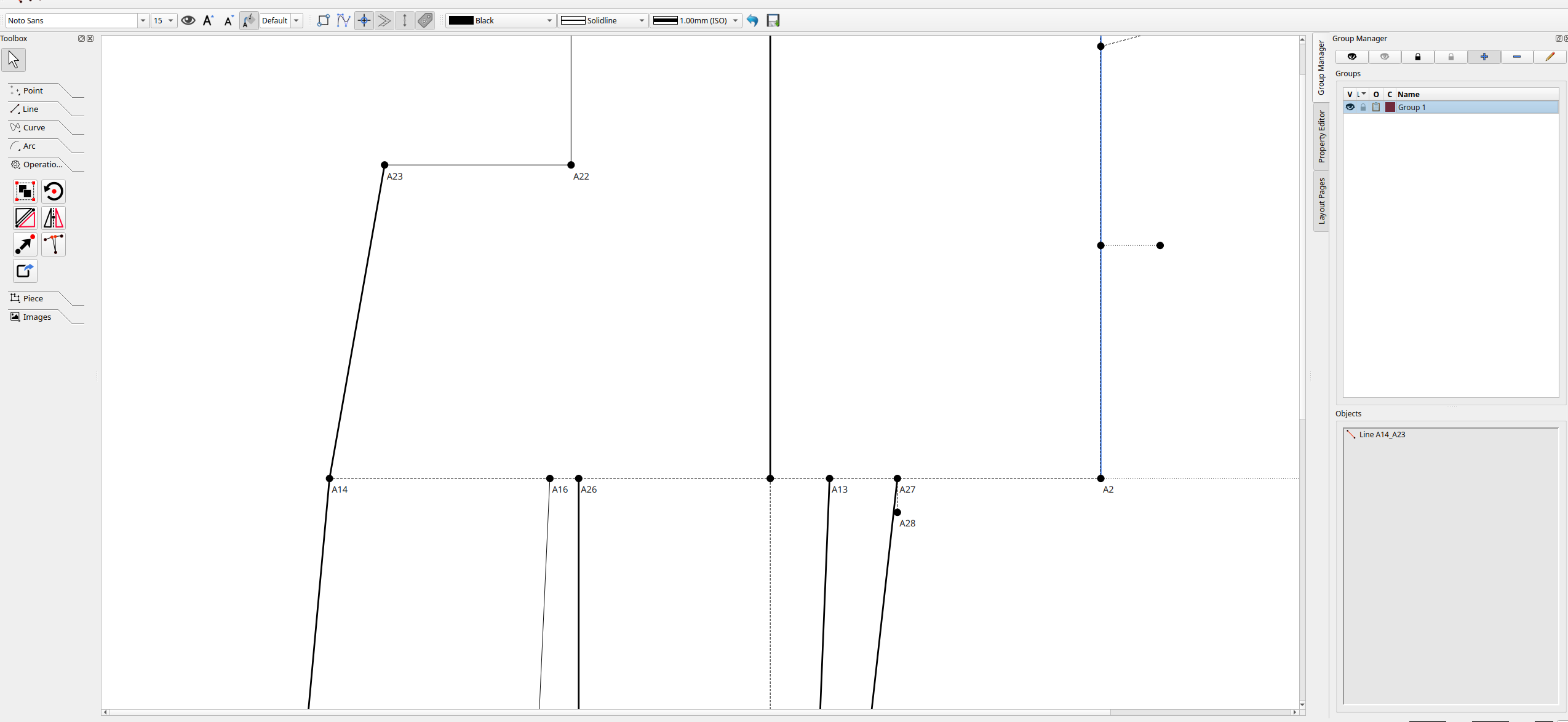

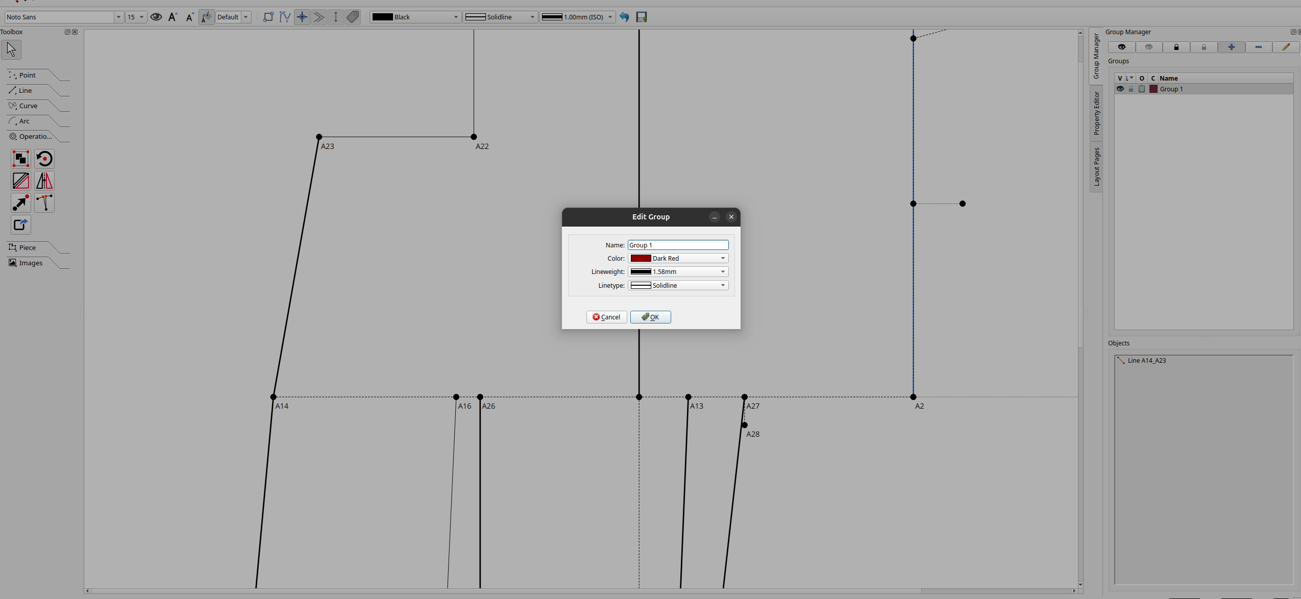

In my environment you can see that I have added a specific color to the group and line weight. The Line_A14_A23 is part of that group but the styling to it is not applied.
Not implemented yet. There is an issue I have to resolve yet in regards to having to maintain the current behavior of objects being able to be in more than 1 group (against my judgement)… like which group’s color to use?

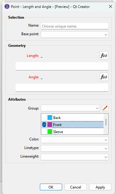

That being said… I’ve pretty much worked out a solution but here’s what I need to do. My orginal 1 group called for this:
Where you could set the group for a tool, and whether to use the group color. But a dropdown will not work for being in multiple groups so that will need to be a table widget . In the table you would be able to check which group color to use. Of course a table widget will eat up more dialog real estate. :roll_eyes:

Because the idea is when you create a new tool, and the dialog pops up you can assign it to groups as you create it, not after the fact.
You already can:
But that misses the point… you want to see ALL the groups a tool is in. By having a table list in the tool dialog you can manage which groups the tool is in and which one is the chosen group color.
