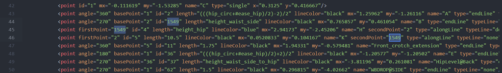

I created a pattern that I really liked, and hoped that if I made a couple of changes to some of the points, I could make it more extensible. So in draw mode I added some points, but noticed that I cannot just simply connect certain lines or objects to these new points (as they will not be shown in the drop down). Possibly because older points cannot be connected to all newer points? So I got to looking in the .val pattern file with a text editor, and I can see that within the tags, every point has an “id” and a corresponding name (example id=“5” name=“existing-point”) as well as any relevant “firstPoint”, “basePoint” etc. And I noticed when I create a new point within Seamly2D, the new point that I create is added to the .val file, and has a much higher “id” (example id=“1549”) and will be placed at the very bottom of the “calculation” points within the tags.
So… I just simply moved that new point up the list (above the object that I want to connect it to) and now it shows up in the dropdown when I am editing the point via the “options” menu.
I got a little carried away and was performing edits directly via the text editor, and at first I had some parsing errors as I didn’t realize the complexity of the hierarchy of points, and the way they were associated with other points (via basePoint, firstPoint etc.). But as I replaced the existing point dependencies the parsing error was resolved and now the pattern file opens right up. And I can make some fairly intricate changes now via the actual code in the file.
So now I am curious if it is okay to leave the new point higher in the list even though the id is also higher (example id=“1549”)? I would assume so, as the id is in fact unique. The program appears to be working just fine.

Sjoe! That’s a major task that you went through :slight_smile: The ID’s are only a name for the different points and it won’t matter where they are in the file.
