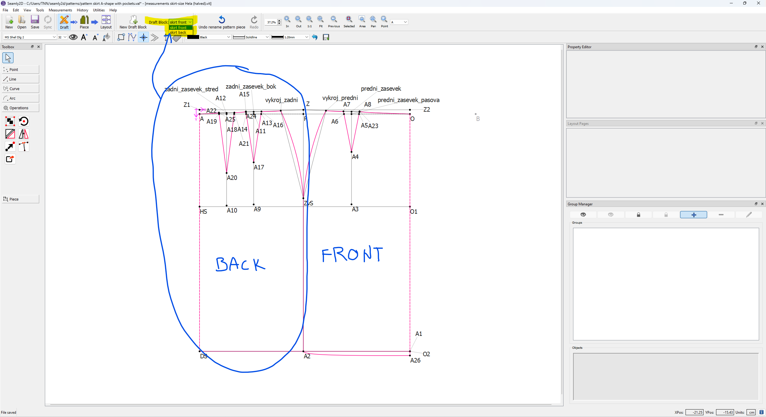

My name is Helena, I live in Czech Republic and I am new to Seamly2D as well as pattern drafting :slight_smile:
I didn’t have much trouble creating my first skirt block; I am starting to have some troubles now, though. Based on a pattern drafting course I’ve recently attended, I’ve drawn both front and back of my skirt to the same draft block. Now I would like to make some design adjustments to the skirt, so I’ve saved the original pattern as a new one and I am proceeding with the new file. For example, I would like to adjust the front part of the skirt by adding side pockets, so I would like to separate the back and front parts to different draft blocks. I would think copying the back part and pasting to the new draft block should work, but I can’t find a way to do that. Is there a way how to do that, please? Or is there another way that would allow me to proceed with my intentions? :slight_smile: I include screenshot for better imagination.

In the open source pattern file, select the block containing the back of the skirt. Right-click on the block and choose “Copy” or use Ctrl+C to copy the block to the clipboard. Create a new rough block where you want to place the back of the skirt. To do this, right-click on an empty area in the editor window and select “Paste” or use the Ctrl+V shortcut. You have now copied the back part into a new draft block. You now have separate draft blocks for the front and back of the skirt. You can edit them independently of each other.
I would put all of the objects on the back skirt, including the shared objects, into a Group and name it “Skirt Back”. And then I’d do the same with the front skirt, naming it “Skirt Front”. Because it’s me, I’d probably also have the whole pattern in a group named “Skirt”. You will need to click on the + to create the groups before you can add items to them.
And then use the Group tool to allocate the objects to each group:
Once you have the objects selected, press Enter and select the group that you would like to add the objects to:
Close the ‘eye’ on the skirt group and the skirt back group and you will only have the objects for the skirt front visible.
(You may want to create another group called “Skirt Front Additions” or something like that to put all the new items into or you can just add them to the “Skirt Front” group.)
Now you can add extra nodes, the pockets, do a rotation or 2 to flare the skirt, add the waist band… Whatever you want. Just don’t change the original draft objects.
Another way would be to use the Move tool to move the front section away from the original drafting and add, rotate, etc. on the moved section.

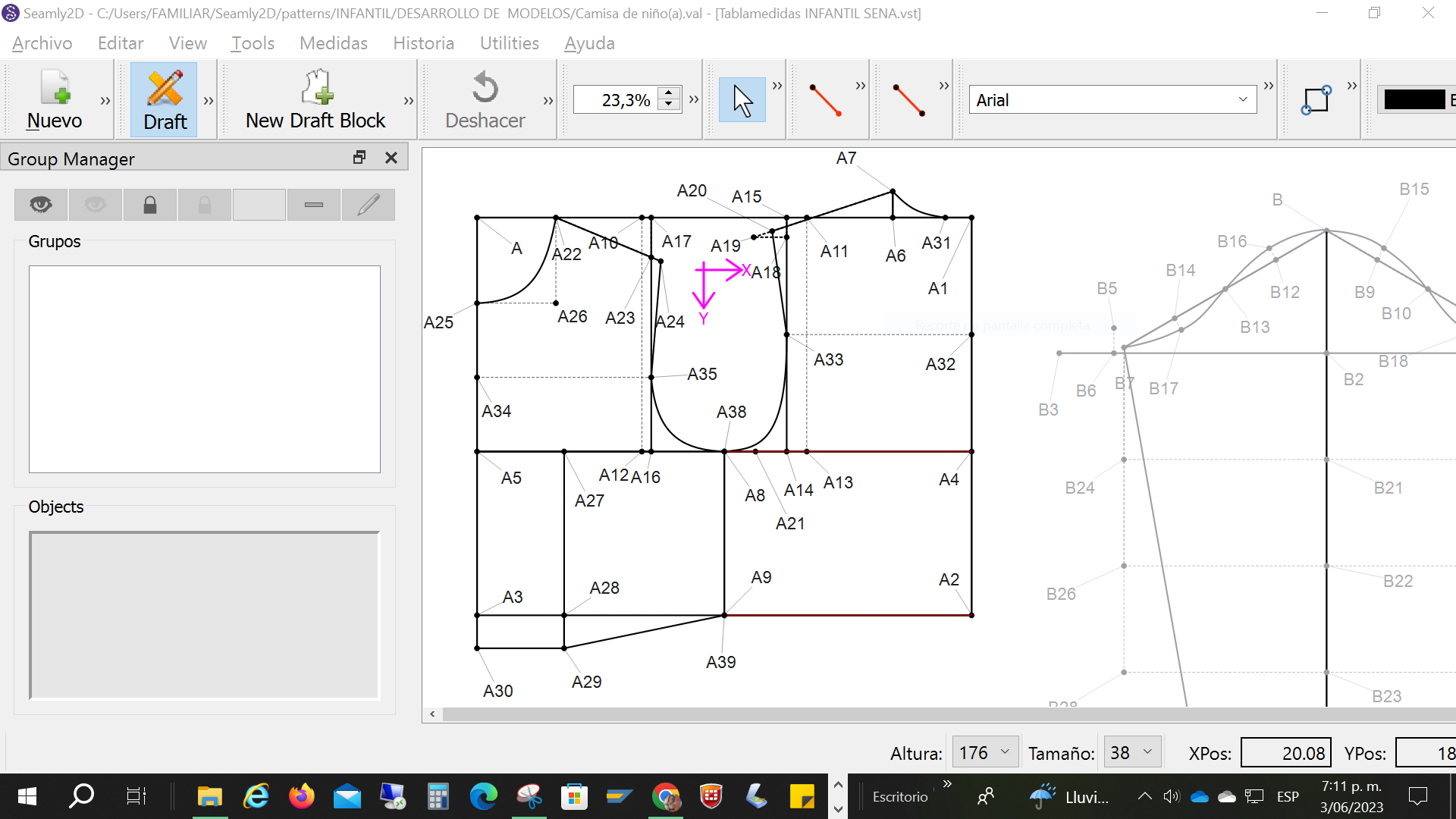

Por el método de grupos, pude dividir un básico de camisa infantil que había hecho en un sólo bloque (delantero y espalda).
Pero ahora cuando dejo sólo abierto el ojo del delantero, para poder hacer un diseño sobre ese básico de camisa, toda modificación que hago se hace automáticamente en la espalda.
Estaré haciendo algo mal? Me faltará hacer algo?
Disculpen la molestia, seguramente será por mí falta de conocimiento, pero si no es así, quedo con la tristeza de pensar que para hacer el desarrollo de un modelo sobre un básico tengo que empezar de ceros. :sob:

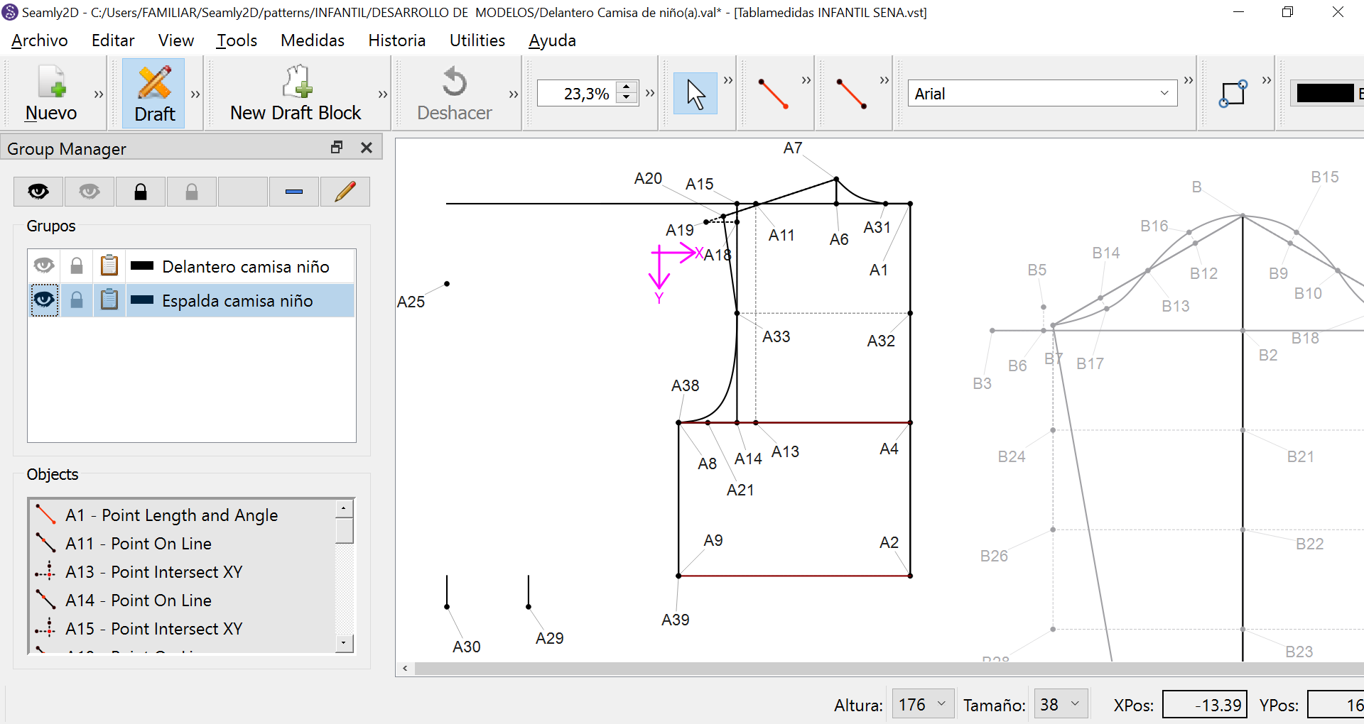

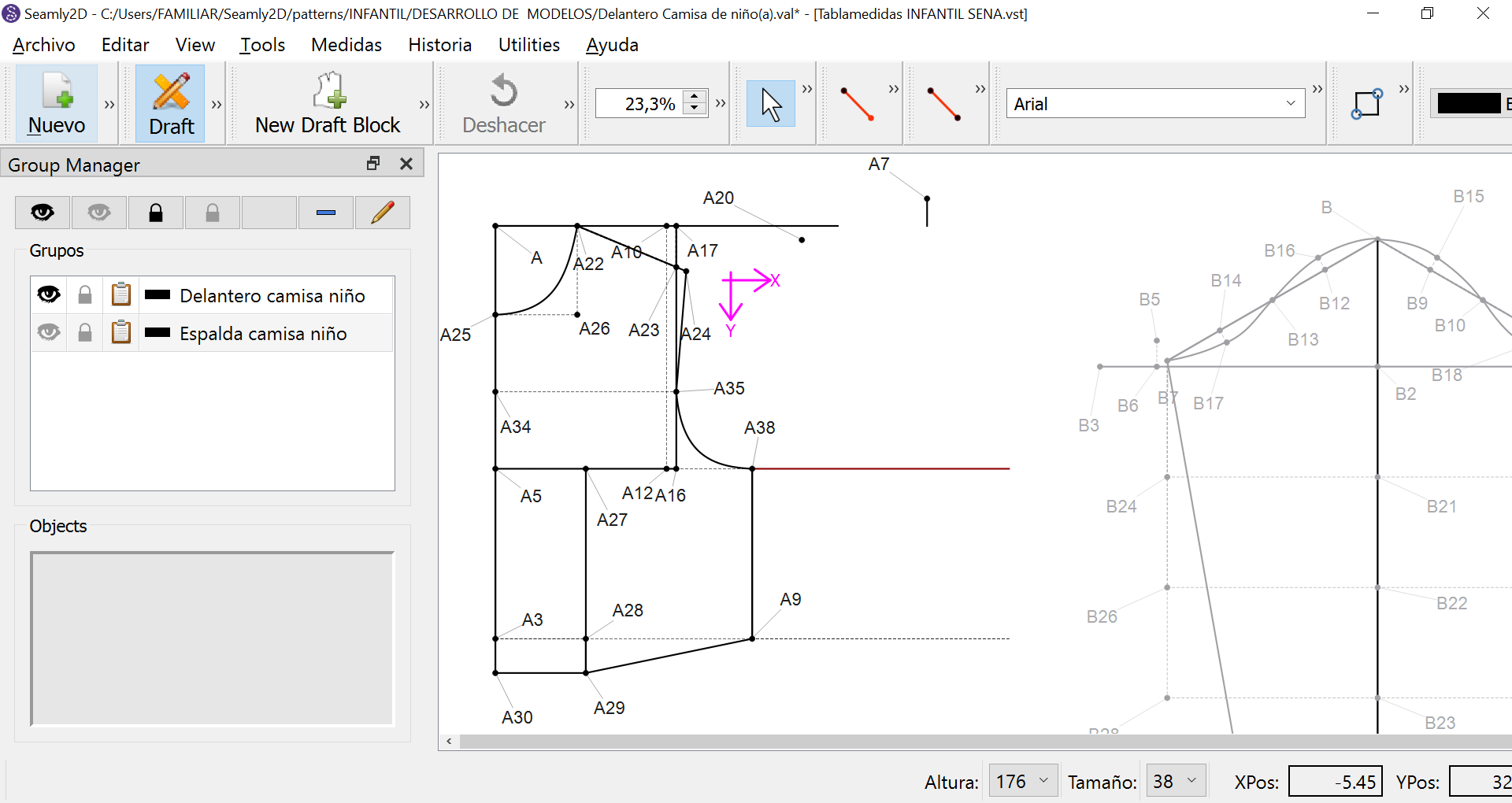

Buenas noches desde Colombia Gracia. El caso no es el que amablemente describes sino el siguiente (copio imágenes para mejor comprensión):
Trazo básico camisa infantil:
Por grupos separé delantero y espalda así:
Entonces cada modificación que hago sea en espalda o en delantero, SEAMLY2D me la lleva también al trazo que no estoy trabajando. Ejemplo: Si le doy holgura de 1.5 cms por costado al delantero, SEAMLY2D me lo lleva a la espalda así:

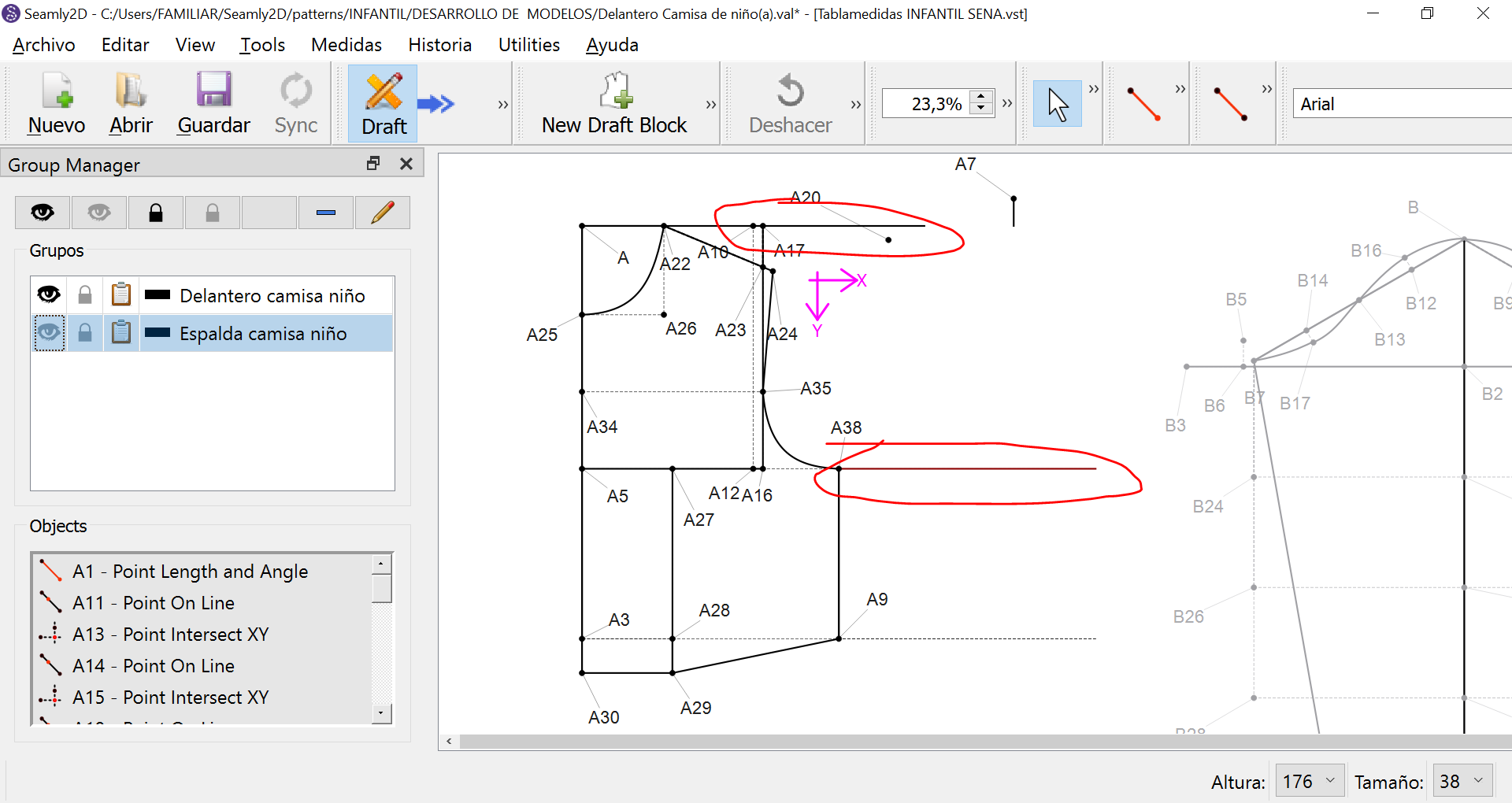

Adicionalmente cuando separo las piezas mediante el método que Gracia gentilmente indicó, quedan líneas que aparentemente no he seleccionado como se ve en la siguiente imagen:
Por favor me guían (es muy probable que sea error mío) o de pronto que lo que pretendo hacer a hoy no sea posible en SEAMLY2D.
Quedo atenta, muchas gracias.
Hola de nuevo, @BibianaDiaz
Si cierra los dos grupos, probablemente verá que la extensión que hizo sigue abierta en la pantalla. Si este es el caso, no ha sido añadida a ningún grupo. Así que si la añades al grupo anterior, no se mostrará en el grupo posterior.
If you close both of the groups, you will probably find that the extension you made is still open on the screen. If this is the case, it hasn’t been added to any group. So if you add it to the front group, it won’t show on the back group.

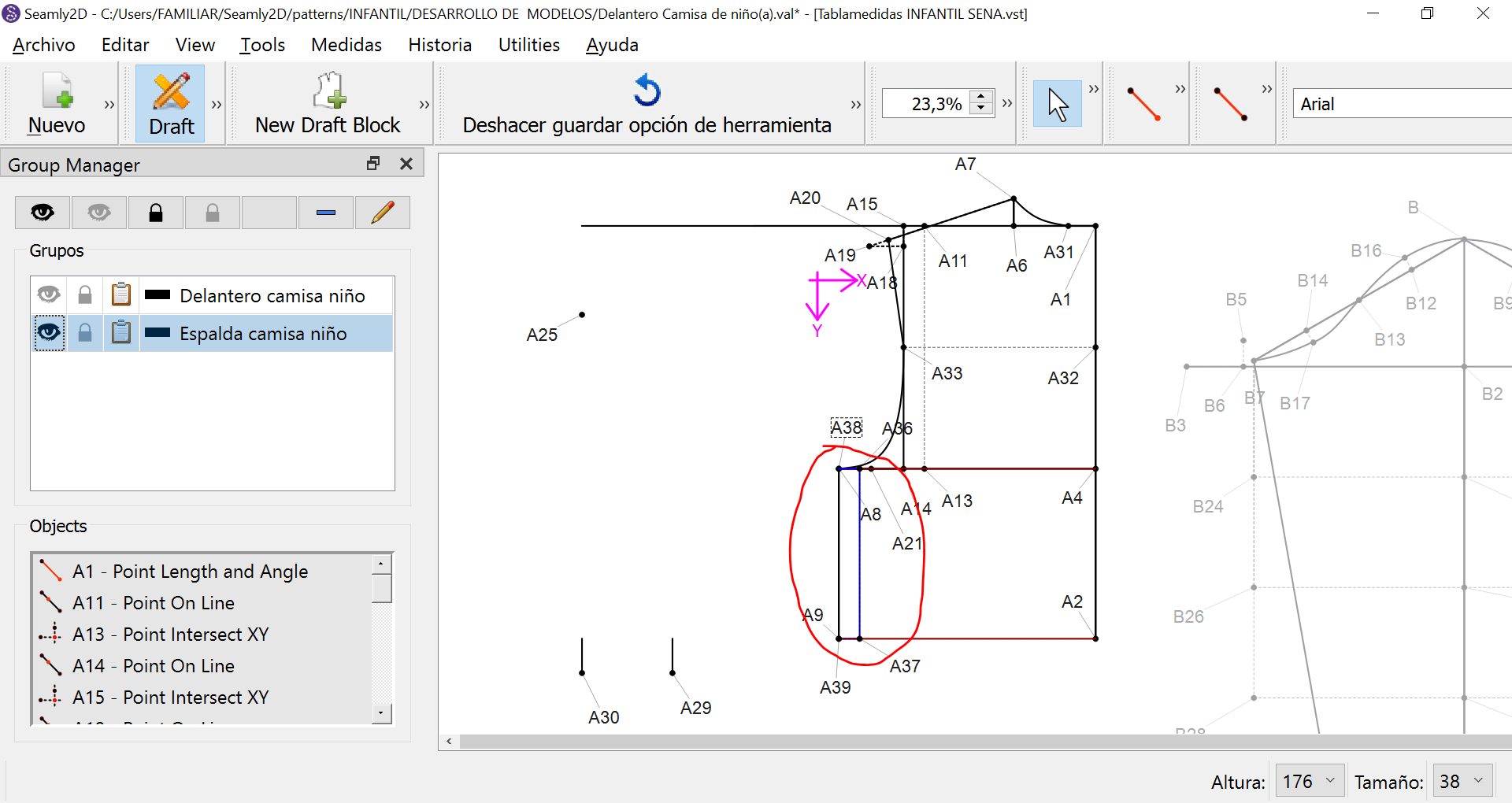

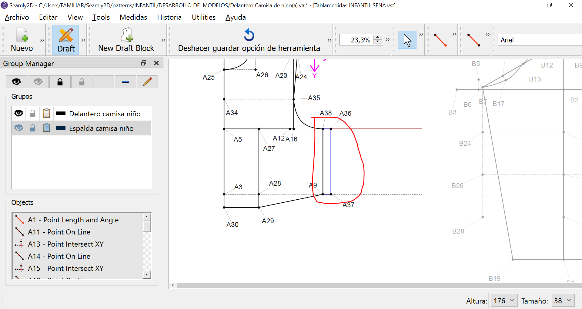

Es un poco complicado dividir los 2 paneles porque tendrás que volver a la Historia justo después de crear A9 y colocar un nodo a una pequeña distancia, y luego cuadrar hasta el nivel de A6 y A, y desde estos puntos crearás el panel trasero. A continuación, tendrá que editar las fórmulas del panel frontal para que se detengan en los nodos existentes y no continúen en el panel posterior.
It is a bit complicated to split the 2 panels because you will need to go back into the History to just after you created A9 and place a node at a small distance, and then square up to the level of A6 and A, and from these points you will then create the back panel. Then you will need to edit the formulas to the front panel to stop at the exist nodes and not to continue on into the back panel.
