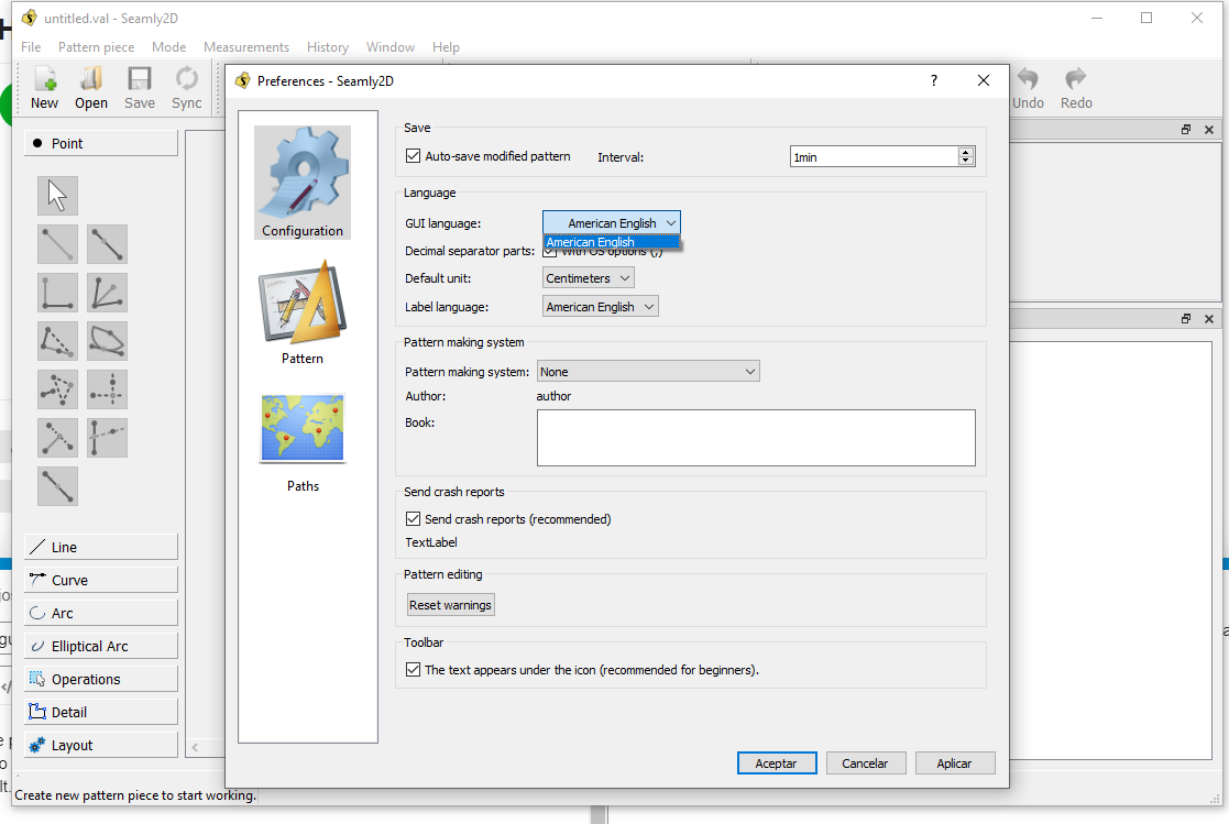

in the new version of the program’s installer It no longer allows you to choose the language, so there are no longer any languages ​​installed, it only leaves English by default.
Someone pass me the old version please.
I need to change it to Spanish
ayuda por favor.

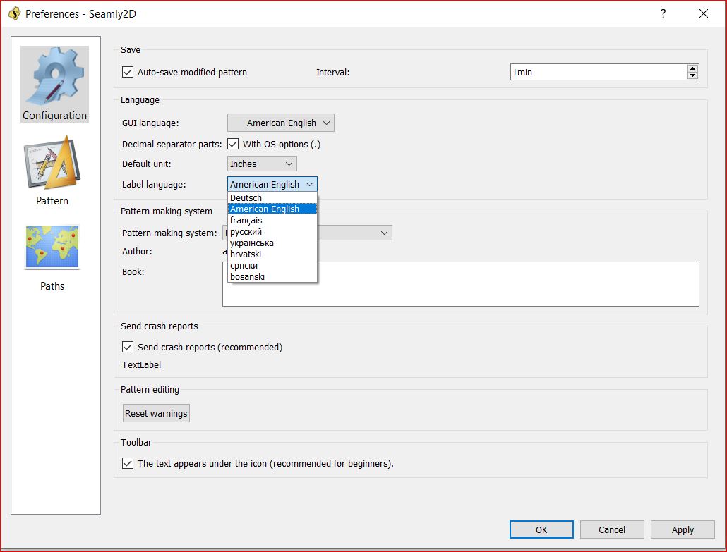

Hi @jjjjose. Reprodudé este problema. En “Archivo/Preferencias/Configurar/Idioma de etiqueta” solo estaba disponible en la lista desplegable “Inglés americano”.Cuando lo intenté de nuevo, aparecieron varios idiomas. ¿Podrías intentarlo de nuevo?
I replicated this problem. In “File/Preferences/Configure/Label Language” only “American English” was available in the dropdown list. When I tried it again, multiple languages appeared. Would you try it again?

I’m still seeing the full list. Though since this isn’t a fresh install the old translations could still be floating around wherever they hang out. I’m not sure how to tell if they aren’t getting installed somehow, but the translation files appear to be in the recent .tar.gz source as well.
