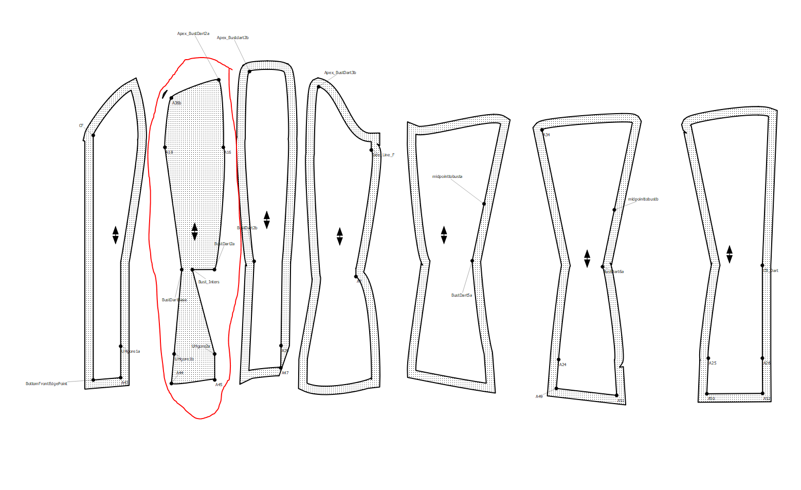

First time using Seamly, so I apologise if this a really silly newbie mistake. But I have one piece out of seven that just doesn’t want to behave like the others. When I turn it into a piece, it is all seam allowance and no white space like the others. What am I doing wrong?

There’s probably an issue with the main path… a missing node, or a node out of order… possibly in some edge cases just changing the starting point fixes the problem.
If you post the pattern and any measurement files, one of us here can take a look and fix it.
