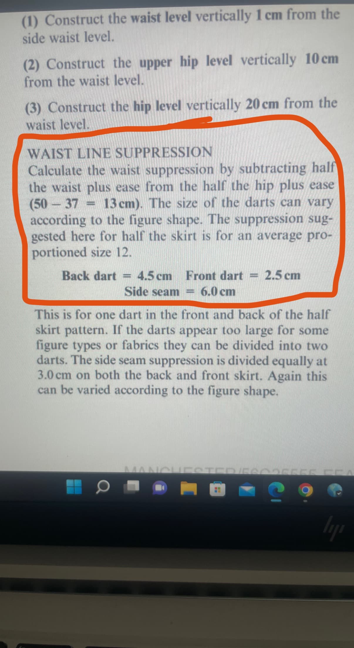

How can I add the equation of the step attached below.I need only half 6 which is 3 to develop the needed point Thanks
Assuming you have created a measurement file (.vit) and have added sone measurements like waist (waist_circ?) and hip (hip_circ?) measurements… I would also add a custom measurement named “ease”.
Given a total ease of 2 inches or approx 5cm… and given when you draft you’re only doing 1 / 2 the pattern so everything is divided by 2…
((hip_circ + @ease) / 2 ) - ((waist_ circ + @ease) / 2)
What I normally do is create custom 1/2 measurements for things like chest, waist , and hips… for ex: in SeamlyMe I would define @waist as waist_circ / 2. It now simplifies the formulas so the above would become :
(@hips + @ease) - (@waist + @ease).
You could go a step further and create custom measurements with “ease”… so defining 1/2 measurements @waist_ with_ease and @hip_with_ ease the formulas get even simpler:
@hip_with_ease - @waist_with_ ease.
This way you never have to change all the forumlas… just edit the measurements and ease. Don’t want any ease just set it to zero.
Hope this helps… I’m sure some others might have some ideas too.

Basically, this is what you need to do… You add darts in strategic places to bring the fabric width down from the hip+ease measurement to fit the waist+ease.
