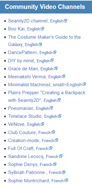

There are a whole lot of videos links listed in the Wiki
And here You can download a handy tool reference sheet & see some other videos Spanish :slight_smile:
I see that pixel y punto has a whole series of videos. It looks really good :slight_smile:

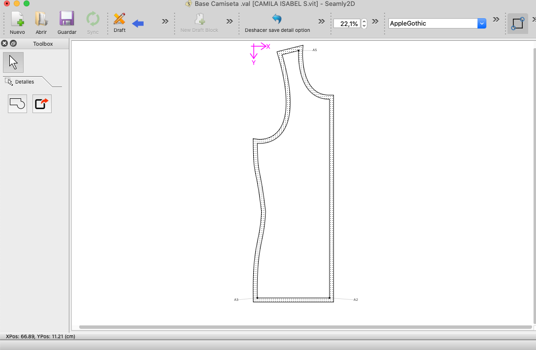

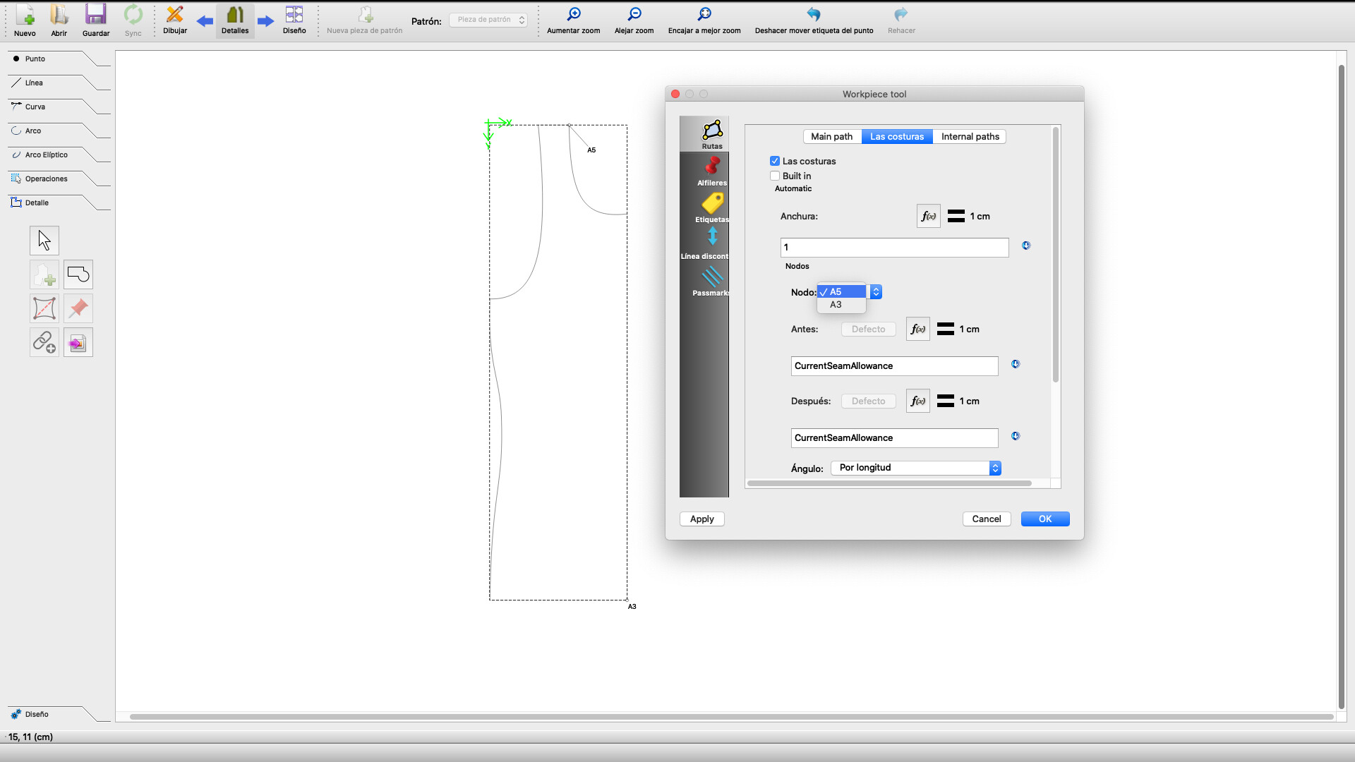

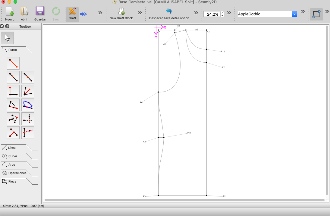

Hola @Malicat , mi dificultad es para agregar las costuras adecuadamente, hice una figura sencilla como para una camiseta y le debo eliminar las costuras en cuello y sisa, pero en el menu de las costuras solo me aparecen dos nodos :upside_down_face:

Hi @Douglas I hope to learn soon, for now I’m just creating simple shapes, but I’m having trouble adding the seams correctly, the system doesn’t recognize some control points on the curves :woman_facepalming:

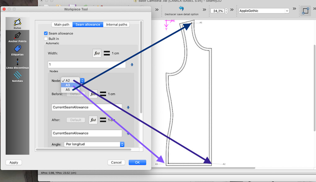

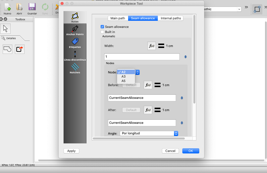

Select the node before the curve and change the After width to 0:
And then select the node after the curve and change the Before width to 0:
If you have any nodes on the curve then you will need to change both the before & after widths to 0:
And this is the result:

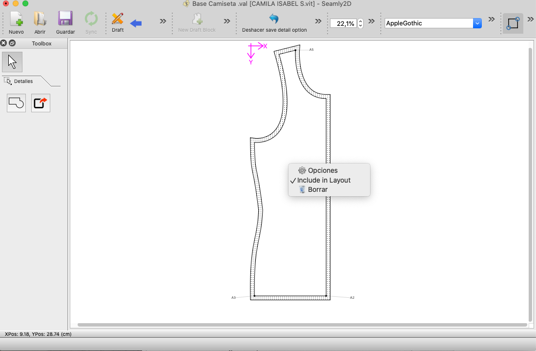

Thank you very much for your answer, I tried it and it didn’t work for me, notice that in the drawing all the points are visible

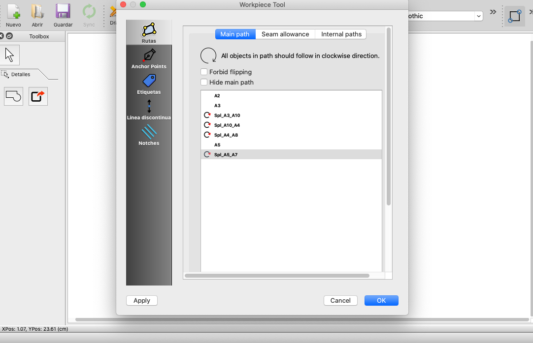

but then when I take it to the piece area the control points are not visible, and not only are they not visible, I can’t take them

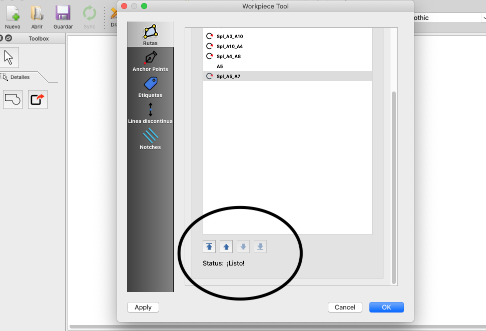

I try to go to the options and the route of the perfect points is seen, but I have no way to make it appear in the pattern I hope you understand me @Grace , I really appreciate the time you take to answer
Si, lo visualizo como vector por eso es que le digo nodo, pero realmente verlo como puntos ayuda mejor a entender la construcción del patron, he intentado eso de insertar los nodos como me comentas, solo por curiosidad pero no hace nada, seguro cuando tenga mas practica entiendo como utilizarla

Only the points added as nodes that define the outline of a pattern piece are visible in Piece Mode. As it stands to reason. You can make an unlimited number of pieces from a draft block all based on which point or curves you add to a piece.
For example it’s a common practice to draft the upper and lower sleeve parts as one block… but then by selecting the appropriate points and curves you create separate upper and lower sleeve pattern pieces.
Are you saying you can’t select the nodes in the drop down list with the mouse? If this is the case it’s been reported before there seems to be (Qt?) issues with some aspects and the Mac Os. You can try using the up and down arrows and then press Enter.
@Douglas ,Are you talking about these arrows?
I use the arrow on the point I want to select and nothing happens the same selected nodes remain
