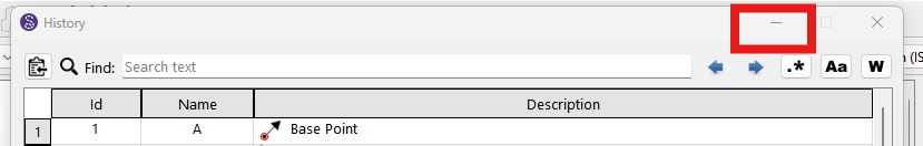

The History window is non modal - which means it can stay open while you still work on the pattern. Because It’s non modal it has the “minimize” button. At least on Windows. It will shrink down on the status bar. Clicking the maximize button opens it up again.

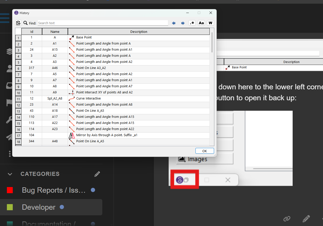

my history window still disappears if i forget to close it and zoom in or out and then i can’t figure out how to get it back. i have to close out and open back up.
The History is a non modal window… meaning it can stay open while you work, as well as being able to minimize:
Which sends it down here to the lower left corner… just click the maximize button to open it back up:
And the fact that the History is non modal you can just keep it open and move it to a second monitor if you have one… which I couldn’t live with out now.
i’m on a mac and don’t see that on the bottom left.
